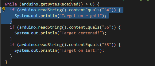

This is the piece of code that i’m having trouble with:
The problem is when the statement is true, only the top if statement would work. even if “35” and"36" is the contents of the serial port (arduino), nothing would print. only “Target on right” if that statement is true.

I expect readString() to read the next string from the serial port. What happens if you store it in a local variable like this?
while (arduino.getBytesReceived() > 0) {
  String message = arduino.readString();
  if (message.equals("35") {
    System.out.println("Target on right!");
  // etc
Your a GOD! Thank you soooo much!
