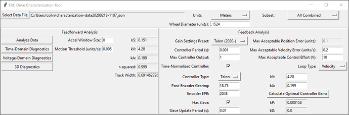

Characterization tool screenshot:

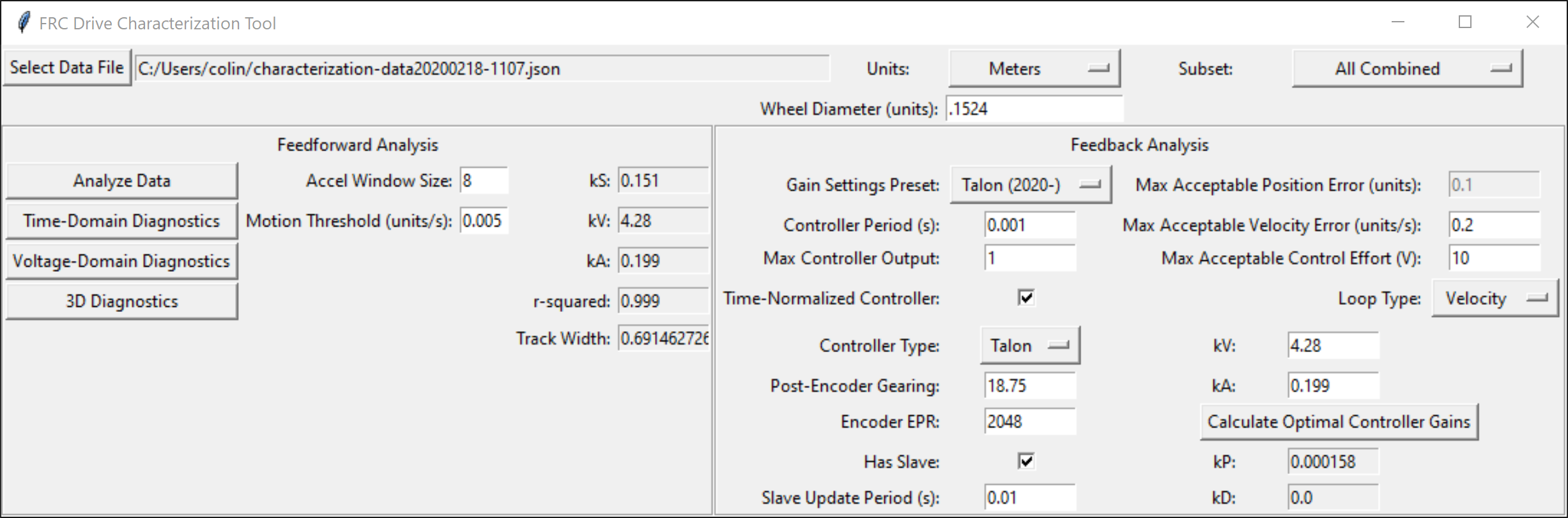

Data analyzer -

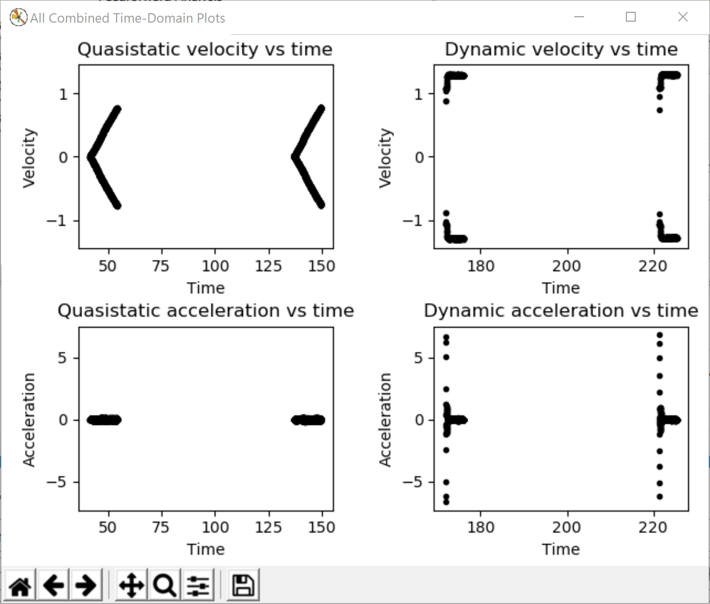

Time-Domain plots -

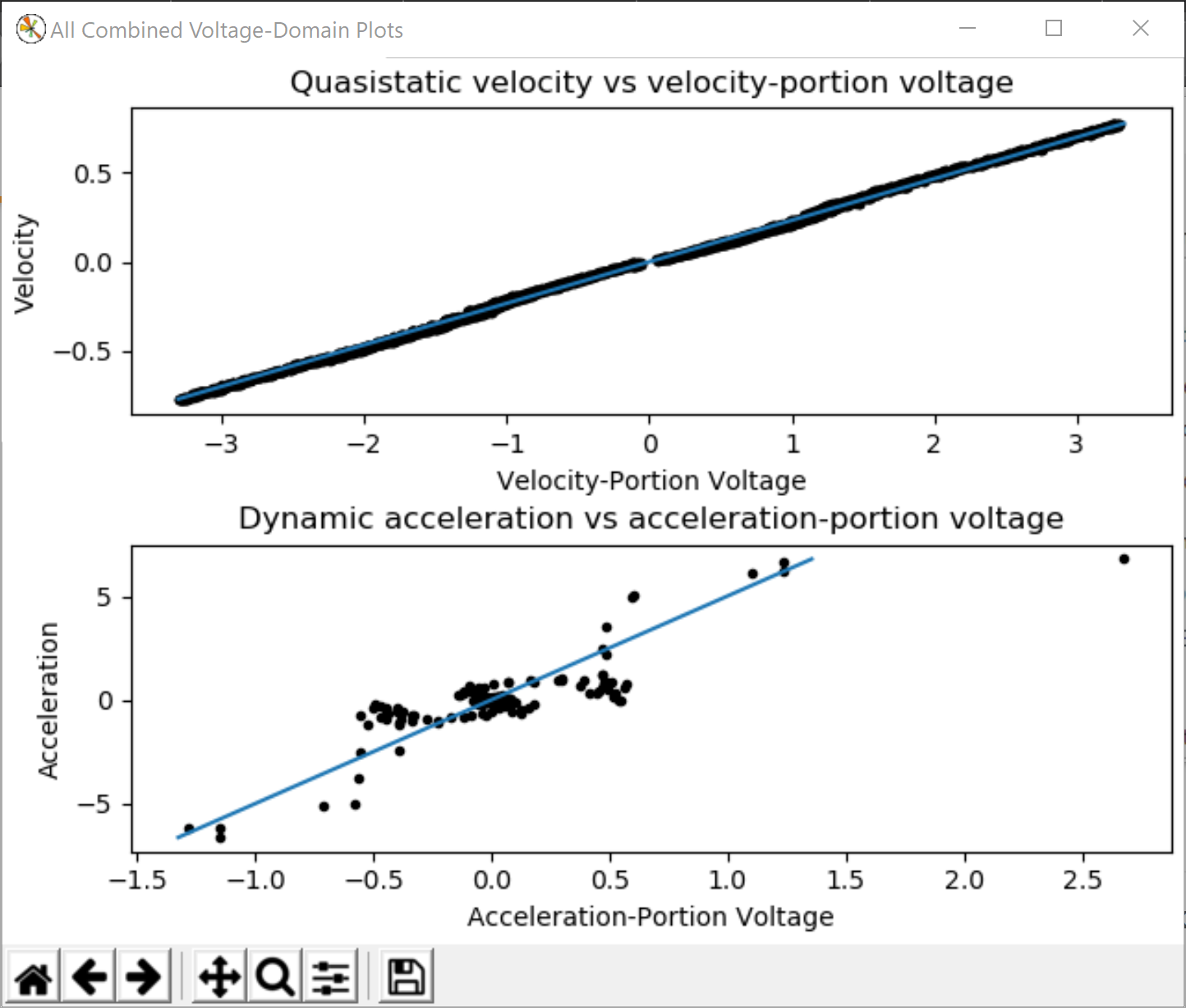

Voltage-Domain plots -
