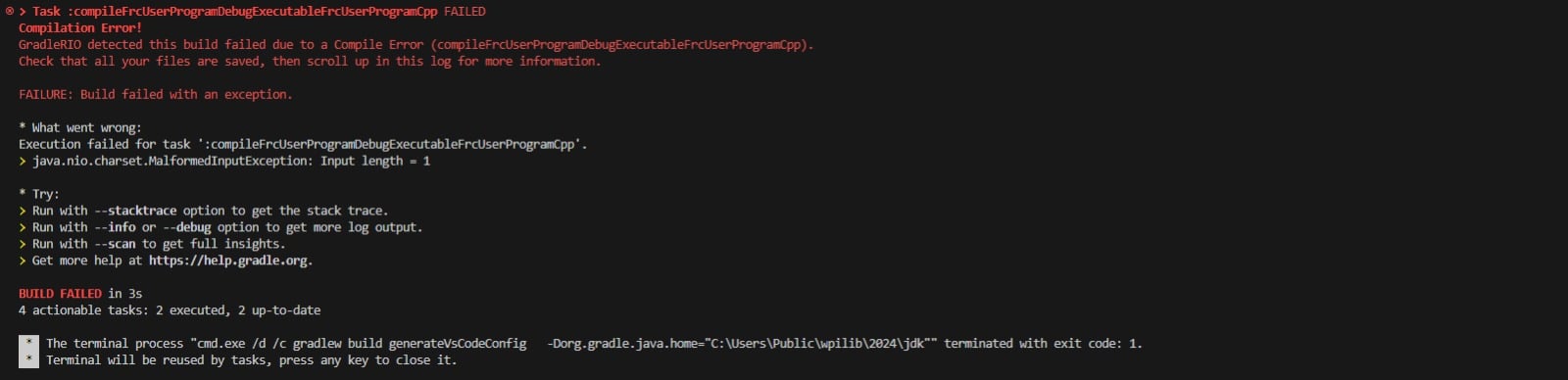

We’re having problems when trying to use the CTRE libraries with WPILib 2024. When we try to build our code without the CTRE libraries it works but when we try to use it, this message appears:
The message doesn’t explain if the problem is the library but it only appears when we install it. We don’t have knowledge about gradle so we would aprreciate if someone explain it!

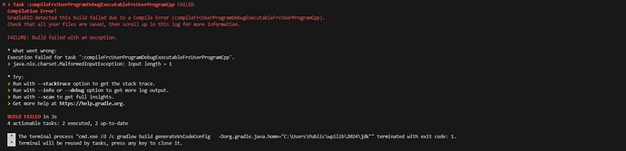

Here’s the error:
Scroll up. Theres almost certainly more to the message
There’s nothing more… It’s the only message that appears.

The error is here in the log:
2024-01-12T15:38:27.400-0800 [ERROR] [org.gradle.internal.operations.logging.DefaultBuildOperationLoggerFactory] C:\Users\Public\Documents\ProgramaþÒo Crescendo V1\ProgramaþÒo Crescendo V1\src\main\cpp\Robot.cpp:14:10: fatal error: ctre/phoenix/motorcontrol/can/WPI_VictorSPX.h: No such file or directory
   14 | #include <ctre/phoenix/motorcontrol/can/WPI_VictorSPX.h>
compilation terminated.
The reason you’re not getting useful error information from Gradle is because of the special characters in the path, which apparently aren’t output in UTF-8 and thus Java can’t parse it back in to output it. If you rename the folders that should fix Gradle outputting errors correctly.
The underlying problem is that it’s not finding the CTRE headers. Have you installed the CTRE 2024 vendor dep JSON in your project?
