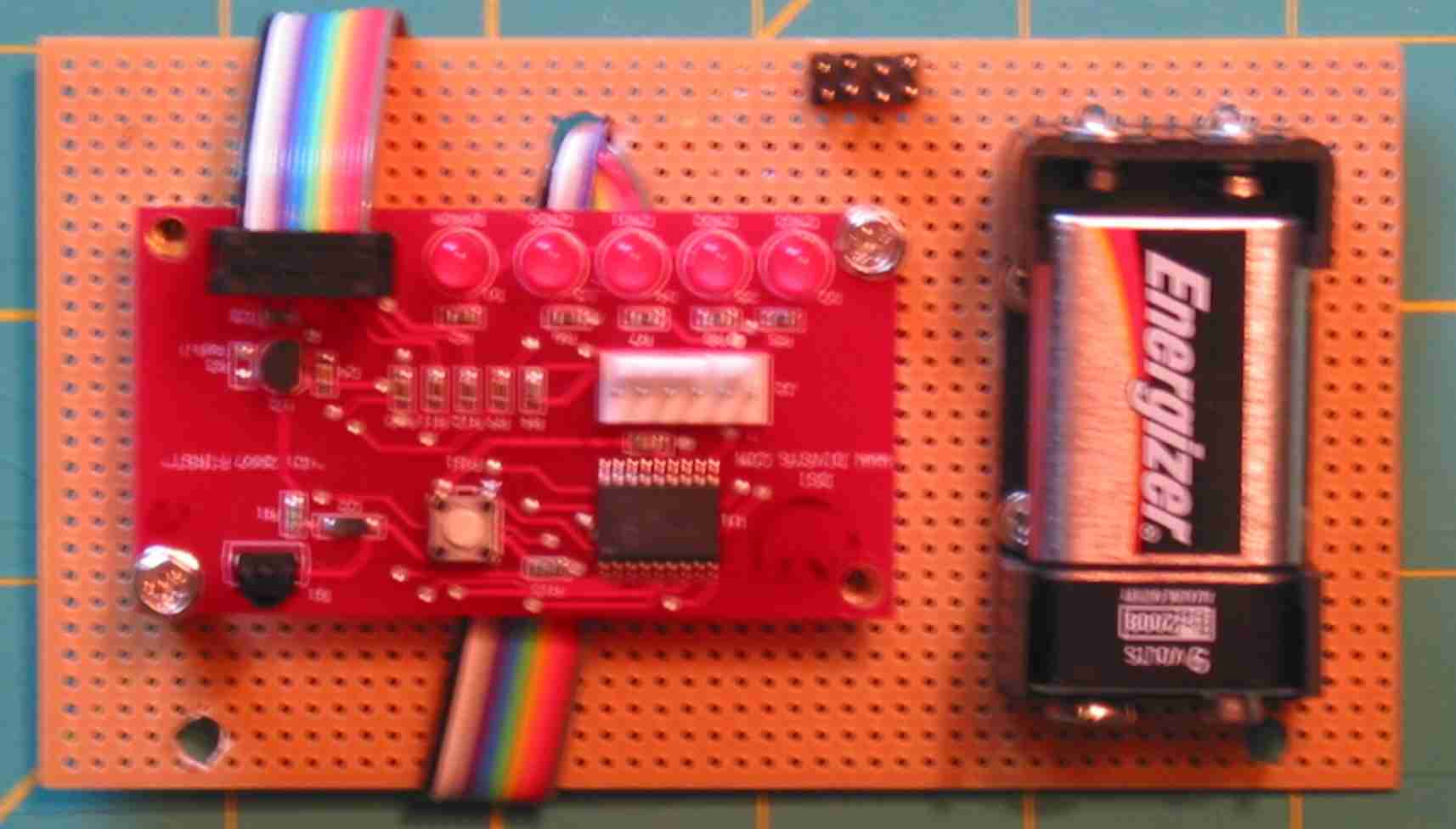

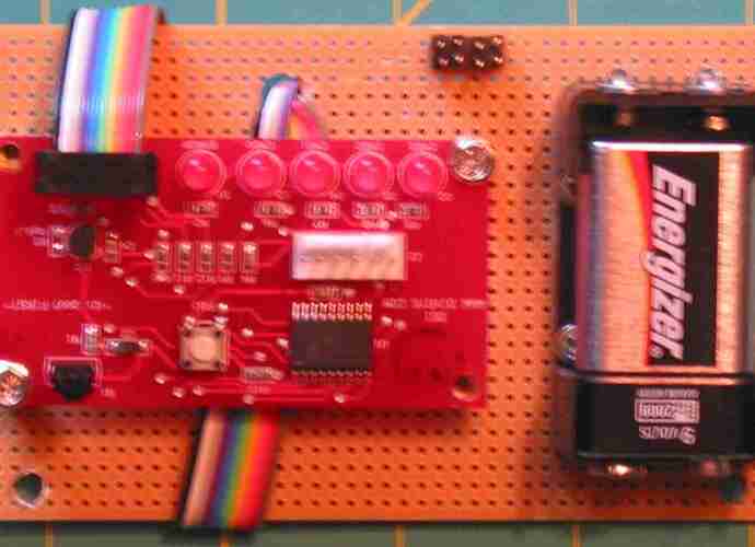

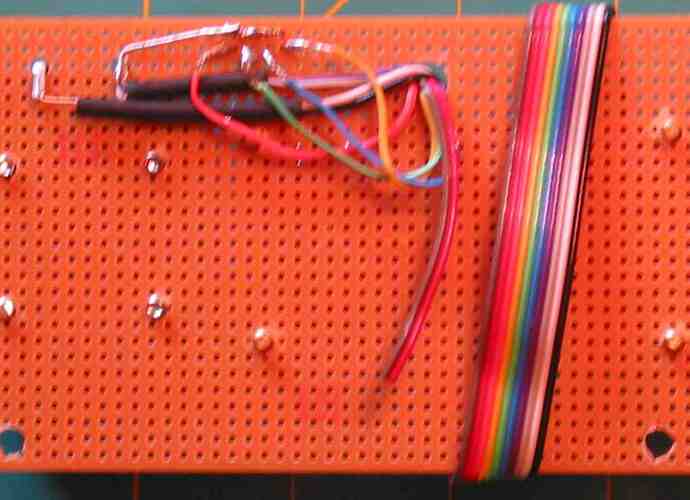

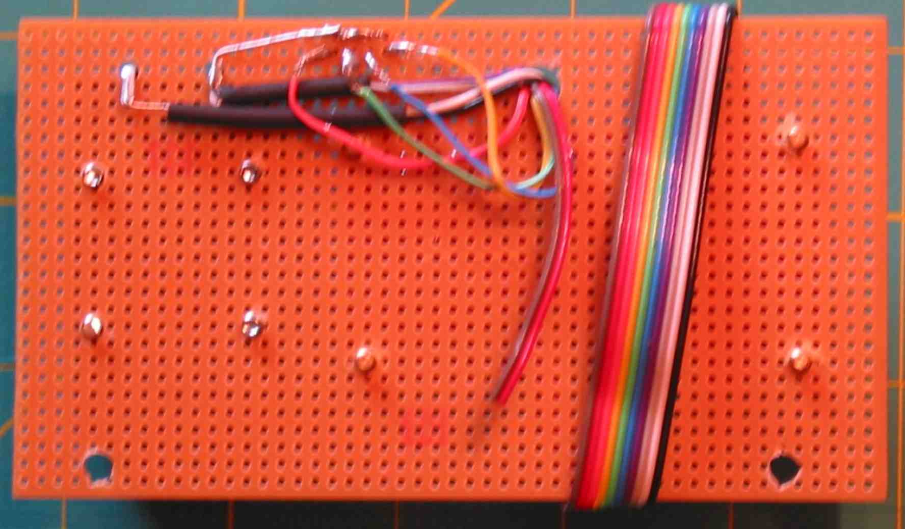

Here what I did so we could test the board without handling it directly when testing it.
The Top Side pic shows the battery reversed (a convenient way to store it). The 2 pin headers on the test board was all I had at the time, 3 pin headers would be better.
The Bot Side pic shows that I connected the Blk/Wht to the positive side of the 9 volt battery and the gray/purp wire to the negative side.
With my ribbon cable:
orn is pin 8, CMD0
grn is pin 6, CMD1
blu is pin 5, CMD2
yel is pin 3, CMD3
brn/red is not connected.
Good Luck!
So is the pic you show, the right way to connect the rainbow wires
I believe it is.
But do yourself a favor and use an ohm meter or a continuity tester and identify Pin 1 and 2 - they go to the plus side of the battery no matter what color the wire is. Pin 3 and 4 go to the negative side again no matter what color the wires are. Then Pin 8 for CMD0, Pin6 for CMD1, Pin5 for CMD2, and Pin7 for CMD3 no matter what colors they are. See the Document that FIRST supplied.
Does you cable look like mine, oriented the way it is in the picture? If so than the colors scheme I described should match.
