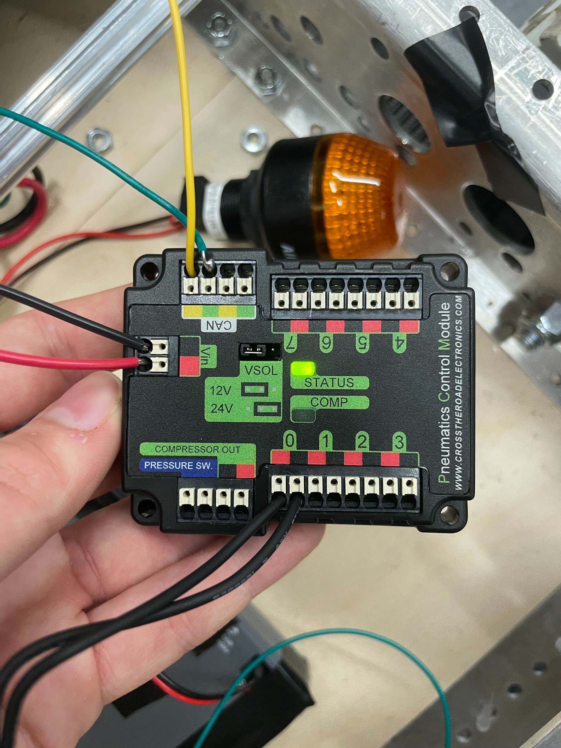

Recently we have been working on pneumatics, and unfortunately we are having trouble getting our solenoids to work. When it is activated with the controller, our CTRE PCM lights up beneath the port where the solenoid is connected, and the solenoid makes a clicking sound, however the air does not switch sides. We made sure the voltage is right by switching the jumper on the PCM (we are using a 12v solenoid, also we tried switching to 24v and tried with a 24v solenoid, but it didn’t work as well). We also tried updating the firmware of the PCM as frczero.org says to do in the pneumatics troubleshooting section. Any tips or suggestions on how to get it working? Seems weird that two different solenoids would be broken.

Sounds like you have done most things right.
Can you share a picture of the setup?
What input pressure are you providing to the solenoid? Are they single or double solenoids?

Photo of the setup attached, using a single solenoid and supplying 30 psi when trying to activate it. Also this morning we tried using a new PCM, and it didn’t work as well :smiling_face_with_tear:
That solenoid valve is a 24V model, but your PCM is set to 12V. Change the jumper in the middle to 24V
Edit: I’m dumb and can’t read… nvm
Your photos show 12VDC solenoid and 12V PCM so that should be okay.
Not sure what you meant when you say a couple of times “didn’t work as well” since most of these states are either working or not working with little “sort of working” possible.
There may be a problem with your CAN topology but if the lights on the PCM change as expected then that’s not an issue for this testing.
If you’ve tried multiple PCMs and multiple solenoid valves it’s unlikely but still possible multiple components have failed.

I would screw the snubber on the R port all the way out. Try pressing the manual button on the valve body. Some valves let you lock the manual button on. Been there done that If the led under the port turns on when the soleniod is “energized” then the software and can is working
Okay so we ended getting it up working. Kind of an embarrassing mistake—we never bothered to actually hook the solenoid up to the piston, and when we did it immediately started working :melting_face:
