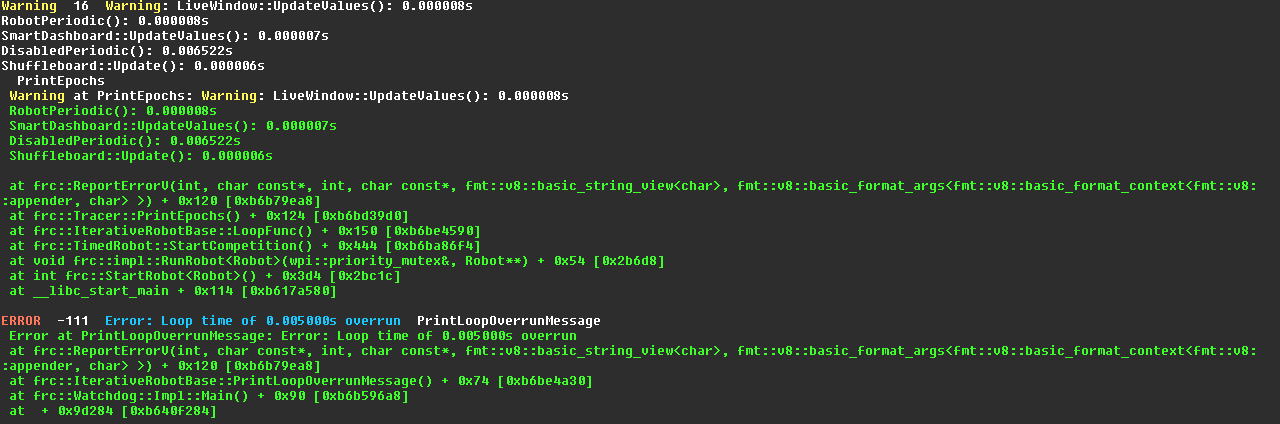

I installed the most recent build of SysID from here I am no longer getting the issue with the Talons and now am getting this error
ERROR  -111  Error: Loop time of 0.005000s overrun  PrintLoopOverrunMessage
here is the console output if useful
That typically happens a few times at robot startup as all of the vendor libs sort themselves out (the CTRE lib in particular is highly multithreaded). If there are no other symptoms then it’s nothing to worry about.
