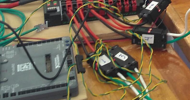

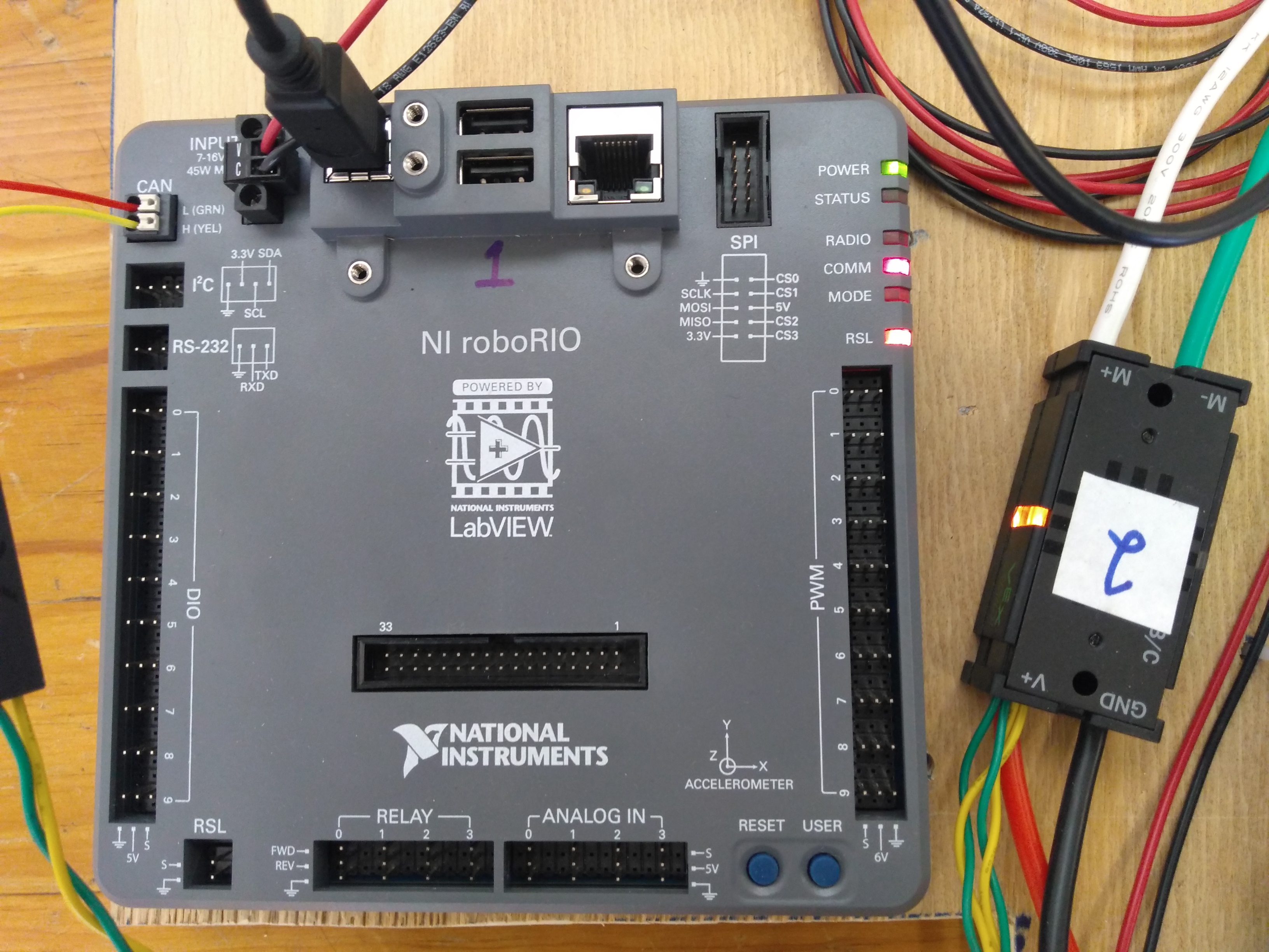

We are experiencing problems with the Victor SPX with only CAN wires.
My team are programming in LabVIEW un laptops and desktop computers.

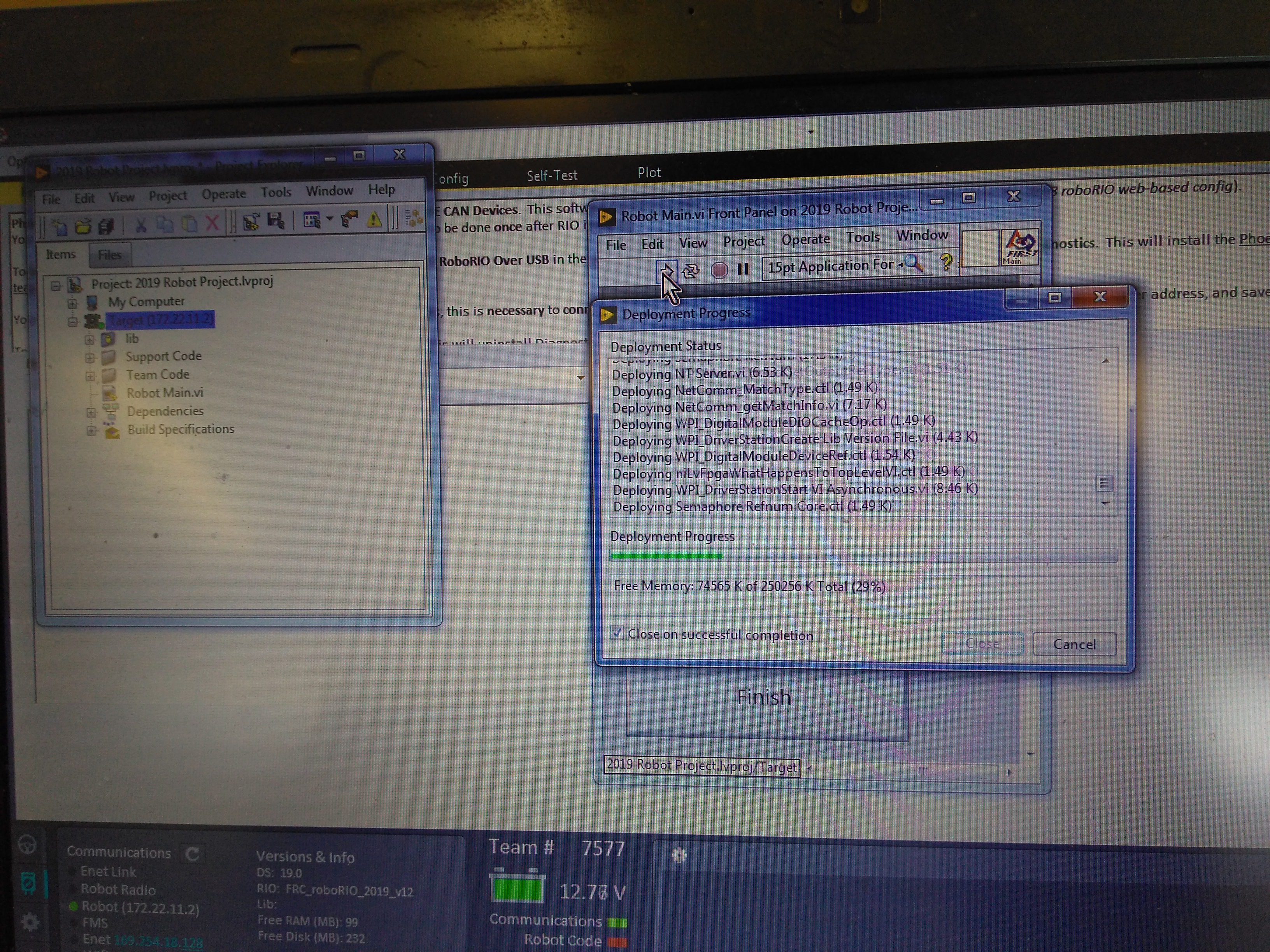

The problems begin with the Phoenix software in the RoboRIO, after the update LabVIEW stop deploying, it says Real-time mismatch, so we checked and found RT 17 on RoboRIO and LabVIEW has RT18.
We are Rookies, our RoboRIO is completely new, we initialize with software and firmware update (the original was 5 and the new is 6)
The LabVIEW is the oficial NI FRC 2019 running on windows 7/10 32/64* and we have the same issue.
Something I notice is that web-based server showed the no web configuration and the left bar showed many icons including the CAN devices, now, only show 2.
In the Phoenix software says no information about the version… defaulting to 2018.
Phoenix tuner don’t show can devices, only in 1 computer I can see PDP and Victor SPX.

    b. Make sure you are terminating your CAN bus with the PDP and that you don’t have devices with repeated ID.

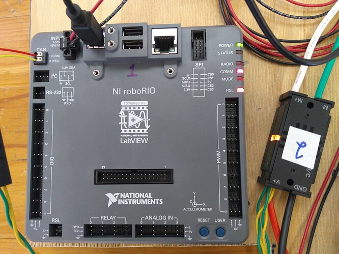

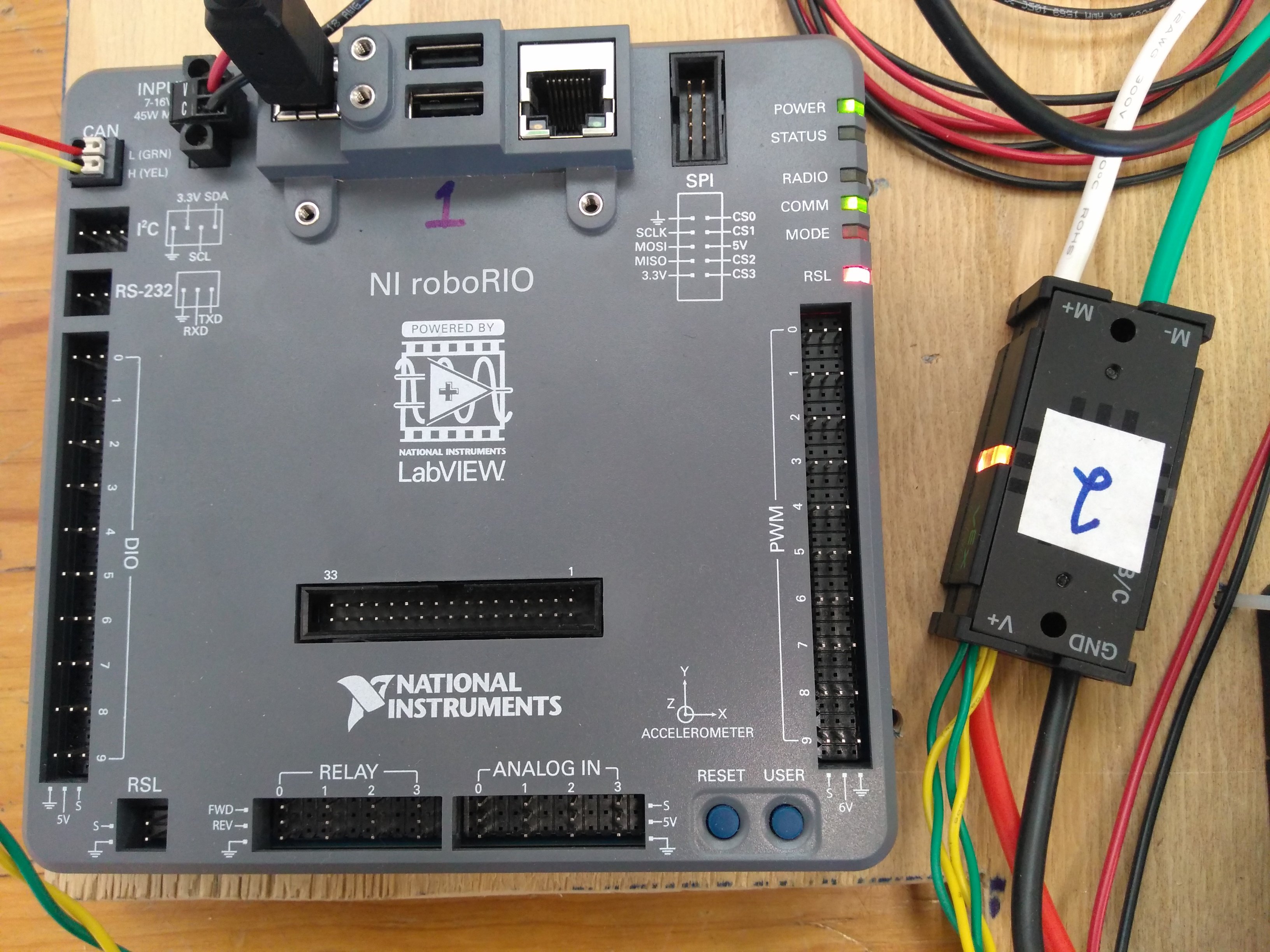

Yesterday morning I was able to upload the code, it worked fine, using a joystick my motor was working ok. Orange led in victor, green status and comm in PDP, green led in victor forward movement and red for backwards.
Wednesday I was having troubles uploading code with an mismatch real time version, I checked it with MAX and the RoboRIO was rt17 and the LabVIEW software RT18, before update roborio with Phoenix tuner I was able to get code working (no can communication) but everything ok

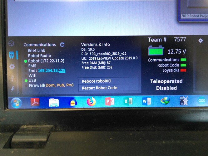

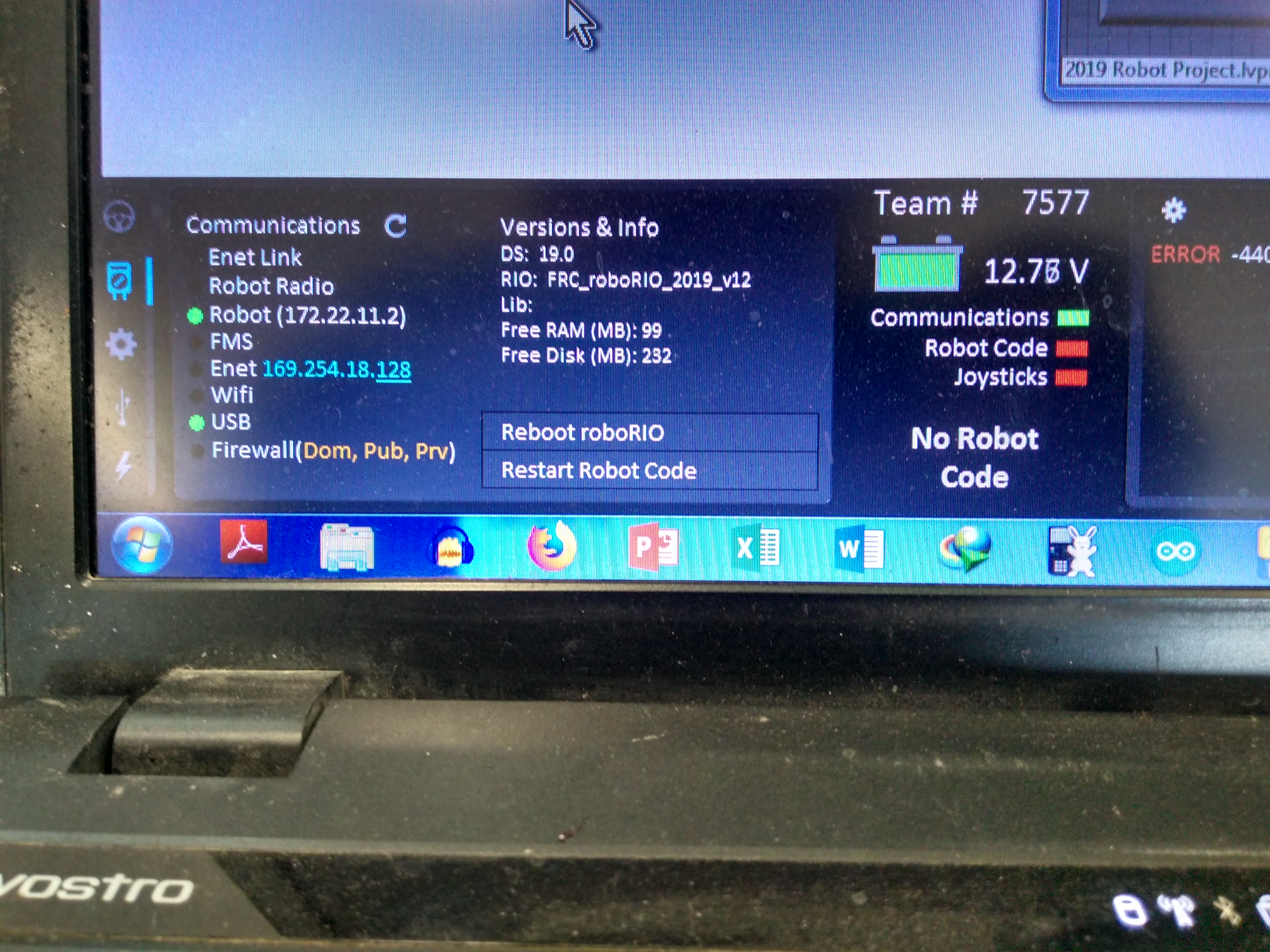

Can you post a screenshot of the Driver Station connected to the roboRIO with the Driver Station on the Diagnostic tab?
That will show us the software versions on everything.
I’m still in home, I’ll post it when arrive to school (8am Mexico)

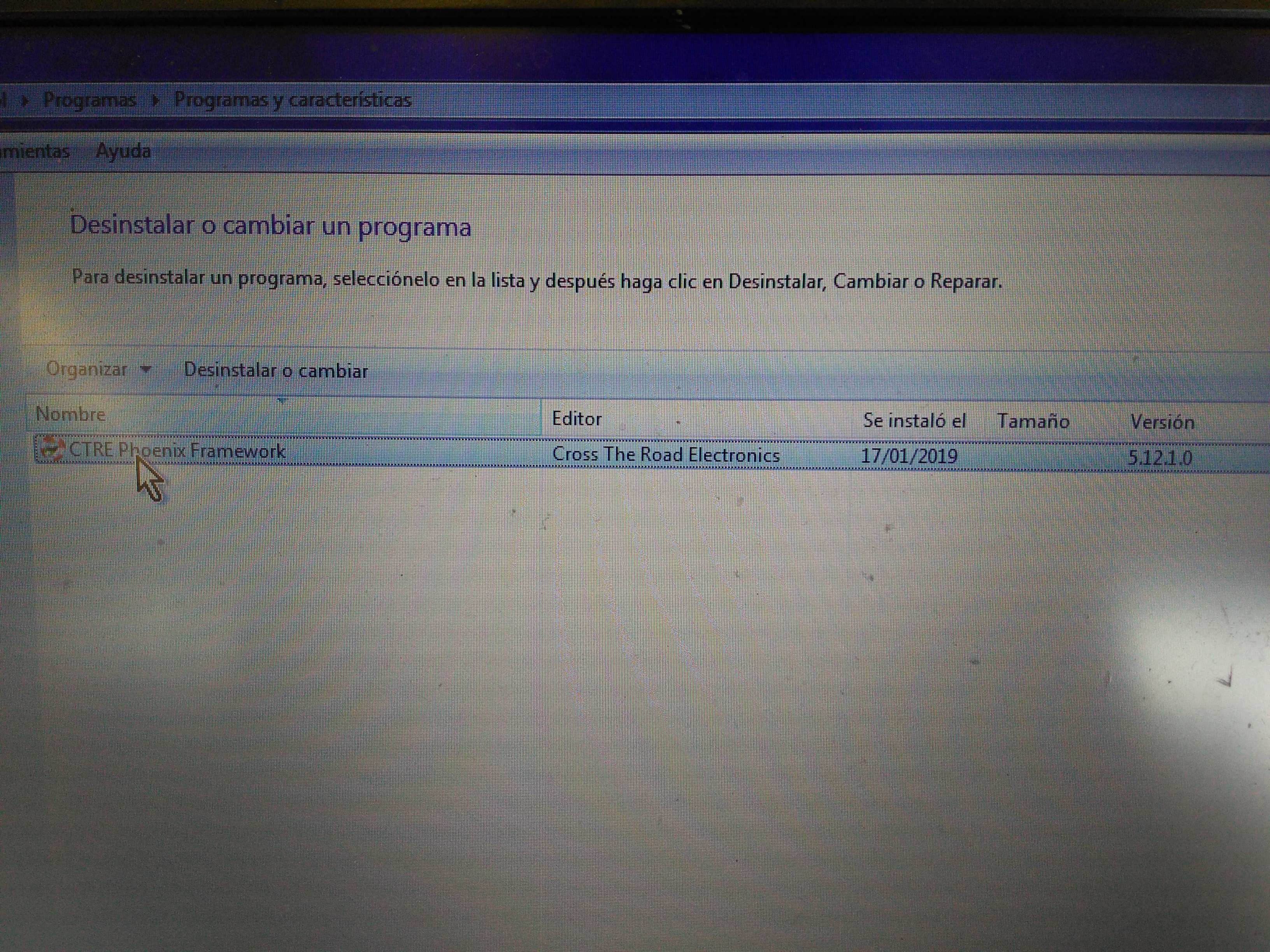

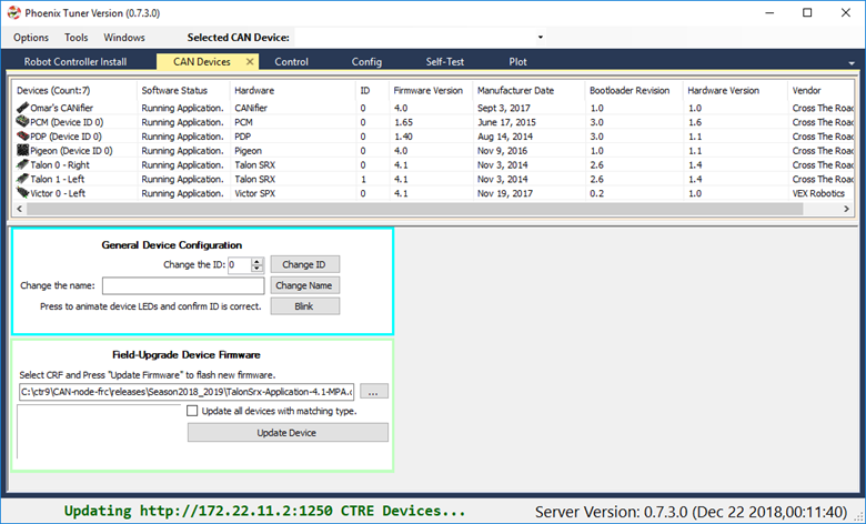

You seem to be using an old version of Phoenix Tuner based on your screenshots. You can get the latest standalone version here: https://github.com/CrossTheRoadElec/Phoenix-Releases/releases
Phoenix tuner version 1.0.2.0
Phoenix tuner is a separate program than the CTRE Phoenix framework. Your screenshot above from 7 hours ago shows version 0.7.3.0 (A pre-kickoff version). The latest CTRE Phoenix framework installs version 1.0.1.0, which should also put a desktop shortcut with a link to it on your desktop of Phoenix Tuner, but you seem to somehow be using the old version.
That pictures are from the first reply step 6 page.
So are you using Phoenix tuner version 1.0.2.0? The screenshot you posted doesn’t tell me anything other than that you installed the correct version of the CTRE Phoenix Framework, but doesn’t tell me what version of Phoenix Tuner you are using. Can you post a picture of the current Phoenix tuner tool you are using?

Based on your screenshots, at this point it appears that you are able to successfully deploy and run code.

And the driverstation

Everything in those screenshots looks normal.
