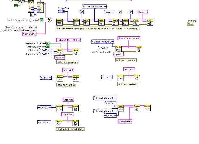

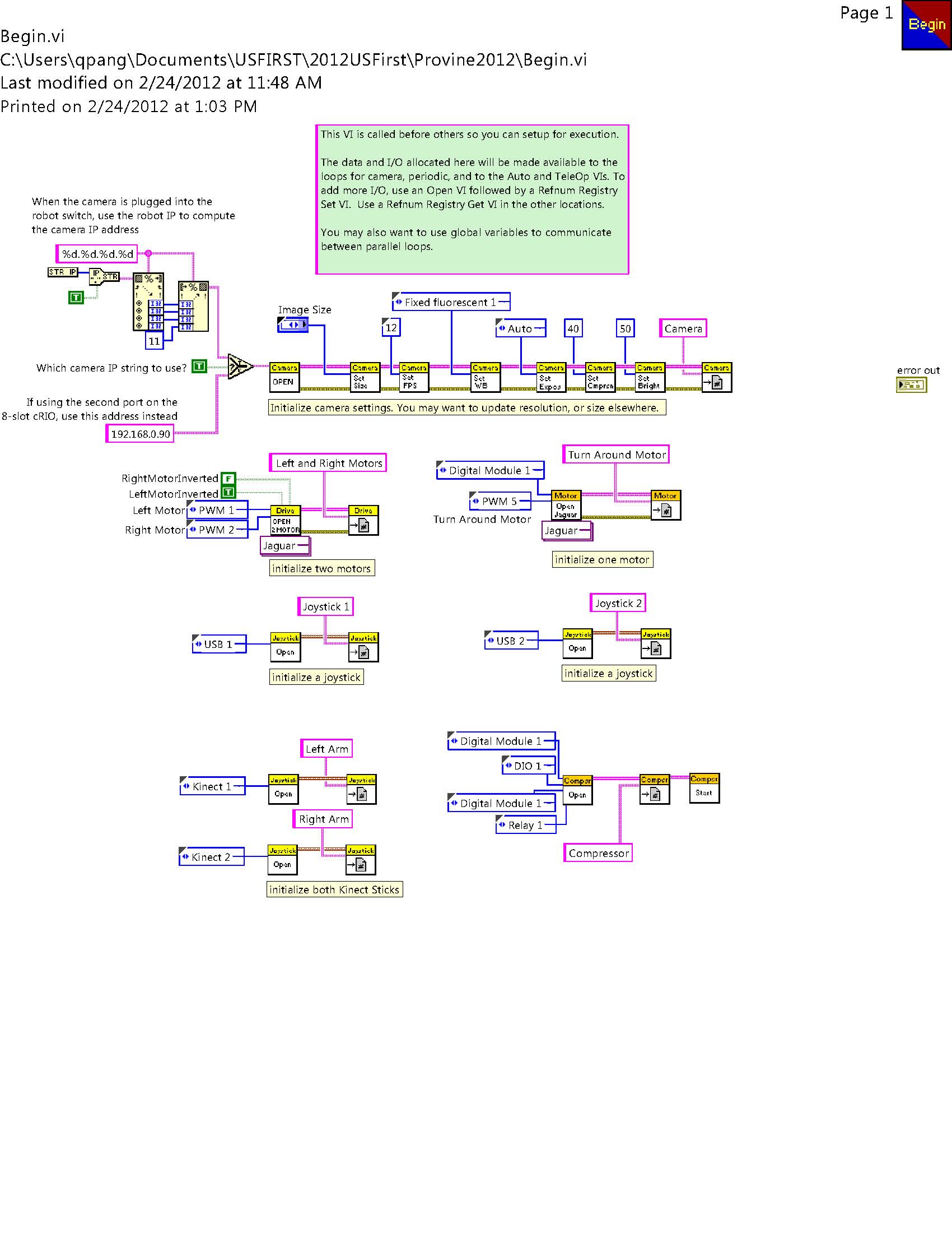

We are working on our compressor and program it in labview.
We put the
Compsr Open, CompsrRefNum Registry Set and Compsr Start in Begin.vi.

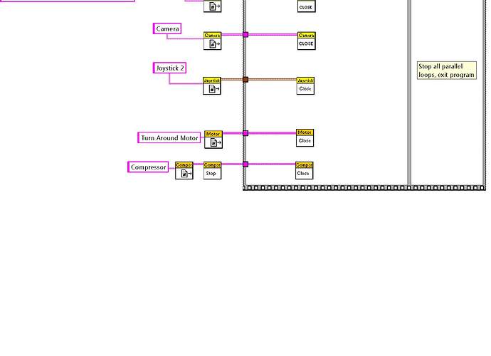

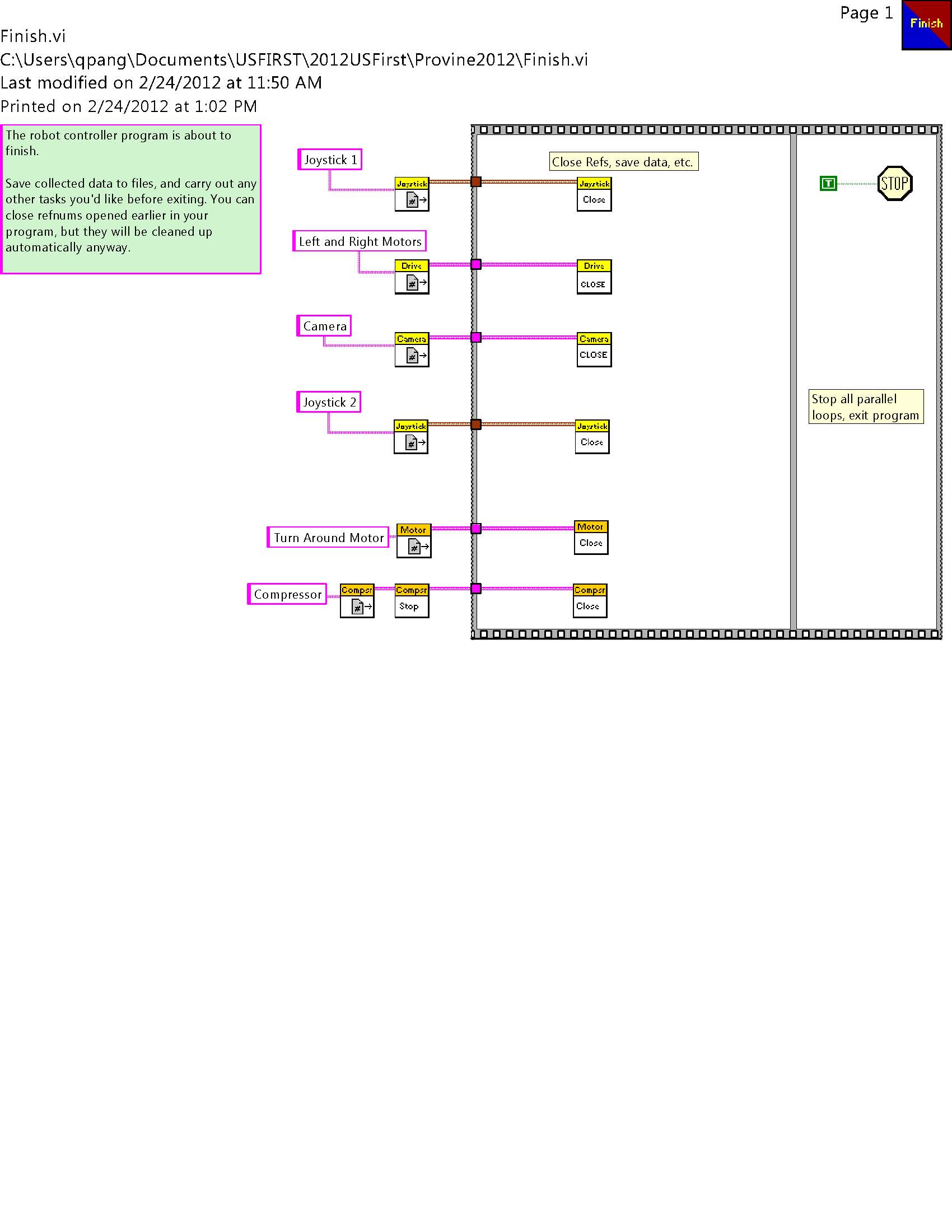

In finish.vi, add CompsrRefNum Registry Set, Compsr Stop and Compsr Close.
I’m not sure do we need to use “Compsr Enabled” module as in labview examples for compressor? If yes, where should we use it?
The Enable isn’t necessary.
Did you update the name for the Compressor used in Periodic Tasks?
You don’t need Enable unless you are trying to bypass the spike relay.
