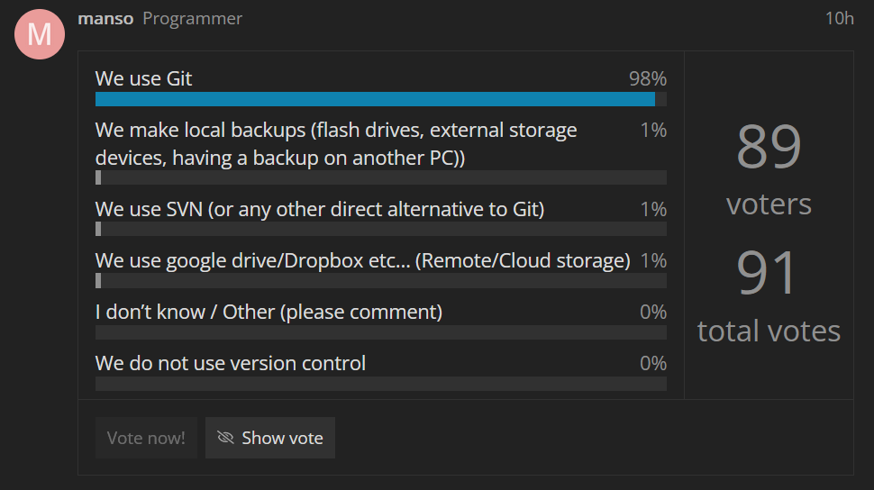

Programmers, does your team use version control?
  • We use Git
  • We use SVN (or any other direct alternative to Git)
  • We use google drive/Dropbox etc… (Remote/Cloud storage)
  • We make local backups (flash drives, external storage devices, having a backup on another PC))
  • We do not use version control
  • I don’t know / Other (please comment)
0 voters
Although Git or SVN is recommended, every team is not the same. I’ve seen some teams that only do local backups and Google Drive backups, because their school has restrictions on their computers, so they can’t connect to Github or BitBucket, etc…
if the current system that you use works best for your team, then that is all that really matters.
Just doing this out of curiosity :>
Google Drive/OneDrive/Dropbox/etc is NOT version control. At best, it’s a backup solution. It doesn’t handle simultaneous edits at all, and has no concept similar to the .gitignore file, so you have no way of preventing certain files from being shared.
For any teams using one of those systems, I urge you to PLEASE learn git (or other actual version control system). I promise, it’s really not that complicated unless you’re using it in weird/atypical ways.

There’s obviously some CD bias at play, but these results are encouraging. It’s really not possible to develop anything more than a toy project without some VCS, and git is industry-standard for a reason.
i’m a squash merge commit PRs main
I’d expect the poll to be different if all FRC teams were interviewed.
