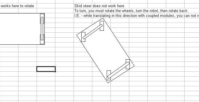

Field centric is something I want to work toward, but first I want to firmly define in my mind what our end objectives for maneuvering should be.
We are going to go 4 modules, in 2 pairs. My thought is similar to a post from wild stangs: when the wheels are within 30 degrees of making the robot a wide configuration robot, the rotational joystick will simply modify the wheel speed and the robot will tank turn.
Once the robot is diagonal to the direction of translation, you can no longer rotate. This is because wheels at the left and right corners will oppose eachother. Again: I’m looking at the situation where you have left and right side coupled modules.
See attached picture and tell me if my thinking is correct or there is some shortcut to work around the directions that you cannot rotate.
Actually, on the right, the robot could still theoretically turn a little, the sidescrub of the wheels may sway otherwise. If both sets were powered opposite, a moment would be created around center.
The nice thing about the control software in this scenario is, if you tell it to turn 5 degrees, it’ll turn 5 degrees no matter how difficult it may be for a human to do so (I know I don’t have to tell you that, but figured it was worth mentioning).
I’m going to throw this solution out there, and let you figure out how to apply it to a Crab. It shouldn’t be that hard, except that I have hw to do…
What you want to do is minimize the slip velocity squared of your wheels. If you set up a set of equations that describe the slip velocity of your wheels given the wheel angles, velocities, the goal velocity vector and the goal angular velocity, you can optimize the wheel angles and speeds.
I ran through this math for a swerve drive with paired wheels like you drew, but individual motors for each wheel, and when we downloaded and ran it, we were able to translate and rotate with ease. I was able to get out a closed form solution for the correct wheel angles.
Once you do that math, the bot will discover that if you want to turn while going sideways, you want to steer by turning the modules in opposite directions. It’ll also figure out that you just skid steer when going forwards. It’ll also figure out how to mix the two modes when going at an angle. It’s a beauty to watch in action, and has no special cases. In other words, once you do the math, it just works.
I created a spreadsheet to do the math for this problem (it even has a little graph to show you what direction each wheel is turning). As the other poster said, with independent steering for each wheel, once you get the math done correctly there are no special cases and it just works.
