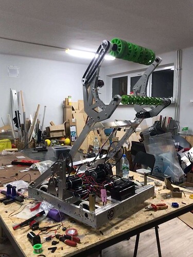

Programming Arm states (Java, Command-Based)
Hi! Our team has built an arm that has 180degrees of movement (front to back axis). We need to program it to keep the angle that we want (preferably pre-programmed angle states). We wanted to do it by PID and encoder. I calculated the ratios and have accurate angle of arm itself but when testing PID to setPoint it to 15deg it flew all the way back and slammed floor. The encoder values were good i think. The arm is somewhat heavy but motors have more than enough power to power it. (20% is fast enough for moving it)
I need help with programming it to angle states and making it keep angle with no driver input. I’m kinda worried with testing it, bcs i dont want to slam it again. If you know some good way to protect it when tesing that would help.

Physical protection… tape a pool noodle to it.
Coding protection… use a clamping function to make sure you limit it while tuning it. As you get dialed in relax the clamp.

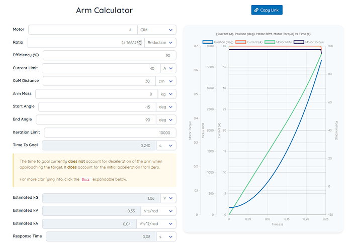

You will have to either use manual calculation, an online calculator like ReCalc, or physical test routines to figure out the relevant gains. I suggest doing something a bit more precise than tapping on a joystick - do you have working telemetry so you can read the applied voltage on your dashboard?

kG and kS can be estimated easily via manual control. The others will probably require theoretical estimation or a SysId routine.
I’m not sure about the weight and CoM distance and efficiency (andymark toughbox → chain reduction)
And are the start angle and end angle from horizontal ground? so -15 to like 90 or 180 to the back of it?
From this calculator kG should be roughly around .8V to 1.5V
Those are what really determine your gains, so if you’re not sure about those your gains probably won’t be correct. You should try to measure them as accurately as possible.
Efficiency is usually well-estimated by a 10% loss per reduction stage (a little less for gears/belt, a little more for chain).
