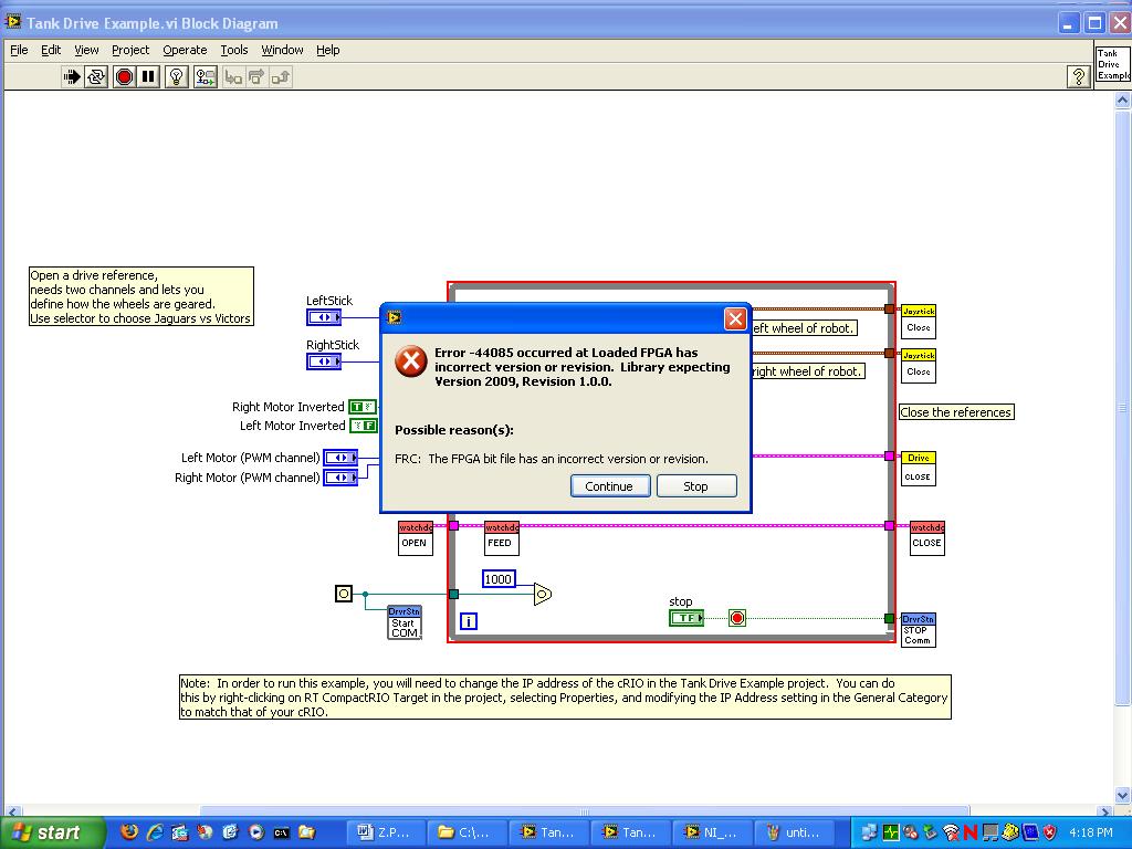

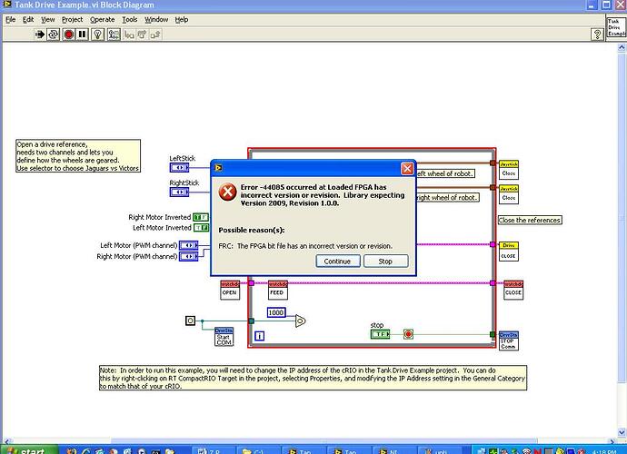

Help, We are getting the following error when attempting to run our code (which was made in Labview).
We have update it with version 3
It says on our DS 2009-10a3
You likely need to reimage your cRIO with the image installed with Labview Update 3. As I recall the image should be v11.zip
You also should upgrade your DS firmware to the latest version which can be found (along with instructions for updating) here
We have 2009-10a3 on our DS.
Our first program works just fine - just using the joysticks to move the wheels.
When we try to RUN the new version we get this error. We did not want to put the new program on as run at startup because we want to test it for errors.
The cRIO and the DS have independent firmware. I apologize for suggesting you update your DS, I did not examine the number you posted closely enough.
The latest version of the cRIO firmware is FRC_2009_v11.zip. You can update your cRIO by running the FRC cRIO Imaging Tool. This tool should detect the cRIO automatically and show it in the small window at the top of the tool. If it does do the following to update your cRIO firmware:
  1. Select Labview as the “Development Environment”. I recommend checking the box to always run deployed code at startup. This will not affect the code that you Run with the white arrow, only code that is deployed.
  2. Click the “Format Controller” checkbox.
  3. Select FRC_2009_v11.zip as the image.
  4. In the Device name box enter “FRC-cRIO-1254” without the quotes
  5. Enter your team number in the “Team ID” box.
  6. Click Apply. This will start the firmware update, the process will take 5 or more minutes to complete. When it completes it will say that it is successfully updated and you may then click “Close”.
  7. Turn your robot off, wait ~15 sec., then turn it back on to load the new firmware into the cRIO.
After the cRIO is updated try opening Labview and running your code again. Post back on whether the error is resolved or not.

See error file:
We get this and then it goes through and it loads 100’s of vi’s.
We press okay and then it appears to have deployed but then the robot is not responsive.
This is just joystick tank drive only, but we get the same error when we run the
program with the dumper.

I’ve seen this, or a very similar, error message when working with one of the former teams I used to mentor. They had removed all of their modules from the cRio and then replaced them in random locations. (They thought the slots were all on a bus and didn’t realize the FPGA was coded for specific modules in specific slots.) Could this be happening here?
