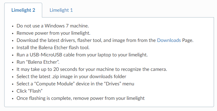

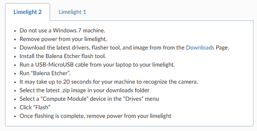

I’m a new programmer for our team. I understand there are docs at docs.limelightvision.io. I’m stuck on the Imaging step. What .zip file do i choose/look out for?
the image file that you download from the downloads page
2020.0?
keeps saying i failed the flash
Is there an error code or something? Is your Limelight setup from a previous year?
No just this year
Doesnt say any error code

99% of the time flashing problems are caused by a faulty USB cable or a USB cable that doesn’t have the data lines (charging only cable).

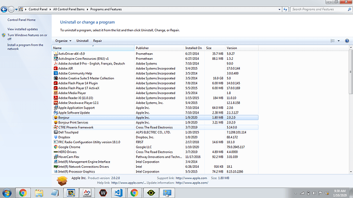

just got it flashed, now moving onto the networking
I think this is ok. you only need it if you intend to connect to the limelight with an mDNS address e.g. http://limelight.local:5801
Otherwise you can use limelights ip finder tool and hard code those ip addresses (for now)
stuck on this step, i’m not able to connect to limelight.local:5801
Don’t connect to the mdns address. Instead, connect to the 10.TE.AM.xx:5801 where xx is found using the limelight finder tool.
