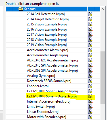

Have you looked up the examples, maybe this mb1010 example would also work for the mb1013. There are analog and digital examples, I thought I had better results with the digital version. Examples run easiest by connecting to the RIO via USB, and then using the Run arrow button to start the example.

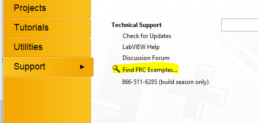

Hi ngreen and TomLine! Wow, thanks for a prompt answer! Your answers are valuable and we will definitely keep those in mind. We did, in fact, looked up the Labview examples and we weren’t sure how to use the examples seen in this picture
image in an actual autonomous routine. We understand this example is meant to be a standalone program for testing via the USB, but I just don’t know how to break down the code provided in the example in my main program. Do I simply copy-paste it somewhere, or should I compartmentalize it in the different VI’s namely, Begin.VI, TEleop(or autonomous), and Finish.VI. Also, we understand that this forum is not meant for begging for hands-on solutions, but a little help to a starting team would be much appreciated. We’ll make sure to present a program next time (at least what we tried to program) so the learning process becomes more valuable to us and others who may be in the same situation.

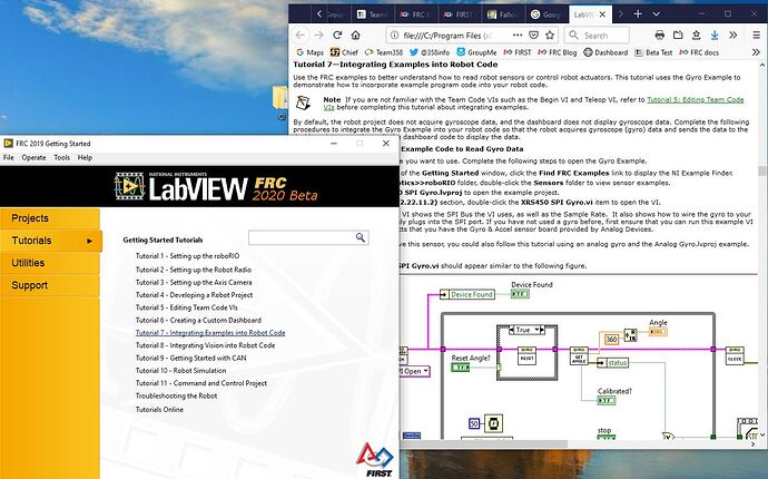

There is a LV Tutorial on integrating the examples into user code:
If you have trouble with it we can provide a more explicit example.

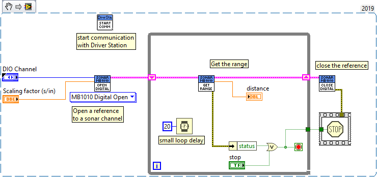

You don’t use it as-is because the stand-alone program aspects are already being done by the default user code.
This will give you a good idea of how to structure your code:
The leftmost block of code goes in begin. This example is a Digital input / output and not sonar, but the idea is the same. Make sure you use your sonar specific VI’s and not the DIO VIs shown here. The middle block of code goes in Teleop. The last goes in the Finish.
“Begin VI”
This is where you open hardware to use later. You’ll need an open VI and a setref VI. The Open VI sets the hardware info, and the setref gives it a device reference so you can call it elsewhere in your code.
“Teleop VI”
This is where you actually read the data. Here you’ll use a getref VI, using whatever you named your sensor. Then you a Get VI to actually get the data.
There is a second option - the teleop vi runs at the same rate that it receives packets from the driver station - around 20 ms. If you have something that needs to run faster, or runs slower, you can instead put a while loop in the Periodic Tasks VI and do the same there. The difference is that teleop is always constrained to about 20 ms a loop. Never put a loop inside the teleop VI, because it will delay the VI and cause your robot to be temporarily disabled when it doesn’t communicate consistently.
“Finish VI”
Do what they did here. Just use the particular ultrasonic sensor.
