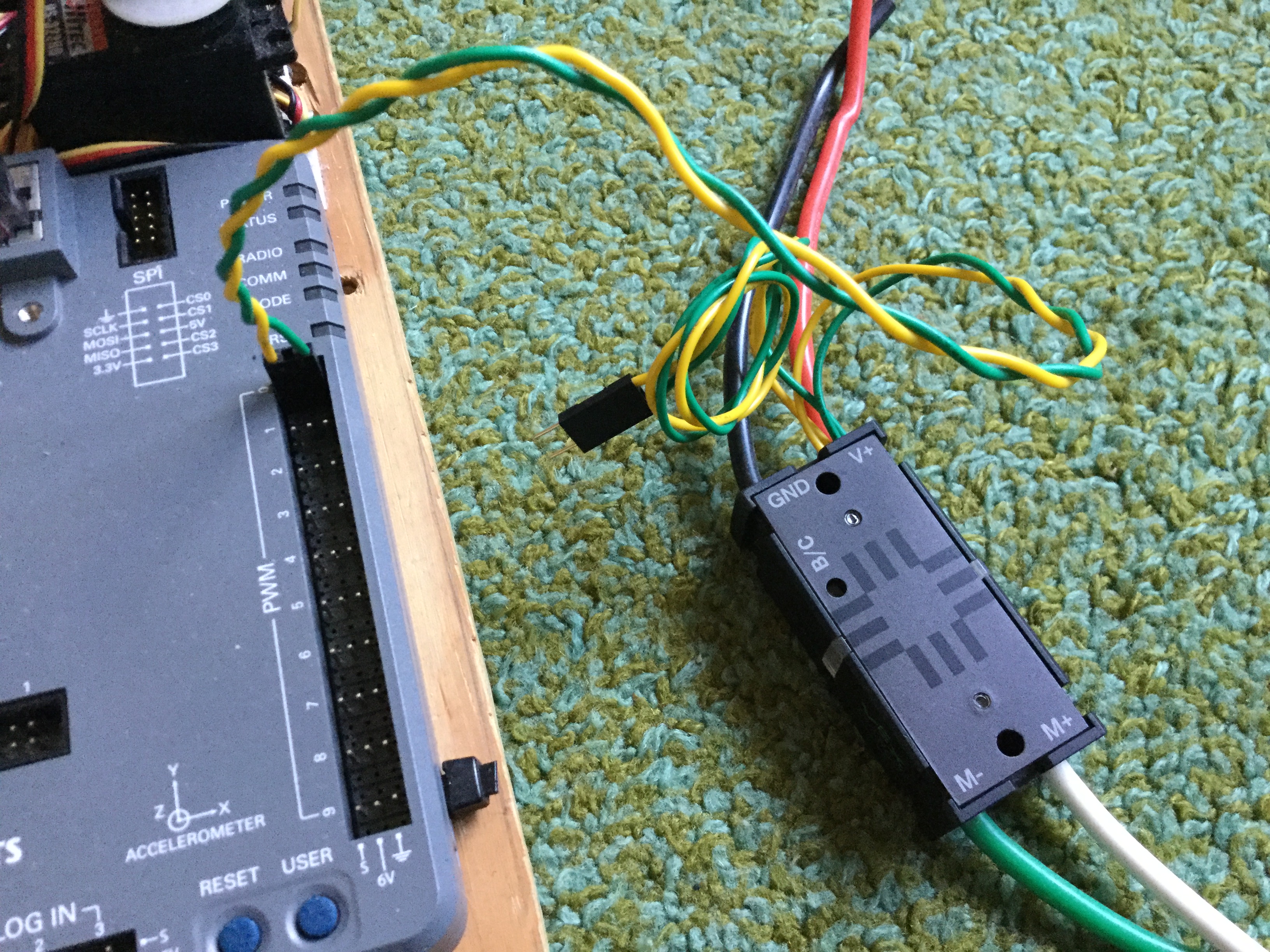

If you go the PWM route only one of the yellow-green pairs from each motor controller are used, and it plugs into the PWM ports on the Rio. (Only if you use CAN are the Victors daisy-chained one to the other.) From the guide, the green wire is plugged into ground, the yellow is the signal.
Here’s a photo of a Victor SPX wired via PWM if it helps.
Only the female end of the yellow/green control wire is used. The male pigtail just gets coiled and tied up out of the way.
There are also black/red/white PWM extension wires that came in your KOP, so the Victor can be further away.
