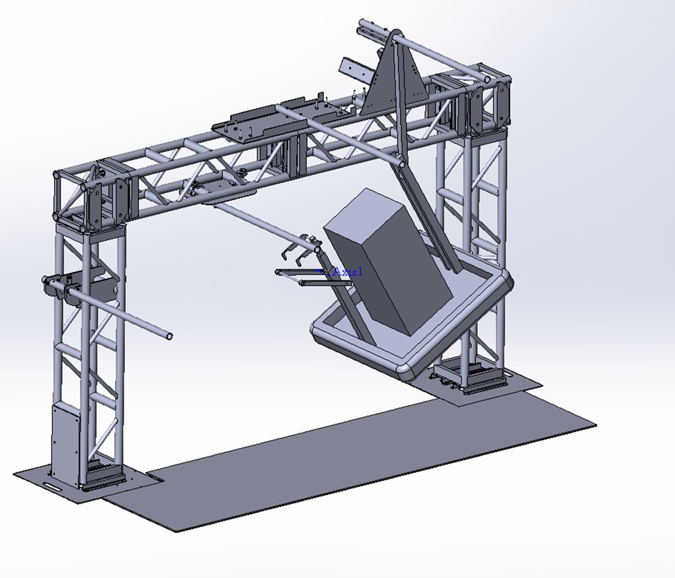

Crayola CAD, I call it Cartoon CAD, is incredibly effective and important. To me, CAD throughout the season never stops, we are constantly iterating the design which means we never stop doing CAD.

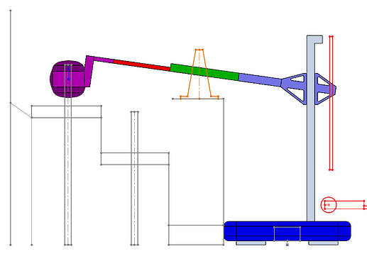

- Robot Architecture Sketches (2 days)
- Most often a Side View, illustrates the frame, bumper, intake, superstructure, and different scoring positions
- Often a separate sketch done by someone else for the endgame mechanism they are exploring in parallel
- Example from 2019 with intake, climber, arm on elevator, etc

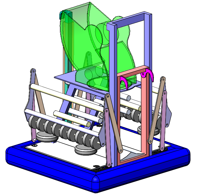

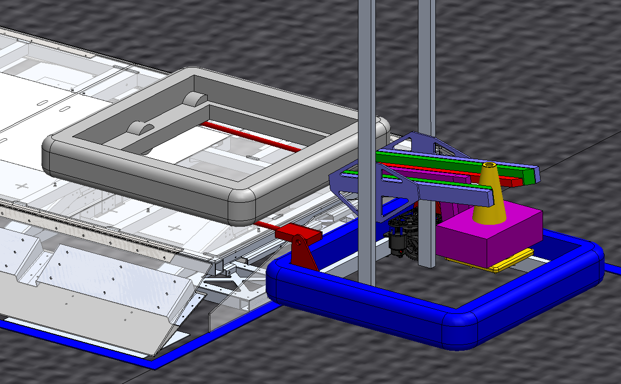

- 3D Cartoon (Crayola) CAD (2-5 days)
- Extrude shapes to make a multi-body master model that has the Drivebase, Bumpers, Superstructure, Intake, Endgame mechanisms
- Sometimes separate those bodies into individual parts and remerge into an assembly so you can show the intake stowing, scoring positions, turret swept area etc.
- As the designed, I often find this takes me about an hour to split all this out, and honestly isn’t necessary for myself who can understand my own sketches, but is immensely useful for other team members to visualize the architecture, potential interferences, get excited about owning a certain subsystem, etc.
- Examples below from 2022 and 2023

- Usually start a fresh Master Sketch that outlines the subsystem: motor placement, stroke length / range of motion, compression amounts / roller size, belt/gear powertrains
- Often these are multiple sketches stacked ontop of each other illustrating structure, powertrain, stow pose, top view, etc.

I follow a similar structure to you, but instead of any Cartoon/Crayola CAD I just put more work into the 2D sketches. I see the value cartoon cad can have, I’ve just never found it as necessary (probably because the cad teams I work with tend to be small).
I put a large focus and devote a lot of time to 2d sketches when designing as well. Most typically it’s side views, but front and top down views can also be quite helpful at times.
In a pinch/early on with 3d modelling, drawing 1x2 tubing structures as a single solid extrusion can be immensely helpful too. Lots of time saved by being able to modify a simple sketch/extrusion rather than update individual parts multiple times over throughout the initial design stage.

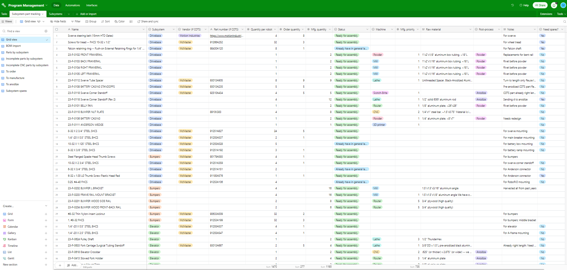

Once more mature we do a BOM review on a zoom call. We export the BOM to a spreadsheet that we import into Airtable for tracking order and manufacturing status. On the call, the designer screenshare annd and thens starts hiding component by component from the subsystem until everything is hidden (it’s a way for checking things off the list). It’s here that we check all the implementation decisions like fastener selection, “is it strong enough” gut-checks, and catch big errors.

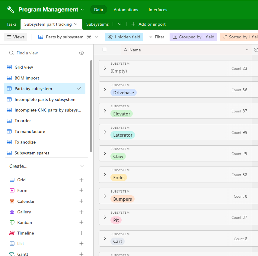

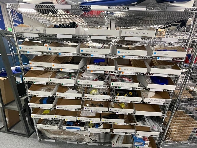

We use Airtable for Program Management, tracking parts in subsystems and making sure they get ordered, manufactured, and assembled onto robot.
Each item, COTS or custom, is entered as a row. Often the initial upload of these comes from a Solidworks BOM export → CSV → Airtable import, but we will also add parts individually throughout the season. We have a variety of columns which combined with Airtable’s great View / Filter / Sort / Group commands allow us to organize the data in many different ways.

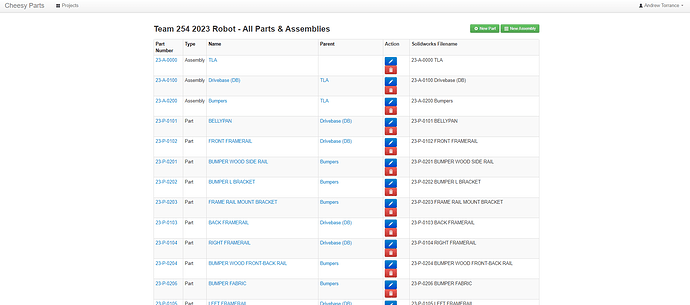

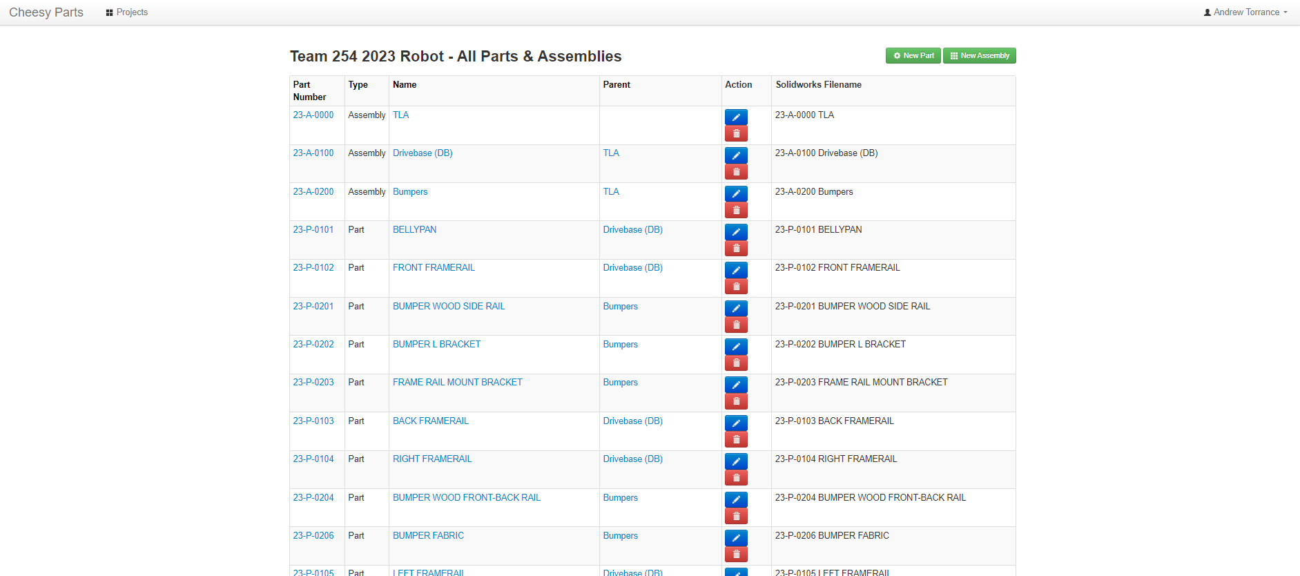

We still use Cheesy Parts, but really only for the creation of Part Numbers per subsystem and making sure PNs dont overlap. We do not use the status or other fields in Cheesy Parts.
As parts get finished, we put them in labeled cardboard bins. Cardboard bins are nice because if they get gross (oil/grease/dust), we can just recycle them and have new bins for the next year. The color coded dots allow us to label very large parts, like superstructure tubes, leaving them on top of the rack or in other areas of the lab.
This post added an immense amount of clarity to an issue we have had in the past. Organizing what happens after the design is done to ensure nothing is forgotten and nothing is misplaced is a gap we have been trying to close.
Between the BOM export to that table and your bin sorting strategy I can see how your team implements a robot beyond the cad design and for most teams that is actually the hard part. This is something we could implement easily and I thank you for sharing this!
