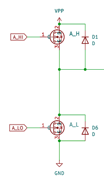

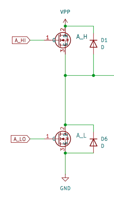

Here’s a diagram of an H-bridge cell.
MOSFETs switch to their closed state when the voltage between the gate (pin 1) and source (pin 3) is higher than a known threshold voltage (~2v). Assume a microcontroller is grounded to GND and uses 3.3v as a logic voltage. You can turn on A_L with the microcontroller because its source is at 0v and its gate will be at 3.3v. Turning on A_H is more difficult because its source could be at any voltage between 0v and 12v. In theory, if it is higher than around 1.3 volts, you might not be able to turn it on with 3.3v at the gate. Even worse, current can flow backwards from the source through the gate into the microcontroller, which can hurt it. DRV8300 handles all this for you and even prevents “shoot-through” by never allowing the high and low side to be on at the same time. It also takes strain off the microcontroller in general.

Use two resistors and two ultra-fast recovery diodes. Each resistor is in series with one diode. The gate of the MOSFET cathode of one diode and the anode of the second diode so they are in anti-parallel. The other end of the two resistors are both connected to the output of the gate driver circuit. This allows adjusting the turn-on resistance independently of the turn-off resistance.
Beware of gate resistances that are too high. It can lead to device oscillations due to the Miller Capacitance of the MOSFET and excessive power dissipation.
Gate resistances that are too low can cause large spikes on the Drain-Source voltage. One should be able to adjust the gate resistances so that the spike is 10% of the output voltage. If the spike amplitude cannot be reduced without going to gate resistances that are too high, it means the inductance is too high in the loop from your power supply to the MOSFETs and back. You will need a differential probe to monitor the VDS of the upper MOSFETs.
Make sure you are using some sort of gate driver chip so that there is a low impedance drive for charging the MOSFET gate capacitance and for discharging it. A “passive” drive circuit can also lead to device oscillation and excessive power dissipation.

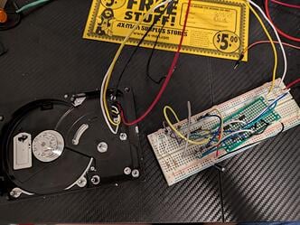

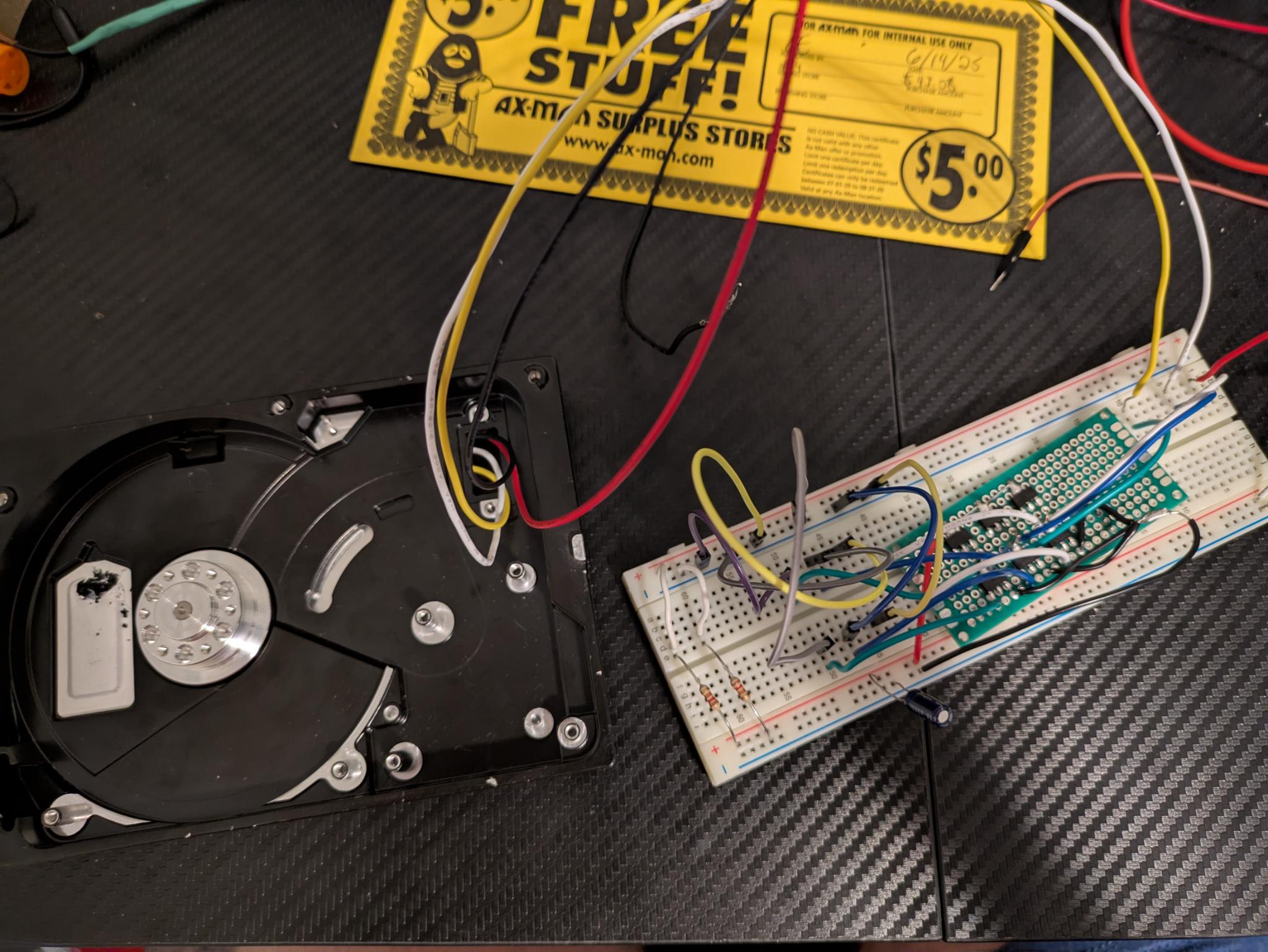

Got it working with manual switching, I’m going to start adding the gate drivers and Nucleo soon. The thermal performance is obviously atrocious but it can handle enough current to make this hard driver “spin” (twitch).
I almost immediately caught it oscillating at ~3.3 MHz, that’s how the decoupling capacitor ended up there. Current also kept flowing backwards through gates, very rude.

That type of prototyping board does very poorly with high frequency circuits. There is a lot of capacitance and inductance that make things worse than they would be on a real PCB. The solder type of prototyping board is better but the layout would still need to be done well to avoid oscillations and other undesirable behaviors.
Update for July 7: I managed to fry my Nucleo board, though I suspect it was more from bad handling and ESD than from the circuit itself. The gate driver is installed and works fine. Before the Nucleo got fried I was able to get the motor to spin around slowly with variable speed and a fairly satisfactory amount of torque. However, there’s currently no feedback so the driver constantly runs at full power. Once I get a new board I am going to try using the back-EMF method for syncing.
