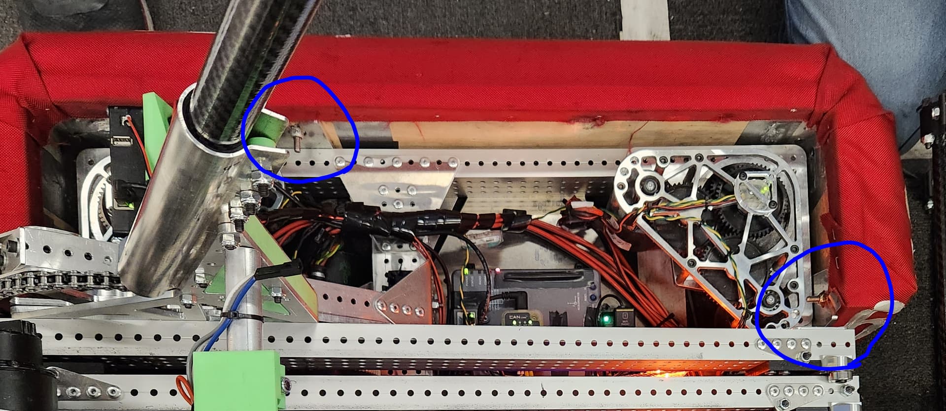

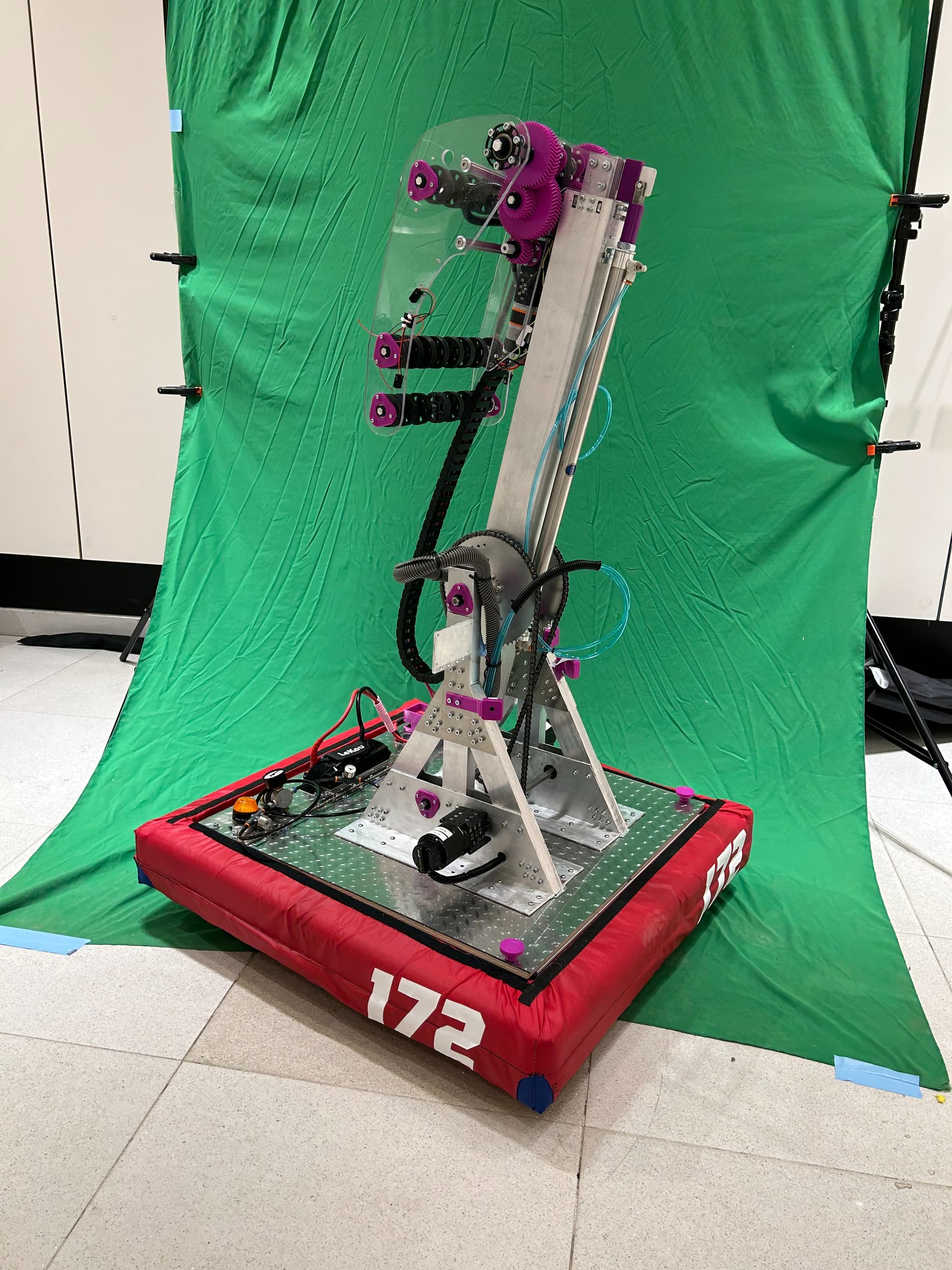

Could you explain how your bumpers are attached? My team currently uses
some form of bolt (positioned vertically) to connect the bumper to the
frame, but we are looking for a more reliable and faster solution.

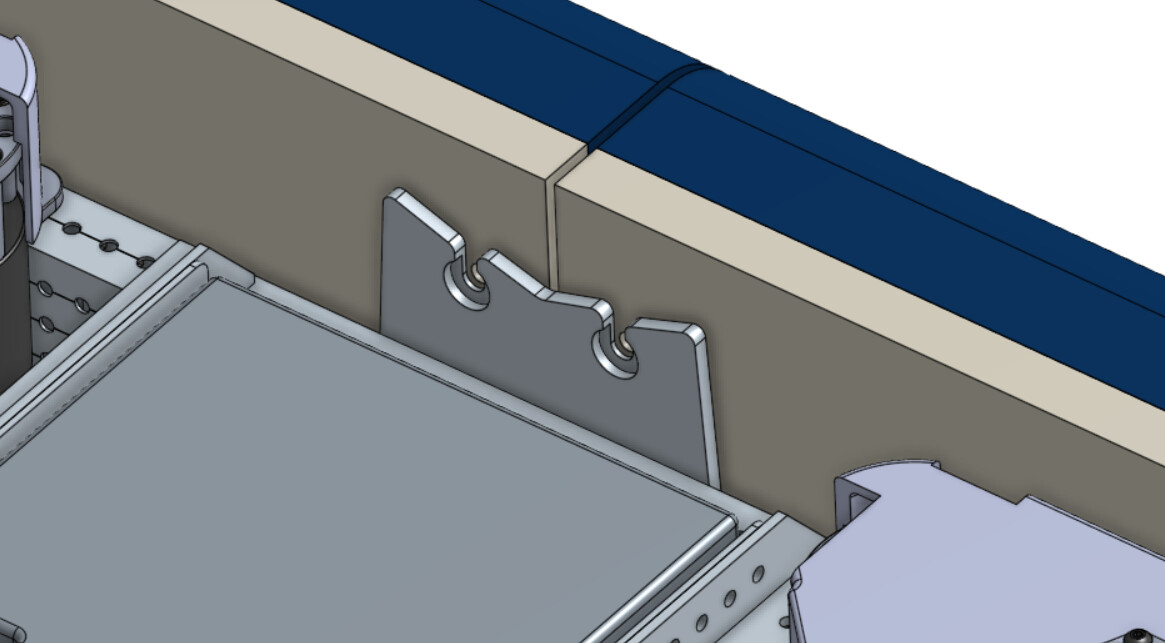

Sure thing!
Around the perimeter of the robot we have some vertical plates with a slot and a counterbore.
The bumpers each have threaded studs coming off of them, so you lower the bumpers down into the slots, and then tighten a nut into the counterbore to secure them. I don’t have any great pictures, but I circled a few of them here. We used the same system for our 2022 robot, and you can check out the CAD here.

Thanks! This is exactly what we were looking for.
How are those bolts attached to the bumper? It looks like a weld from those photos.
