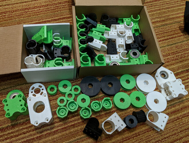

I’ve been printing out as many Protopipe connectors as possible to prepare for build season and to test out my 3D printing pipeline capabilities. Also the 5254 HYPE blocks.
Every team would benefit from using these in some way and if you’re just prototyping with them, may as well be printing them now so you have them week 1 of build season.

Are those (or anybody else’s Protopipe prints) in PLA, and if so, what kind of success did you have? The document says to use PETG, Nylon, or Polycarbonate to print these, I assume because they have to flex to snap around PVC and PLA is quite stiff.
PLA+/PLApro works well. Standard PLA snaps pretty easily but if that is all you have they can work for certain applications.
We don’t have anything yet, but are trying to decide between MatterHackers PRO series PLA and MatterHackers Tough PLA. From what I can tell, Tough PLA has a lower flexural modulus and higher impact resistance, which I would assume would mean it does better in this application (this is based on Ultimaker datasheets because it seems that MatterHackers doesn’t have their own datasheets for tough PLA).
This is the PLA we use, almost everything printed on our robot was printed in it this year including our pneumatic tire hubs and more.
