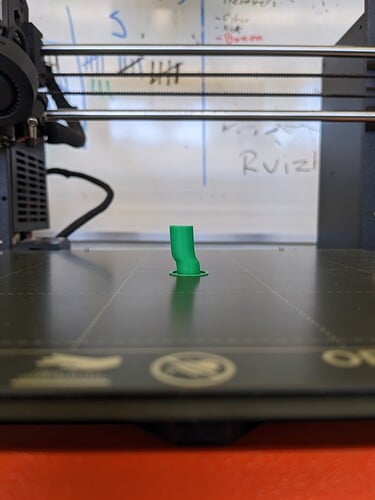

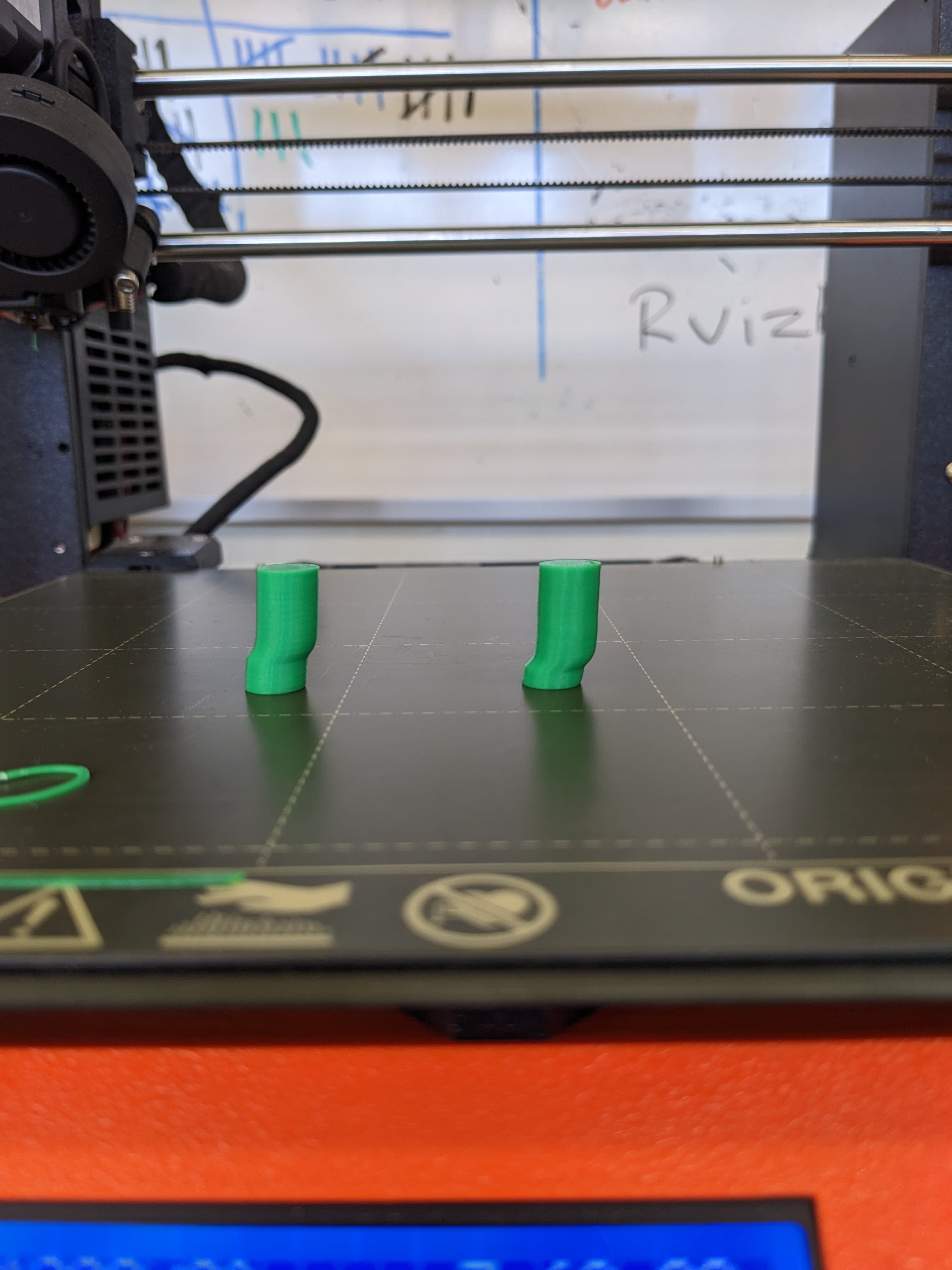

So we’ve been encountering a problem with one of our prusa i3 MK3i’s for …like a year now, in which there’s rather horrible layer shifting. Today’s most recent example:
PLA, default settings for print speeds
Things we’ve tried:
  • rebuilding the hotend
  • adjusting belt tension both up and down
  • rebuilding the x axis
  • adding lubricant
  • replacing the bearings
It hasn’t gone away. Some interesting things of note is that it always seems to happen around the same spot ~15 layers up or so. however, i’ve also ran a test print of a really small pillar that went up past the z-level it typically happened with no issues.
Ordinarily, I’d say the belts. but, seeing as you’ve dissected that…
Check the Z axis carefully. You’re looking for straight tracking, or dings in the axis.
Also check the G-code. It may be that something is being added somewhere to shift a layer.
The rods can get scored also, be sure to check them out.
Is the printer in stealth mode? usually it would detect a layer shift and rehome, but thats disabled in stealth mode.
You should also debug bearing tension (from surrounding hardware) and verify theres no scoring in the rails. I’ve also seen prusa bearings fail from not being re lubricated.
no
The x and z axes both look fine, there aren’t any nicks that I can see
Additional context regarding the above image, I was watching the print when the layer shifting happened, and it didn’t seem like anything was off.

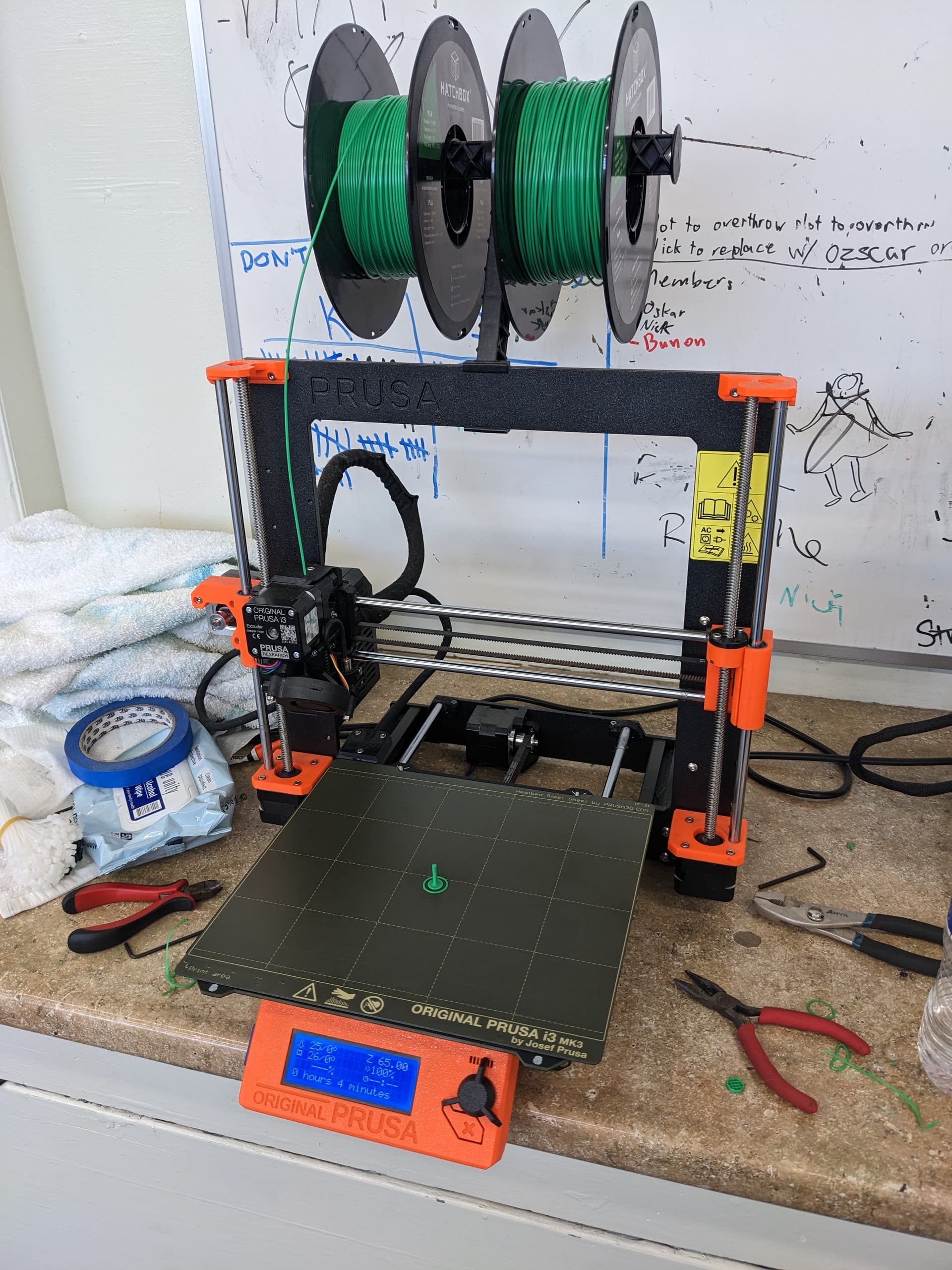

Some more images:
the entire printer:

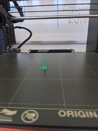

it’s repeatable
until somehow it isn’t
I don’t think anything catches on anything, I’ve watched the print shift without seeing anything immediately sus.
I also don’t think it’s the gcode’s fault (but not too sure on that); this problem has followed us across slicers - Cura to prusaslicer
Though this iteration of the issue is a bit different from before - before it was an abrupt shift of a few layers of ~3mm and then back to it’s original, repeatedly
Hey! I’ve built a rep rap so I am familiar with all failure modes of 3d printers! This is probably one of three things, stepper is getting too hot and skipping steps (probably not). The stepper driver is getting too hot and shutting off (maybe), or most likely, your stepper current is too low, try adjusting the potentiometer on your main board, clockwise is usually more current. Best of luck, if that does not work it is a loose connection to the stepper. I have had this problem before, let me know if that fixes it!
Ps. Prjsa can print over USB (it runs Marlin 2.1.1) so repiteir host can print to it over USB!
I’m pretty sure prusa uses Polulu stepper drivers which can have step dropping problems.
I run my Prusa from Octopi connected to the USB B. I can upload gcode directly from PrusaSlicer without even being in the same room.
