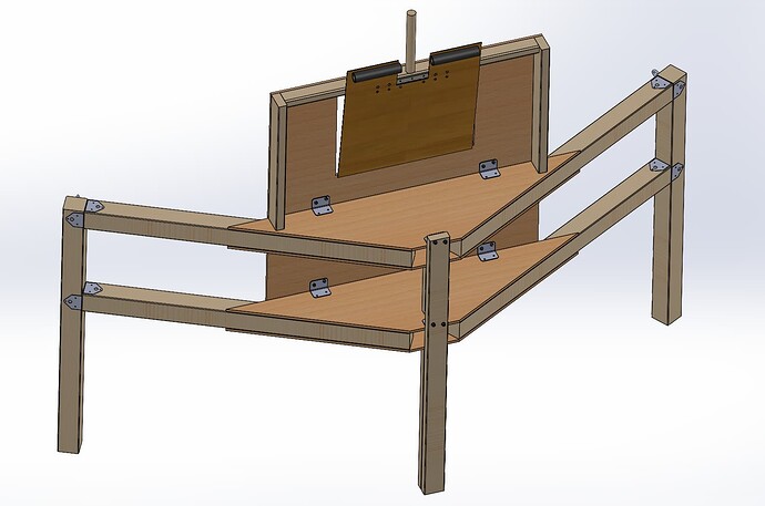

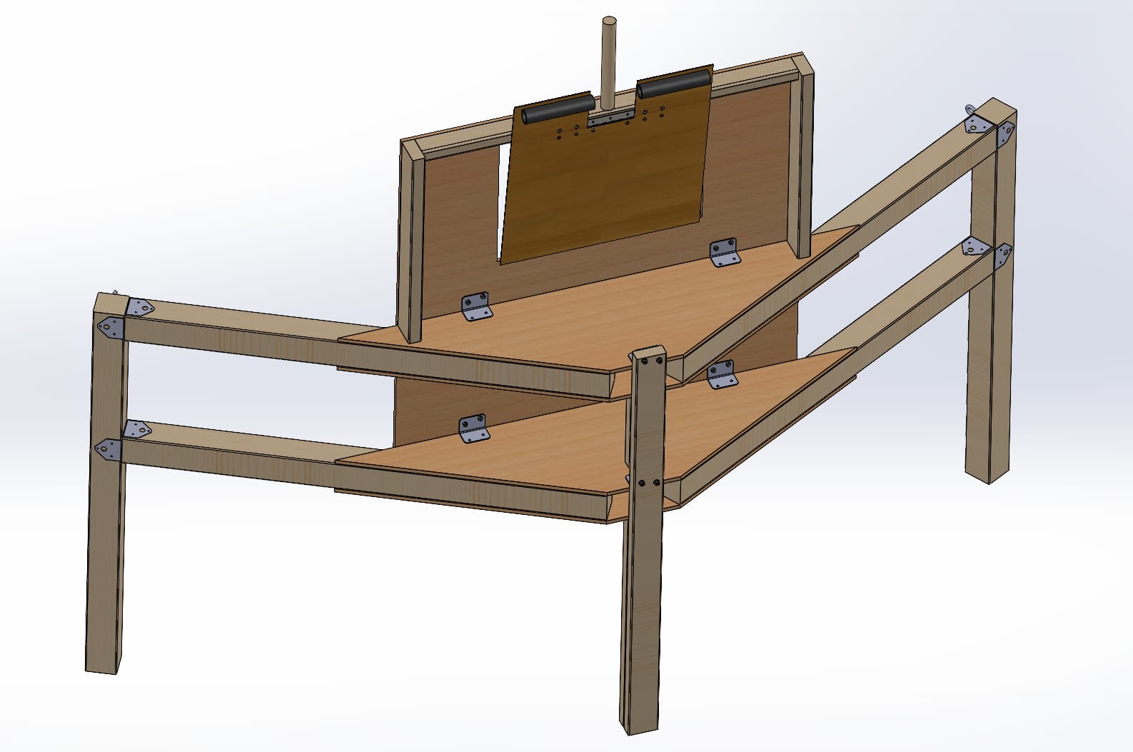

Does not appear to be possible to actually score on the team version of the trap as designed.
Notice there is no slot/clearance on the strengthening gussets for a Note to pass out of the robot/trap flap area.

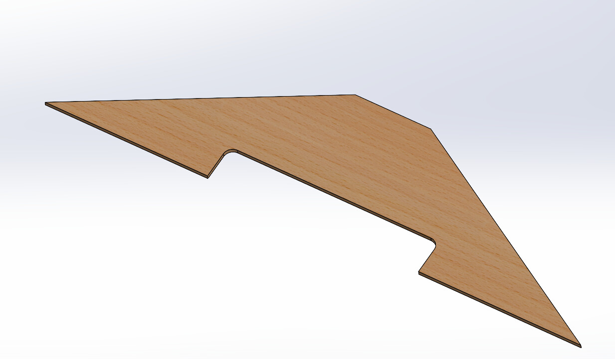

We’ll likely be adding a notch cutout to ours to allow notes to actually simulate being scored. Design very WIP.
