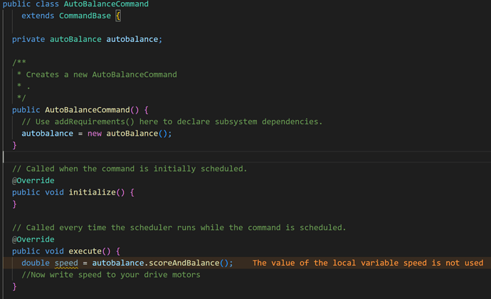

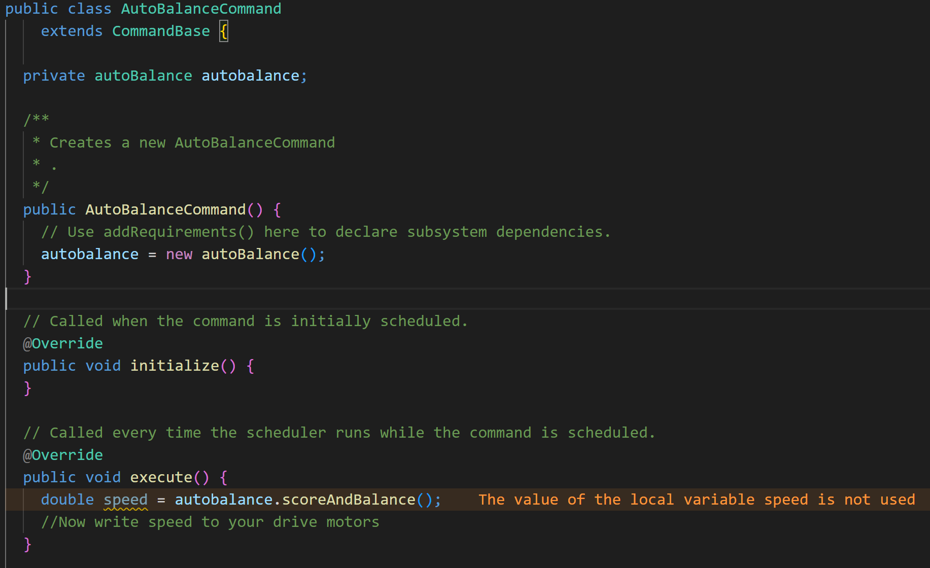

Me and another team at the competition I’m in are having some difficulties trying to get it to work in command based structures can you show an example of how to get it working in command based?
I believe it should be as simple as creating an autoBalance object in your command. And then in execute(), call it like the other example, make sure you set your motors to the speed. I didn’t in the example below because I wanted to give you a quick answer.

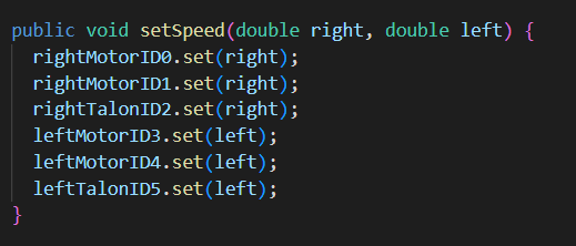

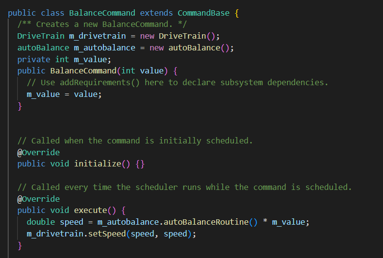

So I have it basically exactly the same as you just slightly changes setSpeed() command due to our drivetrain. I have also just changed the autoBalance to extend SubsystemBase. It will drive the right side but the left doesn’t move.
You mentioned one side moving but the other wasn’t. In your code you give the same values to both sides. Maybe the issue lies somewhere in the motor controller you are writing to. What happens if you just put a constant like 0.2 in your left side motor write. Make sure the wheels are off the ground when testing. Does the left side spin?
I got both sides doing the same now I don’t remember what I did to do it but I am still getting a motorsafety saying that it isn’t updated often enough. Every other drive based command we have works I think it may be something with the setSpeed command.
If I recall, motor safety happens if you don’t when a motor write doesn’t happen every frame. Could be caused by the score and balance being expensive. Latest commit should have more efficient code

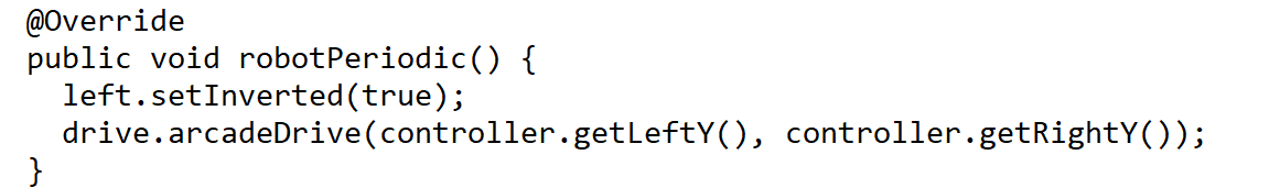

I made a new timeBased specifically to remove all variables no longer have a motorSafety however it only twitches the wheels. I should also note our rio is mounted vertically and upside down.
Having a motor write in your RobotPeriodic, and another in autonomous periodic will do this. Every frame you are setting the motor to a value and setting it to zero, causing twitching. Move the contents of this function to TeleopPeriodic
