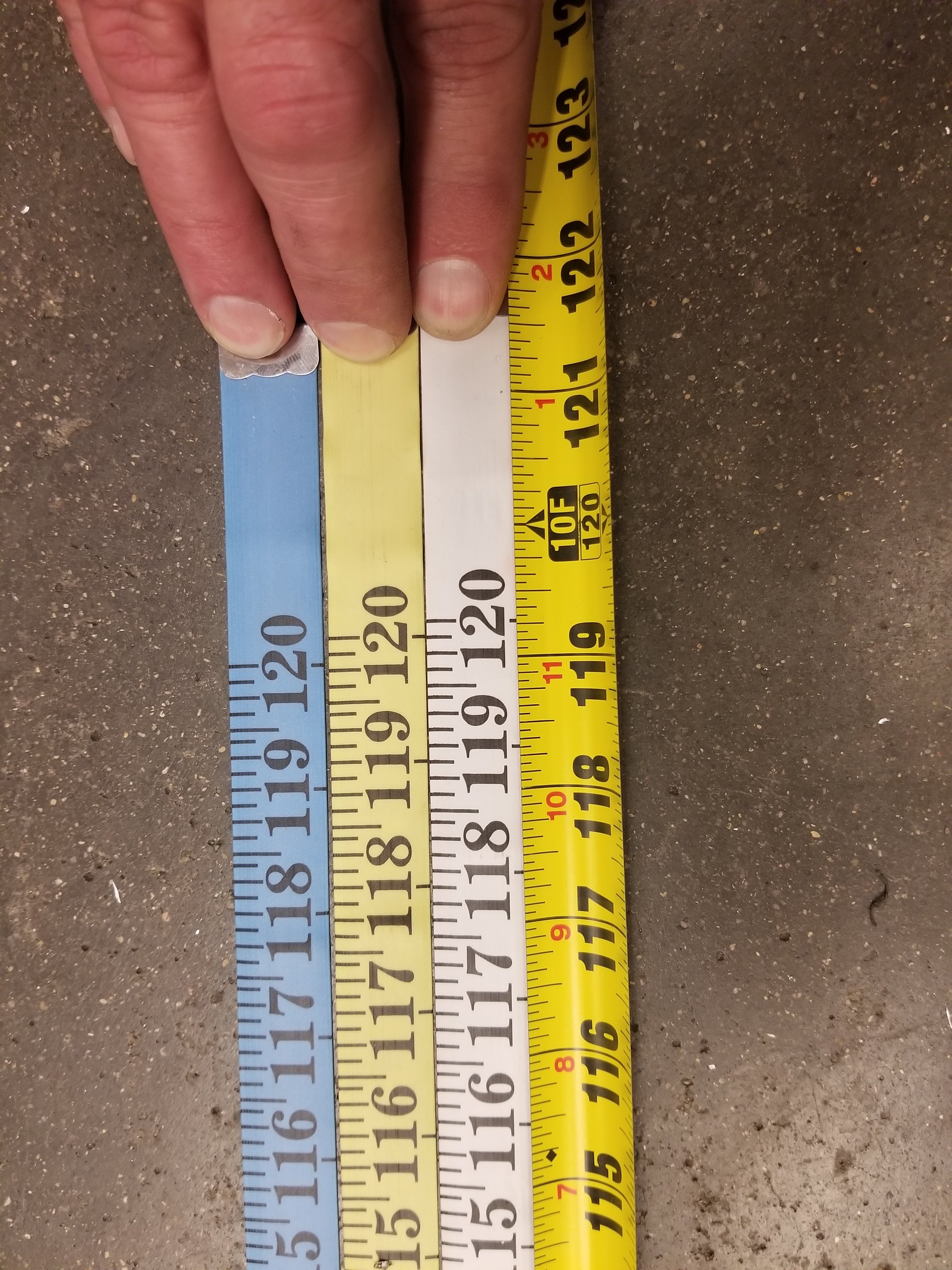

It is my understanding that Robot Inspectors are under the directive to measure frame perimeters with a flexible tape measure. This is how I’ve seen it done in the past, and the LRI’s I’ve talked to implied that the same would be true this season.
We bought ourselves a few flexible tape measures so we could ensure our frame perimeter would pass inspection, since we’ve had issues with being right on the edge in previous years. We never really learn that we shouldn’t design our frame perimeter to be exactly 120"…
Well this year we finally learned and decided to design our robot with 119.5" perimeter. We got our frame put together yesterday and measured it with our flexible tape measures to ensure we were under the limit… and to our shock we measured at 120.5". A bunch of finger pointing went on, some blamed our modeling software, others claimed that the drive rails were fabricated incorrectly, and ultimately people were pretty much freaking out.

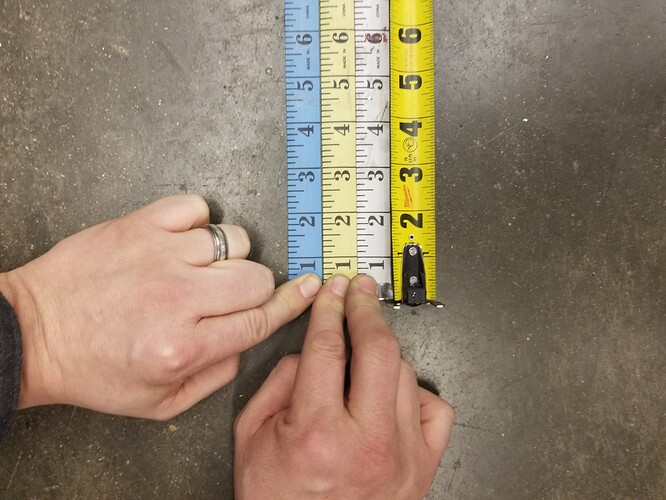

We knew we designed this thing to be under, so it made no sense that we were oversized. We decided to use another flexible tape measure with the same results… then we decided to take a regular tape measure to measure the perimeter… and we found it to be 119.5"

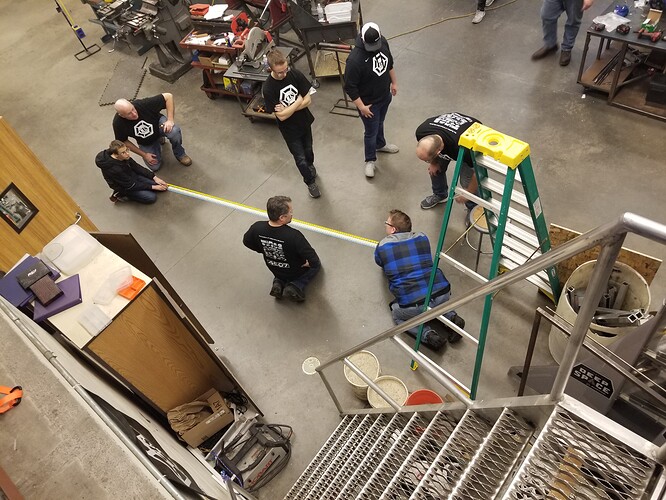

So we laid all of our tape measures out as shown in the pictures below and found some pretty significant differences between the measurements. In these pictures the flexible tape measures are stretched as much as they would stretch, and still weren’t close to the measurement of the standard tape.
Obviously flexible tape measures have been used for years to measure frame perimeters in FRC. This issue would’ve been brought up many times over if it were more prevalent.
We decided to measure our 2019 robot’s frame perimeter since we had some issues passing this part of inspection at each of our events last year… we even had to bevel the corners of our robot to pass inspection at Champs. When we measured with our standard tape we found out we were 1/4" under the limit, and shouldn’t have had any issues passing inspection. I suspect somebody didn’t pull their flexible tape measure tight enough when measuring our robot at champs last year.
TL;DR: Flexible tape measures can stretch, and this introduces a variable that can make or break the legality of a team’s robot. Inspectors need to ensure they pull their flexible tape measures tight when measuring frame perimeter. Teams should take this into consideration with their designs and not design up to the maximum size, for many reasons.

Those flexible tapes have the opposite problem of stretch (which really would not be a problem for oversized teams anyway); those tapes have nonstandard inches. That much variation can maybe be blamed on qc at the factory but it’s a good reason to be extra careful.

The difference between the design goal and the limit is less than 0.5%. What is the accuracy of the manufacturing processes your team is using? What is the tolerance of the measuring instrument? In my metrology course, I was taught that one must take into account the accuracy of the measuring instruments as well as the desired accuracy of the product from the specification when doing the design work.
As @anon91718515 stated, it looks like either the flexible tape measures have shrunken relative to the steel one or the steel one stretched significantly (improbable).

Those Starrett tape measures are steel. Would they go around the corners of a frame? Neither the Specifications section nor the Bulletin 664 gives any sort of accuracy specification.

Starrett also sells fiberglass tapes. They aren’t as flexible as tailor’s tapes but they are at least accurate

If that had happened, I expect we would have asked for a re-measurement as the tolerance on a long bar of versaframe is pretty tight and there would be no way that an accurate measurement would produce that kind of reading. I’m not sure what recourse you have if their “official” tape measure is not accurate, but if you can show that it measures accurately using another commercially available tape measure, I think you have a case for appeal. Honestly, I would probably point them to the pictures at the beginning of this thread as it clearly shows differences between the various measuring tapes. None of the tapes are calibrated in an instrument sense, but the metal tapes you buy at the hardware store are at least certified to an NIST standard. If the flexible tape does not have an NIST or ANSI certification mark on it, I think it is acceptable to question it.
