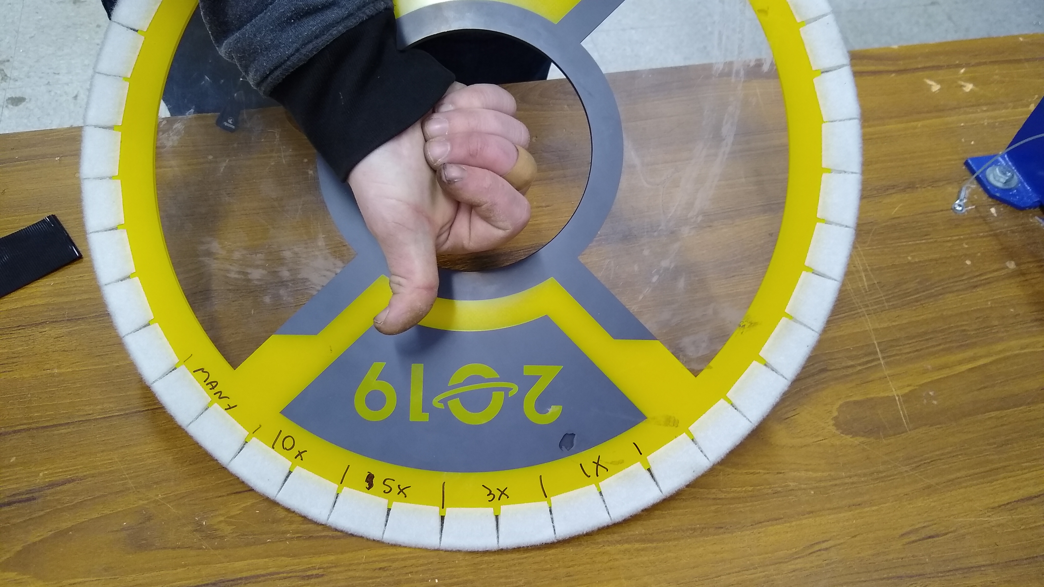

PSA, the cover velcro degrades. Could be a big problem
Our testing tonight showed a couple dozen removal cycles makes the panel almost fall off (when facing down) under its own weight. It appears that some of the loops break every detachment, because the damage is progressive. This is going to be a problem I think.

Can you give more details on the hook tape used that caused the damage & whether it matches any information provided by FIRST about the field hook tape?
We’ve got a few different styles at our shop, and they all behave very differently from each other on the panel and on the carpet.
When we say “damaged” is that visual damage? Does it still function, or are we talking damage to the function of holding on?
The 8" is suppose to represent the contact on both side, just a guess from memory so if someone has a more accurate number please provide.
Updating for 10% on low end and 20% high end still the question in my mind the question is if a patch on the hatch Velcro can withstand about 23 uses not likely a problem if can survive 84 uses definitely not a problem.
(By the way, my expectation is the good people at FIRST HQ are smart and already did some test like this and it passed the expected season full of use, or they have a plan. I remember going to worlds for stronghold and we had all new balls)
The “hook tape” is nothing special. It’s the Velcro industrial style (not the velcro “extreme” style) here: https://www.homedepot.ca/en/home/p.velcro-industrial-strength-4-ft-x-2-in-tape.1000112416.html
It gets progressively less able to hold on to covers. After a couple dozen cycles, with the cover hanging horizontally downwards from the hook tape, a slight acceleration is enough to detach it. It’s stronger when the cover is vertical and the velcro is loaded in “shear”.
