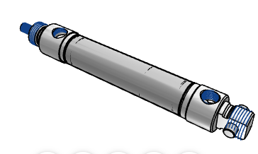

I was wondering how teams go about buying pistons? Do you CAD the robot and then purchase the pistons needed or do you have a set of pistons you use yearly and design your robot with those sizes in mind? If teams do have a stock of extra pistons that they use how did you decide what pistons sizes to buy and where did you get them from?

The teams that I’ve been a part of have always used the free Bimba voucher to stock up on three free cylinders every year, regardless of whether or not the rest of the robot has pneumatics. Here’s some specific sizes to stock up on as a long-term goal (do not buy all of these pre-emptively!):
3/4" Bore
1/2", 1", 2", 3", 4", 5", 6", 8", 10" stroke
1-1/16" Bore:
1-1/2" Bore
1", 2", 3", 4", 5", 6", 8" stroke
Edit: For all of these sizes I’d recommend getting the universal mount (with front threaded mount and rear pivot mount) and ideally with NPT ports rotated 90° (if ordering through Bimba):
The key item is to get at least 2x of each bore + stroke combination, as some mechanisms work best with two identical cylinders in parallel. I do not recommend using any cylinders that consume more air volume than about a 1-1/2" bore x 8" stroke cylinder, as you’ll likely run into issues refilling your storage tanks in the six minutes between elimination matches.
Once you begin amassing this library of cylinders, regardless of whether you design in CAD or not, you can either choose to design around cylinders you already have (preferred), or if this is not possible, then design around the cylinder you need (ideally one of these standard sizes), and then buy it as necessary.
Lastly FYI: the term “piston” only refers to the rod that moves in and out. The entire assembled unit is called a pneumatic cylinder.

Pretty much what @BordomBeThyName said. Calculate the needed volume, check stock, design around that or see what can be ordered for quick delivery and design around that. When using vouchers not for a specific purpose, get something with a volume not already on the shelf.
It also helps to build up an inventory of the mounting brackets needed to mount the cylinders and clevises to connect to the piston rods. Some of them use uncommon thread sizes such as 1/4" - 28 so it would also be good to build up a stock of those nuts.
