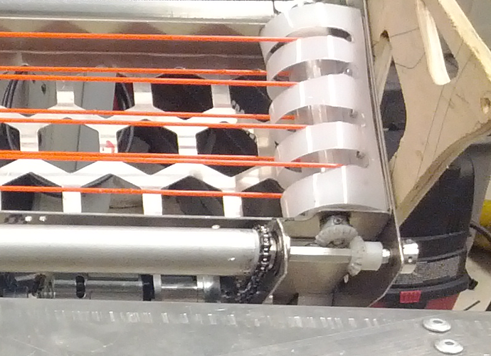

I looked for a good belt comb pic.
Here’s a cropped picture of a belt comb on our practice robot. It’s thin polycarbonate rolled around the roller and riveted, we neglected to take the film off of the polycarb so it’s white.
Our belt combs inside the robot (where both rollers need to contact the ball) usually cover only the top (non-contacting) side of the belt and don’t go around the roller.
These belts were under a lot of side load, so we needed a lot of combing to keep the belts on track. We actually didn’t rivet the spacers on the other side so the belts can walk as they please under load and move back into shape when the ball has passed.
Basically what Andrew said… The belt comb in his picture is pretty unconventional as it goes all the way around the roller.
More commonly one would use something like my attachment…
We usually use thin polycarb for ours but I have seen them made out of lots of different things.
The reason that we call them belt combs is because the applied piece we make looks like a comb before it is bolted on.

Edit, In the second above picture by sportzkrazzy towards the top there is a clear piece that doesn’t go all the way around the belt but still looks like its serving the same function.

Here is the best picture that I have of the belt comb that my team used. It is just a piece of plastic with notches that the belt runs in.

We never really had a name for it but yeah that’s pretty much the function that is served. We just used a piece of Lexan that we bent in order for it to keep its shape and maintain strength rather than going all the way around the cord. Two rivets a small piece of lexan and 30 sec on the brake and your done. Simple and lightweight whats not to love.
We used simple PVC tubing from the store, and added a couple of “combs” to keep the belts straight. The combs were just pieces of polycarb with notches cut in them for the tubing. We placed them relatively close to the rollers, and didn’t have a single issue with our belts all year (2 regionals, 2 off season competitions, a competition at the State Fair, and a few demo’s that saw the robot running almost continuously for an entire day).
