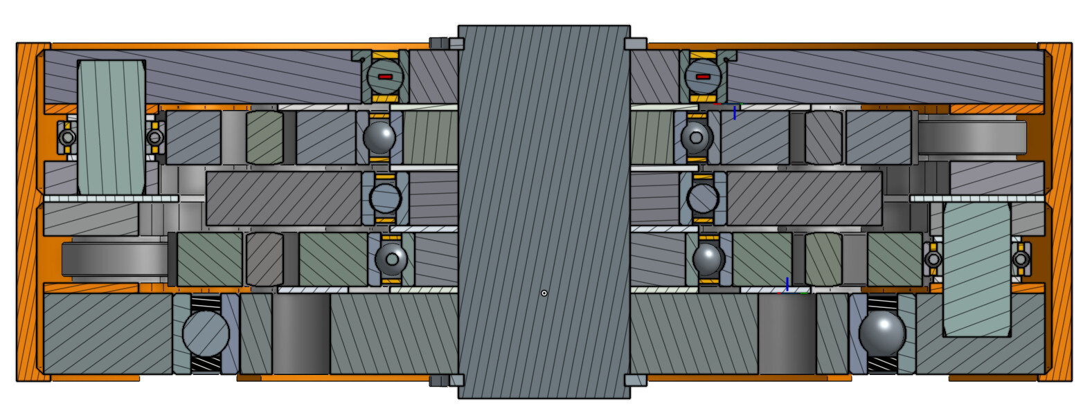

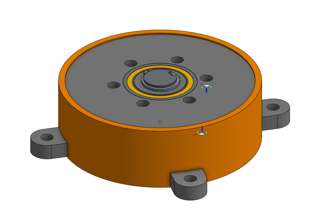

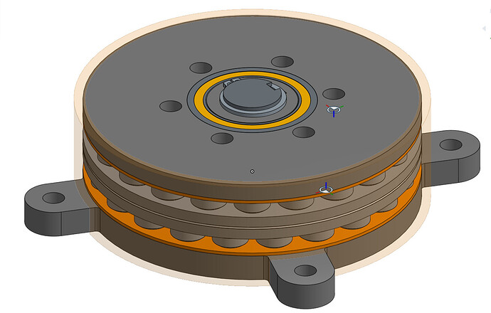

Spent the better part of 8 months on this project. Backlash issues had a significant hand in killing our 2023 bot, Voyager - a 2 jointed arm design - so I decided to see if I could stick a few nails into backlash’s coffin. Behold, the PyreCycloidal! Named for nothing in particular, I just like fire themes.
Dimensions
  • Body OD: 78mm
  • Mount OD: 102mm
  • Thickness (face2face): 24mm
  • Total thickness: 27.556 mm
Details
  • 400:1 reduction
  • 1600 N*m max allowable torque
    • If I did my math right… would appreciate a double check
  • Sheet metal construction (allowing use of 2.5d machining)
    • For US-standard sheet, requires a facing cut (unfortunately)
    • Hardest op is a series of blind holes used to hold retaining pins, although these can be replaced w/ throughholes assuming there’s not much axial load
  • ~$85 (minus shipping) for non-sheet materials, comparable to COTS options (ish)
    • We recommend getting the MR85ZZ and 693ZZ ball bearings from a Chinese supplier
    • Alternatively, said bearings can be substituted for bushings (but this will impact efficiency & max allowable torque)

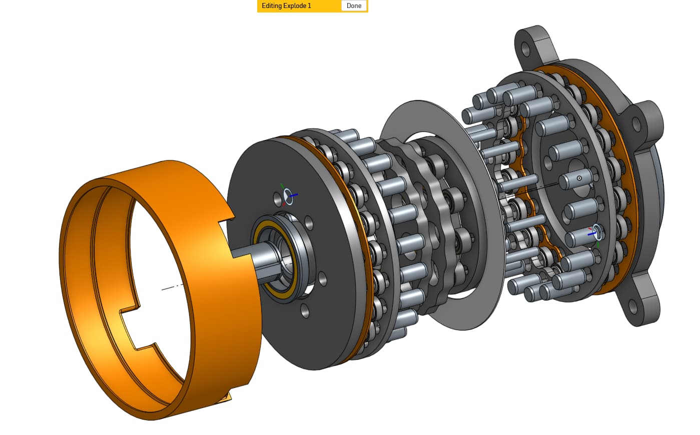

I’ll have fun looking at this later. Excellent design, getting the weight down to under 1lb is very impressive! The hardest thing about cycloids, apart from the huge BOM of pins and bearings, is the weight and size. It seems like you could cut down on the BOM by milling all of the pin profiles out of a single steel sheet, though this could increase the weight.
Seriously cool design work, must have learned a lot in the process, bravo.
I had thought about this, but getting the proper end profile for them to fit in the sheet & getting the correct tolerances (the pins are oversize, for press fit) would have made the design pretty inaccessible.
The largest influence on the BOM is actually the ball bearings! I had considered jumping ship to a more novel type of reducer called an “abacus drive” which eliminates ball bearings from the BOM entirely (in favor of bearing balls), but it would have required cutting & hardening custom races, which just didn’t seem achievable with 2.5d machining.

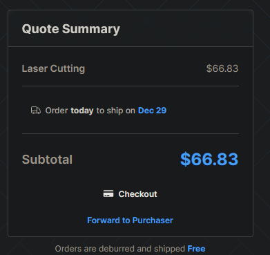

Also, ordering the aluminum pieces from Fabworks. Cost comes to about $66 for all the aluminum plate (note that some post-processing is needed for blind holes, etc)
