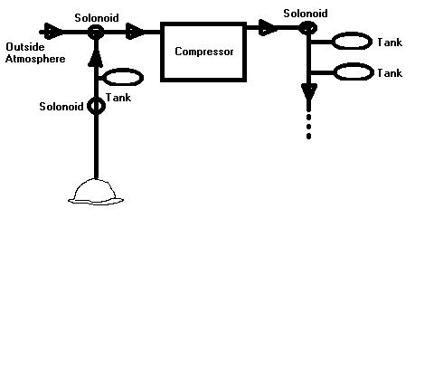

If you were wondering about creating a vacume, u could reverse the compresser, except i would require some extra programming and solonoids, and alot of testing. My idea is that you use the intake, attach a solonoid, then have an tank outside the system. This way just switch the solonoid, then it will sucl the atmosphere out of the tank. Then from there add another solonoid that would open that tank to the suction cup. As for the suction cup, i would suggest using a silicone type. That is if silicone is legal, im still not sure…
I created a diagram if my speech was confusing. This might help…
M12:
Only the allowed air cylinders may be used to generate vacuum.
That basically means you just have to back-drive a closed system. Shouldn’t be too bad with the plethora of motors we’ve got.
