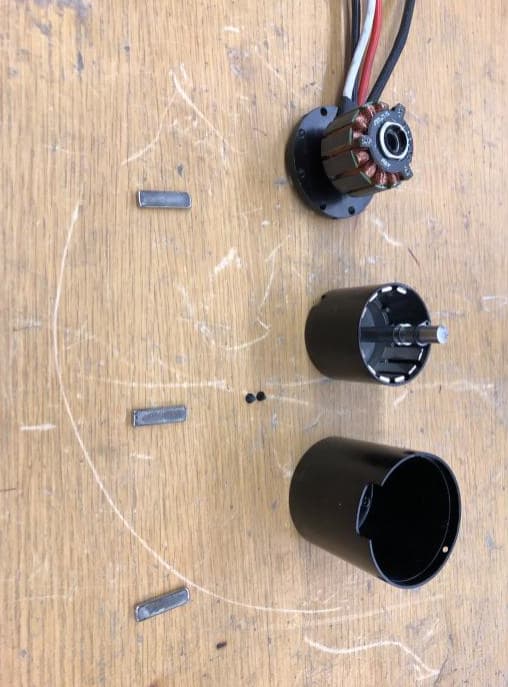

Hi everyone, this past Saturday we were driving our robot and our arm gearbox made a very loud groaning sound it turns out the the NEO controlling the bottom joint of our arm had seized. luckily there was not a ton of damage but we were unfortunately not able to continue driving the robot. we took the robot back to our shop so that we could put our spare arm on so we could keep testing. we puled apart the other gearbox so that we could do some more investigation and we discovered that the actual gearbox was luckily fine but the NEO was completely seized. We took apart the NEO further to keep investigating and when we removed the outer shell we were able to turn the motor with a considerable amount of force. It was also making a clicking sound that was definitely not normal. after removing the core of the motor we discovered that three of the magnets had come out of position. We think that this was a quality control issue because we have not had this issue with any other NEOs even though we have run them much harder than this case. We are planning to contact REV to see if we can get it replaced. Has anyone else had a similar issue?

This is a potential issue with nearly every brushless motor, because the outer magnets are usually glued to the shell and a hard impact (like your robot slamming down on the floor) can break them loose. We’ve seen this failure in both falcons and neos (though never 550s), and I’ve just chalked it up to the stresses we put them through.
Difference being, when this happens to a motor without a motor controller built in, it’s much less of a cost issue.

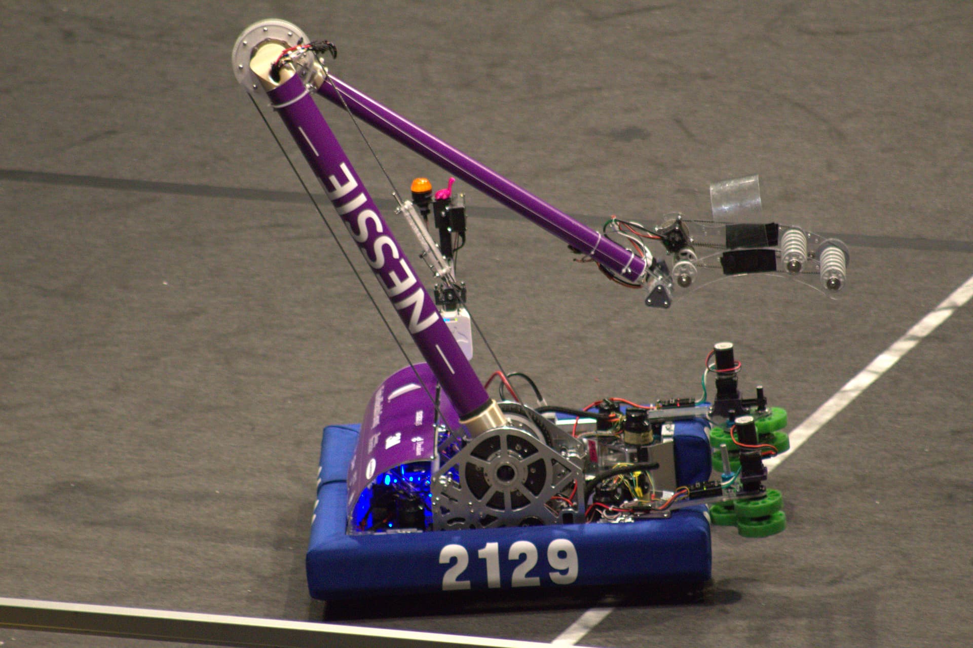

this is a picture of the robot at Northern Lights. the motors are at the bottom of the gearbox and the one for the bottom joint is on a 600:1 ratio while the top joint is a 300:1. in our testing the only time they have gotten warm is when they have already failed and there is a crap ton of resistance. we don’t think that that load is unacceptable because we made absolutely sure the math was right this year because we know what happens when you get the math wrong.

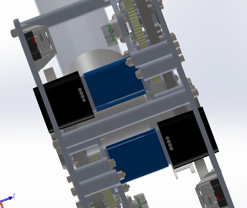

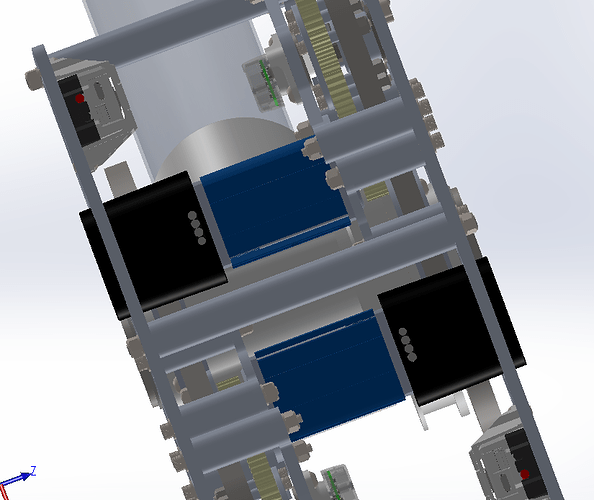

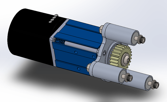

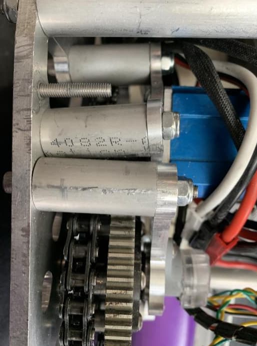

It looks like your motors aren’t being used in environments which would easily break the magnets loose. Are your motors experiencing any larger than normal vibrations over extended periods of operation? Could you share a closeup of how your Neos are mounted to the gearbox?
So last night we rebuilt our arm again because of our issues. we decided to open up the last v1.1 neo we had and the BRAND NEW motor had magnets we could move around with just our hands. we did the same with a dead motor from last year (so a v1) and we were able to remove the magnet but not without a screwdriver as a chisel. attached is an CAD image of how the motors are mounted to the gearbox. the CIM sport gearboxes are a 100:1 and a 48:1.
these are the best pictures I can get but let me know if you have any questions about it

EDIT: it’s actually almost funny how good OPs design is here. Throwing the motor directly into a COTS planetary it such a good way to protect the motor, and the gear ratios themselves are very high. The arm is driven in a way that minimizes backlash too. Just a really good design.
