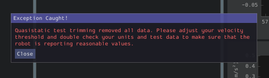

Quasistatic test trimming removed all data error
We are currently running into this error constantly and are unsure as to why it is happening.

Hi, I have no experience with this, but I took a dive into the code to see if I could offer you any breadcrumbs.
That error message is generated by this WPILIB code:
allwpilib/sysid/src/main/native/cpp/analysis/FilteringUtils.cpp at v2024.2.1 · wpilibsuite/allwpilib · GitHub
There are two possible reasons for that error. One would be if the values for voltage or velocity reported by the log callback are confusing to the code; that is, your code on this line:
To probe that, I’d print or write to network tables or somehow inspect what you’re returning at that point in the code and see if the values look rational. I looked at your code for converting velocity and distance and didn’t see anything obvious.
The second reason could be that the velocity threshold is too low. I think that’s something you set in the characterization program itself. My naive google hunt returned this page:
I hope that helps.
I was having a very similar issue yesterday. Not sure if it’s the same root cause though.
this appeared to have worked. THANKS!
