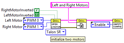

Howdy, probably going to be asking questons a lot cause big help. So currently we have our roboRIO working, and Radio. Our current challenge right now is to get out motors working, we have them plugged into the roboRIO. it’s just how do I program through LabVIEW to get those motors working?

@RoboTigers7892 I recommend you check out the LabVIEW Example Template and examples that ship with it. Basically, you will be opening the references to your motors in Begin.vi:
12%20PM

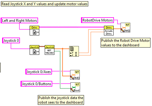

You will move your motors in Auto.vi and Teleop.vi
34%20PM
