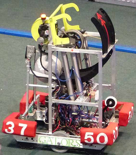

I don’t have a picture but we did it in 2016 where one set of pneumatic cylinders lifted the next to reach the rung in stronghold
You can kind of see it here. They were stacked. If this is even what you are talking about.
Were thinking about something similar to this to carry a hook up to the bar

I think this is the design we should have used for ours. Vertical four bar to place the hooks up in the air, then a winch to pull them down a bit to lift the robot.
Doubling the stroke length using two equal cylinders, mounted to each other in opposing directions is pretty straightforward. Doing much more than that gets a bit dicey.
Also, pneumatics are not the best choice for climbing. Pneumatic systems are inherently inefficient: the compressor creates almost as much heat as potential energy, then the regulator throws half of it away, and if you’re doing double-acting, you’re using way too much energy to do the easy stroke. Over time, my own rule of thumb for FRC is that if something takes much more than 10 or 15 cubic inches of cylinder (50-75 ft-lb of work after multiplying by a safety factor), there’s probably a better way.
Pneumatics might be a useful way to deliver a hook or two to the RUNG, and let a winch driven by another motor or two turn the winch to lift the robot.
Lifting the full robot weight with pneumatics is a dicey proposition.
