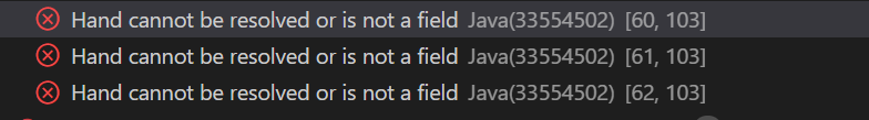

Hi , in WPILIB 2022 , how can l use the XboxController.
In the WPILIB 2021 , l use it as below.
However , when l import it to 2022 ,
How to solve it?

The other way (at least how we have done it in the past is to import Hand.
edu.wpi.first.wpilibj.GenericHID.Hand
You can also use ....getRawAxis() or ...getRawButton()
Hard to tell, what class it the drive_motor_ did you get the 2022 versions of phoenix and rev dependencies?
GenericHID.Hand was removed for 2022, and replaced with separate getLeftX and getRightX etc methods.

Most of the changes were just replacing getXxx(Hand) methods with getLeftXxx() and getRightX() methods. In the case of Xbox trigger axes, I think what you’re looking for is getLeftTriggerAxis() etc.
Other changes in the same PR include adding a PS4Controller class and making GenericHID concrete with only getRaw...(int) methods (the getX etc methods were pushed down to the appropriate subclasses).
