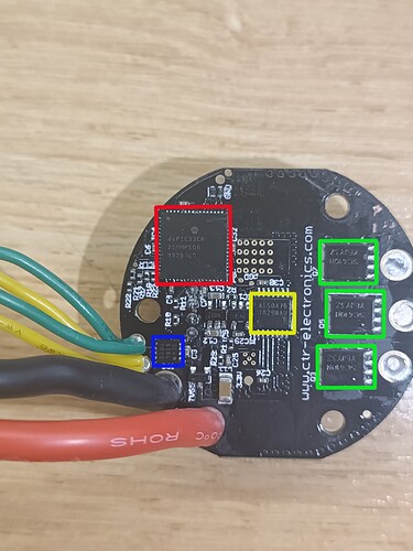

I’m wondering if anyone ever take CANivore and CANcoder apart and looked at PCB.
On CANivore, there is a CAN controller printed with DADT1436,
on CANcoder website pic, clearly shown DADT1428,
on CANifier it shows DADT1428.
DADT seems to be a MCP2562 CAN 2.0 Controller from Microchip (or Atmel at the time it was designed).
For those don’t know, CAN FD is next-gen of CAN 2.0, Lower bus utilizations, Larger frames, 8Mbps vs 1Mbps…according to CTRE website.
I’m wondering how did CTRE manage these CAN FD feature through a CAN 2.0 controller chip? Is it worth to invest CANcoder and CANivore? What extra feature I would get from Phoenix Pro through the CAN FD upgrade?
Thanks for the help from XiaoBai and Mr. Hao for exposing the PCB !
The CAN PHY chip used in TalonFX is DADU, which is same chip in MCP2562 series.(The blue box in the picture.)
Is DADU only used for MCP2562, or could it also be used for a similar CAN FD transceiver in the same family?
No, only for MCP2562, you can found that in MCP2562 datasheet.

For reference, all of the CTRE devices I can see have MCUs that support CAN-FD (I had to open PIC datasheets to reference this. Day ruined). However, I can’t tell if the transceivers support the higher data rate. Maybe they do? Or maybe they can run higher then their spec?
very interesting. If they’re really using DADU (MCP2562) instead of DADY (MCP2562FD) that’s surprising. The bus might work anyway at 2-5 MBPS bit rates but the specs are clearly better on the FD variant. In particular the loop delay time is marginal for bit rates >2MBit on the non-FD version. Some parts might work, others might give issues as they get hot.

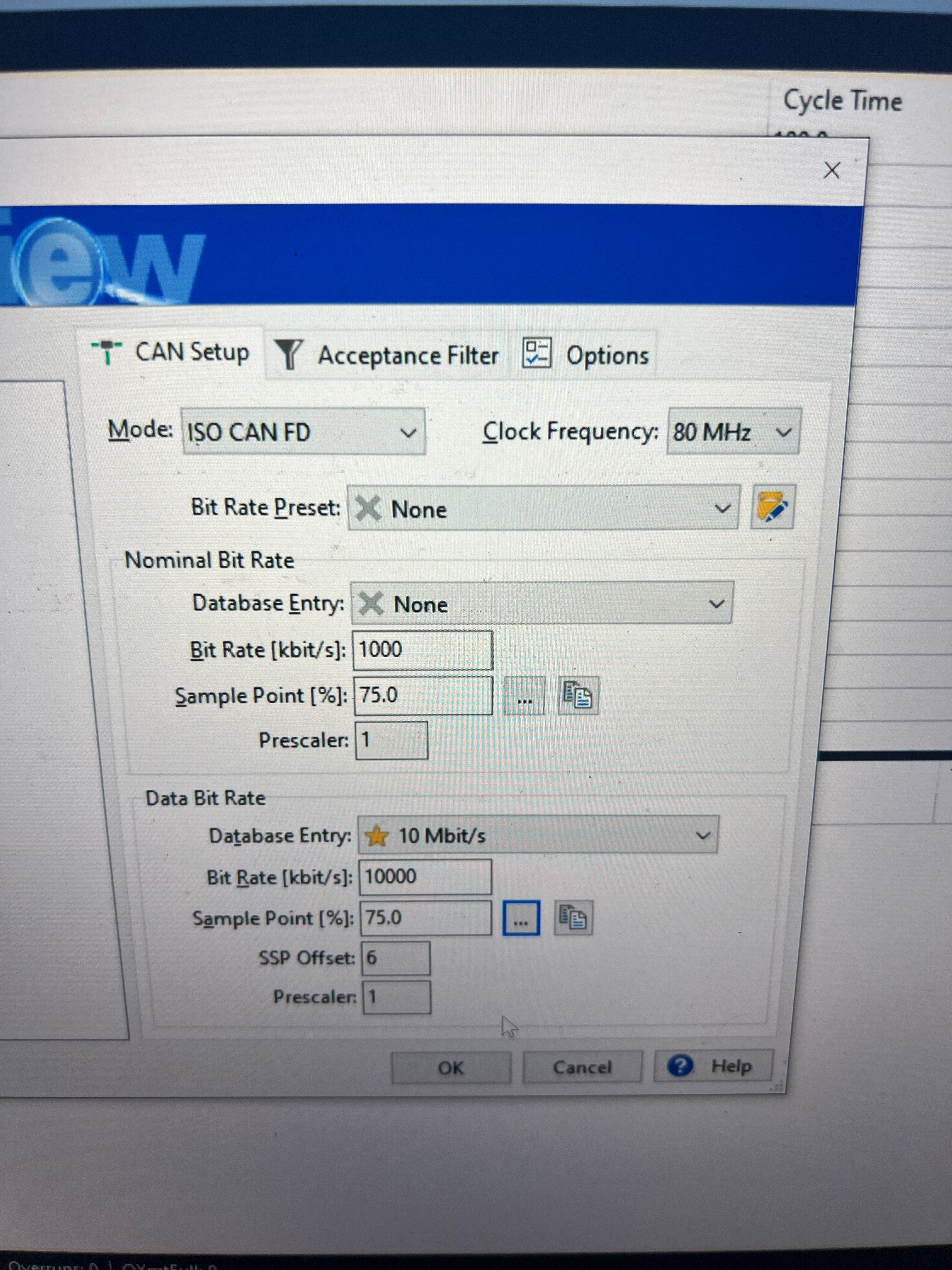

I don’t know what you people are on about but what I can tell you is that with my IPEH-004022 CAN FD adapter, I must set things to 10mbps to see traffic and talk on the CAN FD bus that CTRE devices use.
These are the specific settings that must be set (please note that this photo and this entire thread are a loaded foot gun for anyone not knowing what they are doing):
OK, wow. CTRE is running CAN FD at 10 MBit FD data rate. That seems ill advised. The specs on the DSPIC only go up to 8 MBit FD rate. Heck, the CAN FD standard only recommends 8 MBit. That is really outside the specs on the transciever.
Looking into the details it is possible to configure the DSPIC to run at more than 8 MBit. Really surprised that they’re doing this. Why are they pushing it so hard?

Thank you for helping check more MCU! I don’t have all CTRE devices but seems like the new FD series are using MCU with CAN FD. however as u mentioned the problem is on transceiver, my friend tested scope with CAN FD bus and results does not seem like 10 or 8 Mbps, more like 900Kbps (considering test condition, 1Mbps). There is a possibility that somehow transceiver could run faster, but not seeing that happen so far.
I will try to test more packet on MCP2562 and see the temp (never paid attention to temperature of transceiver chip, thanks for point out!)
We will get a FD adapter and try to see frames too, it would be interesting to see how CTRE run 10 Mbps with high consistency. Thanks for helping on test!
Did they look at the middle-end of the frame, or just the beginning? The F in FD means that the arbitration still runs at the 2.0 speeds. The idea is that you can have CAN FD-tolerant devices that just ignore the frame if the header (at normal baud rate) says it will be FD data.

We also use a data baud rate faster than 1 Mbps. (Marshall’s tool reports our data baud rate as 10 Mbps.)
