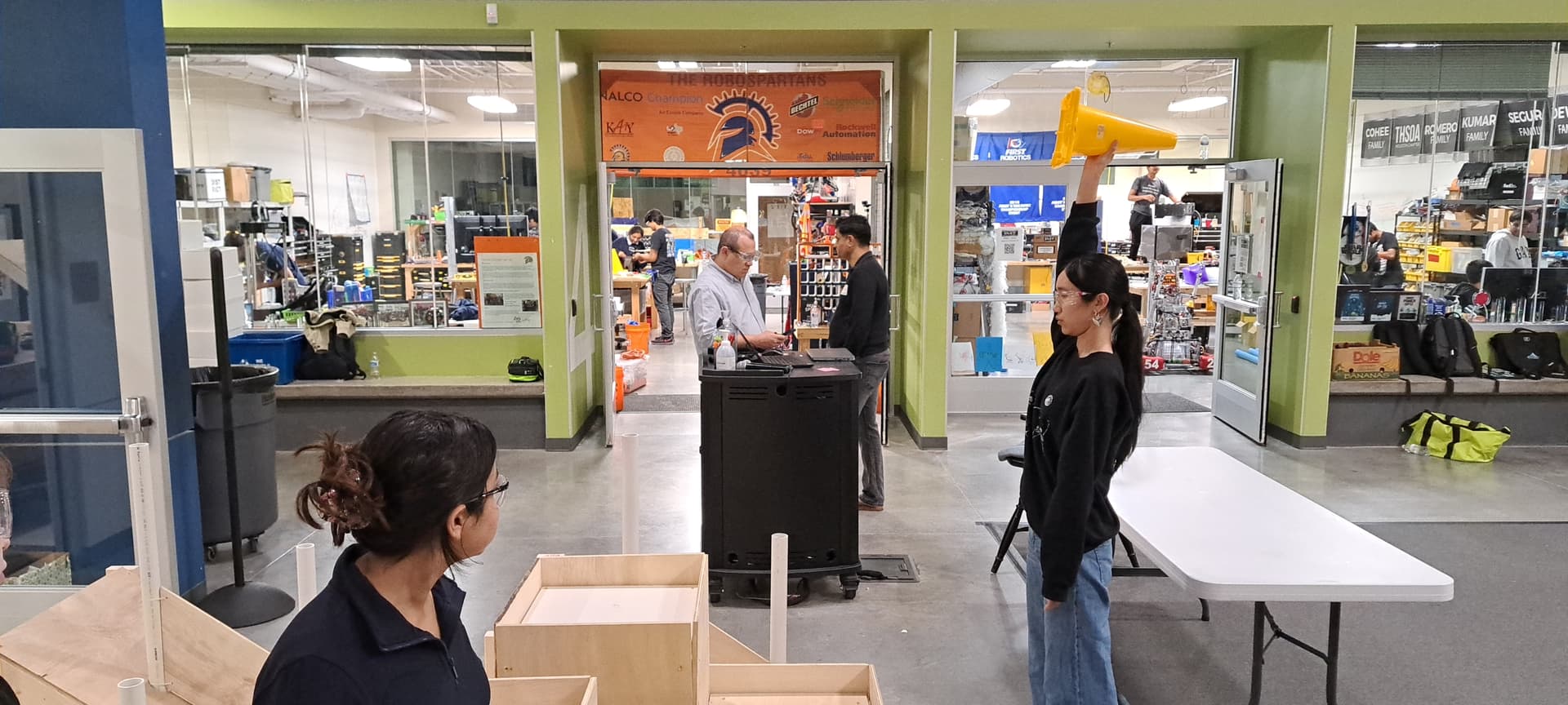

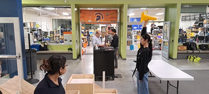

The cone appears pretty “dead”, with very little bounce. I saw a short video of someone “shooting” a cone onto the pole/node but I don’t recall who posted it.
Yes, i saw the cone vid too. We aim for being like 5cm away from mid node and just releasing it (we’ll have top and bottom rollers instead of sides)

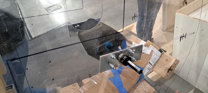

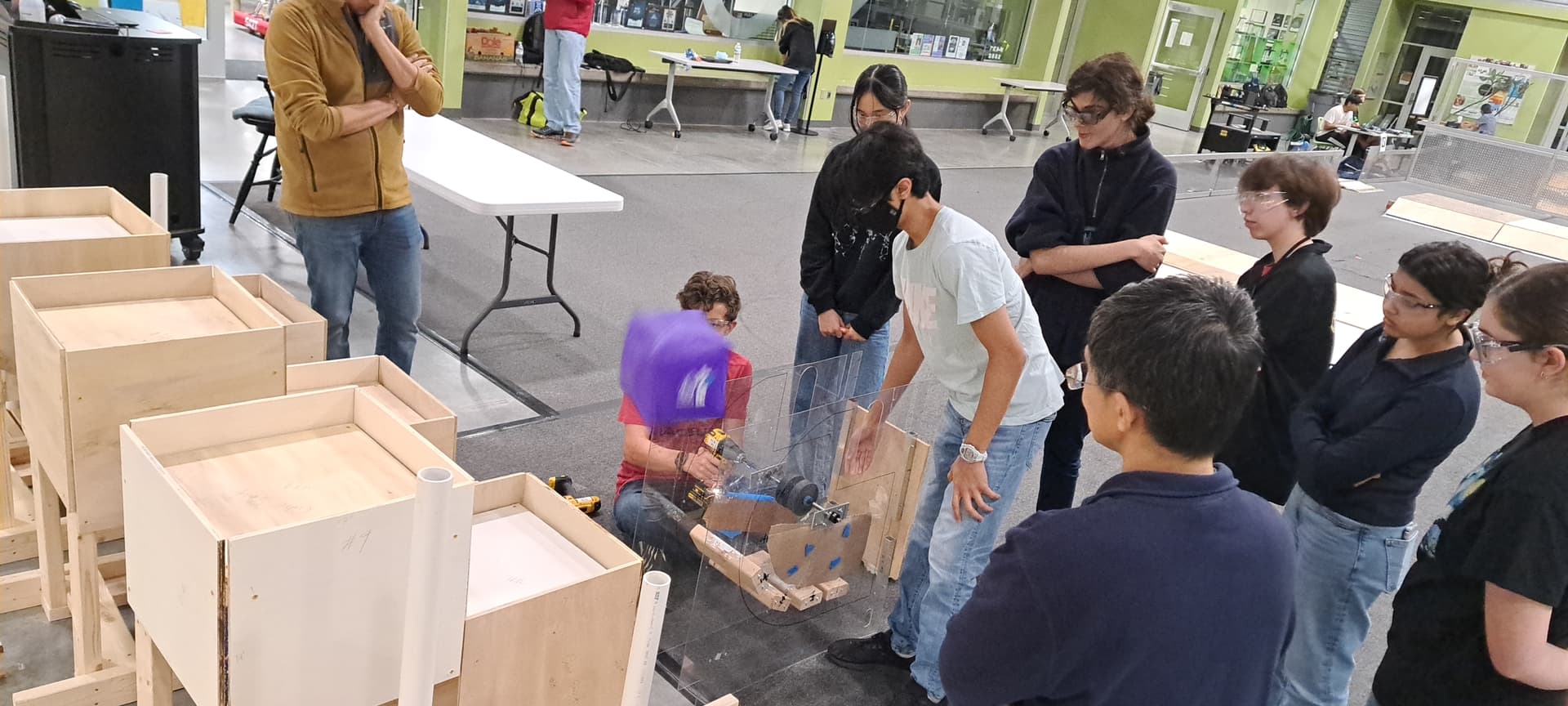

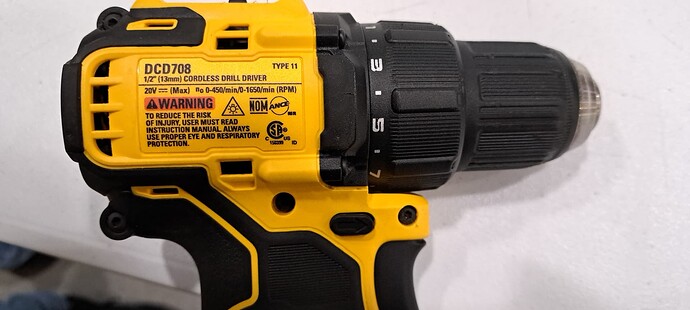

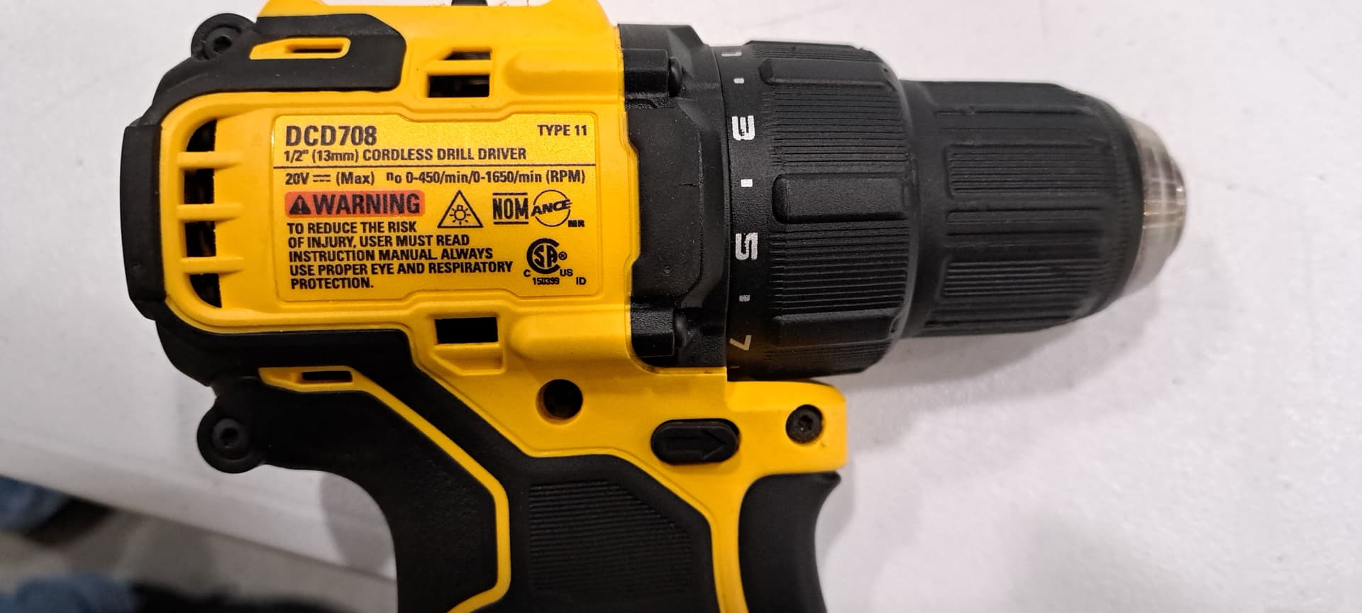

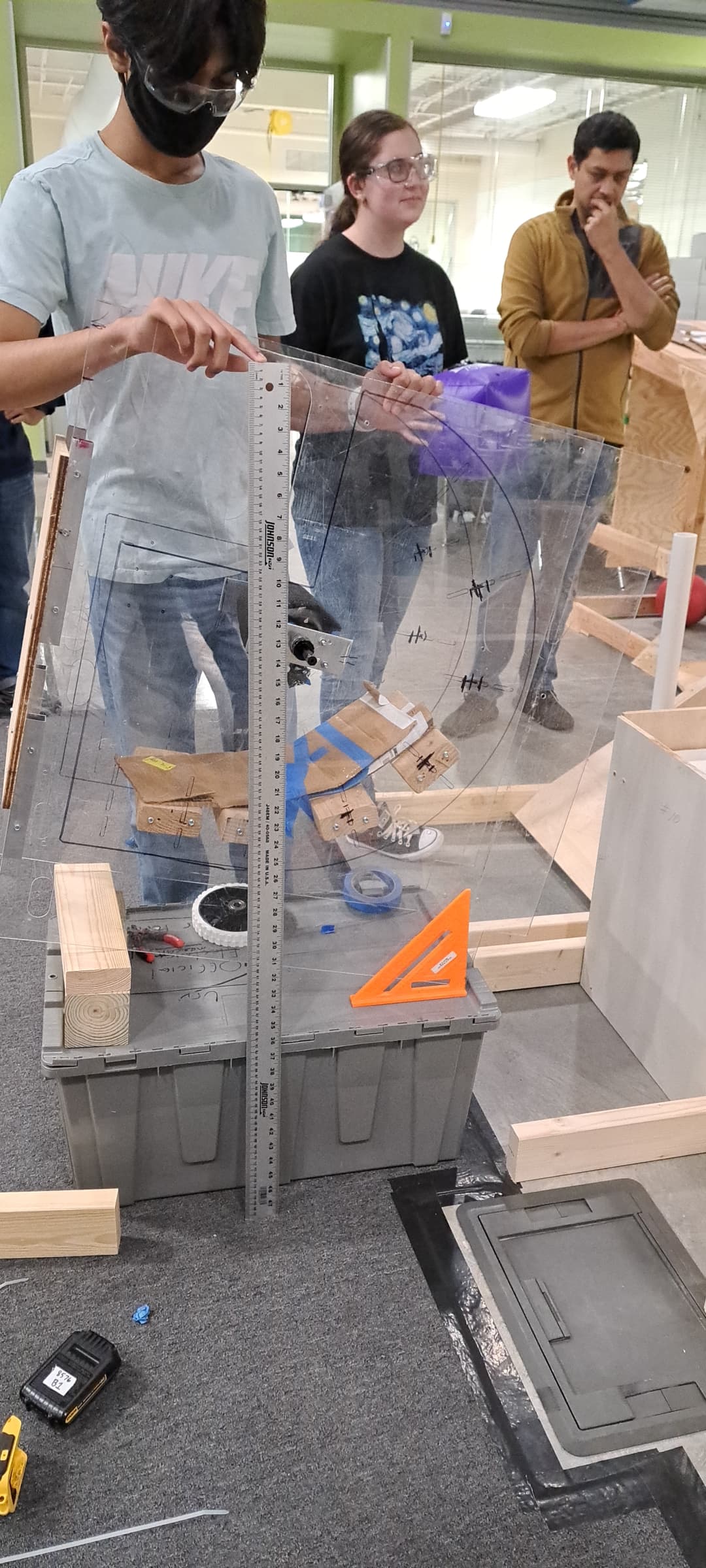

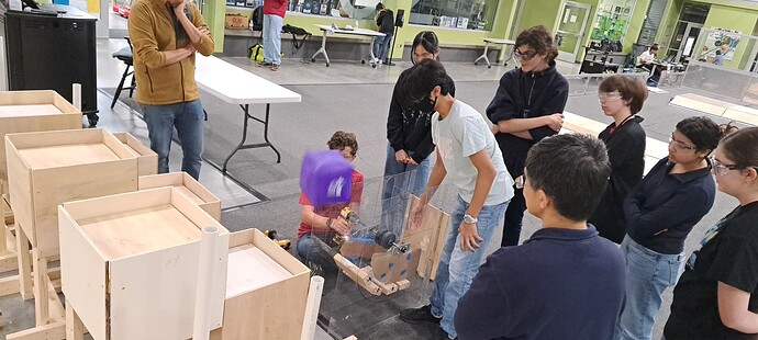

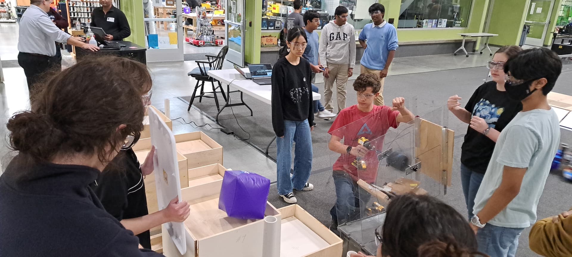

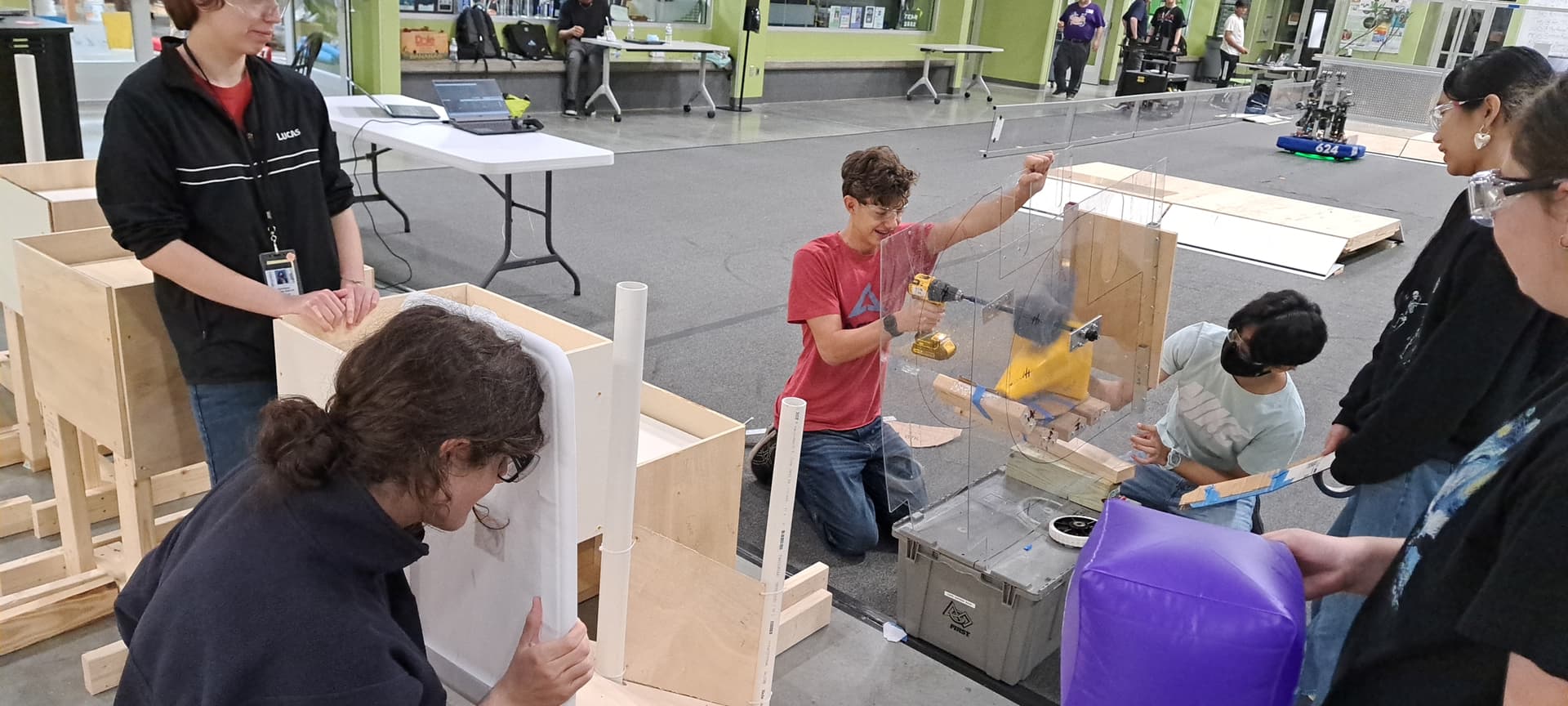

Yesterday evening, we used the prototype for shooting the 2022 balls with the newly finished Nodes at our STEM Center. We had to use our fastest drill to get it up to the highest level. We also had to add cardboard to pad the hood to get more compression. Later, they added some shelf-liner on the black compression wheels (stiffer than the green ones). We did not test consistency of the shot since the structure is rather flexible and we did not have good (consistent) speed control with the drill but most cubes stayed on the node.
Shooting the cone with this type of shooter did not go well at all since it would tumble. Their method of tossing the cone requires starting from quite high, maybe too high.
We think this may be a quick way to have a simple scoring mechanism that is fed from the single loading station, sacrificing floor pickup ability. We would prefer to use a pair of horizontal rollers on articulated arms since it would probably give a similar shot and could do floor pickup. Hope this helps.

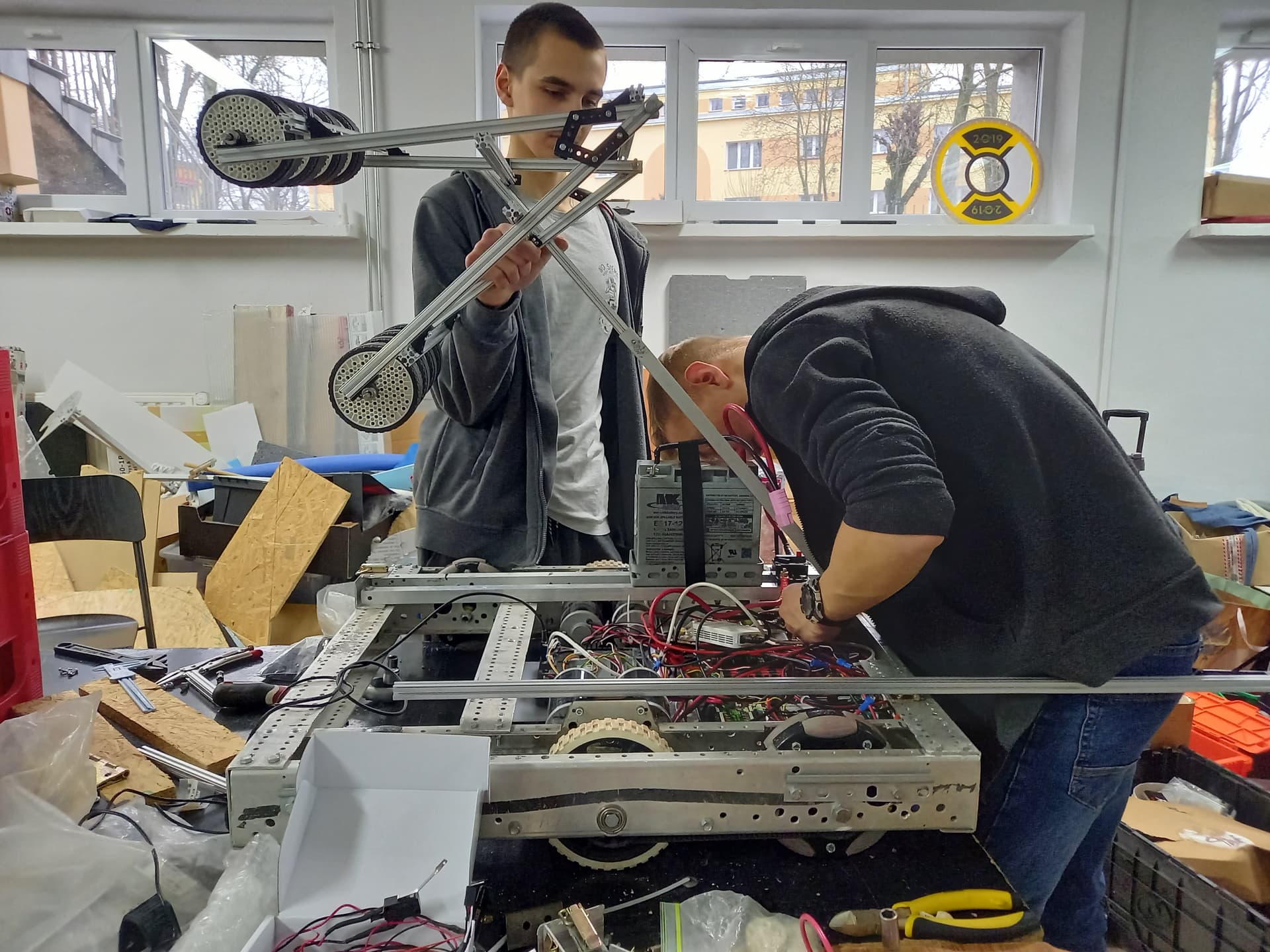

Nice! We aim for something like this prototype
That looks like what we would be aiming for. There will be a fair amount of force pushing the rollers apart when picking up a cone so you may want to add some bracing between the two arms.
The main thing we are fighting is power to rotate it. But we got a clever idea of putting rubber band to hold it to the top, so the motors have to push it down for grabbing the piece and the way up is easier because of the rubber bands.
Yes, i thought about it, but i think that 4inch compliant wheels will do the job, if not maybe something like cabinet air pistons
