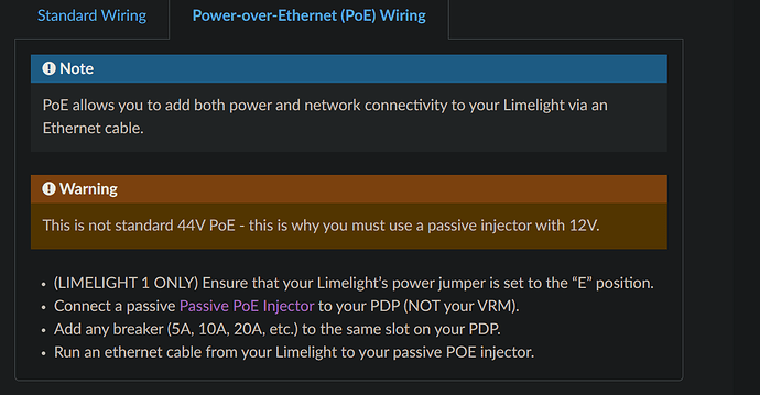

Limelight’s documenation has provided two methods to wire the Limelight on the robot. It seems that both methods will need a port on the PDP , which means the motors can be used will be 15. So , l wonder whether the Limelight can be wired without using the port on the PDP?
I have been able to wire one to the vrm before but it’s not as nice as when it is wired to the pdp
It is recommended by limelight to not use a vrm. You can power in on a custom circuit that includes other low power devices though
I’m not sure what you mean by this. All electricity on the robot must be sourced from the PDP (with a few exceptions that don’t apply here). You could plug it in to a VRM, but not the one powering the radio, so you’ll have to use a pdp port anyway (don’t do this, just plug it in directly to the pdp).
This is just a limitation that comes with using a limelight or other similar device. If you have multiple, you can use a rev MPM or similar to have them all on the same pdp port.
If you need the extra motors then a REV PDH might be what you’re looking for, as it contains a few extra slots compared the PDP.
We used a Rev POE cable that comes with the kop but that required us to get an adapter to connect the male ethernet end of the POE to the male end on the ethernet cable. Is there a better way to do this that we missed?

TLDR; Save a breaker space for a limelight: that’s the only legal place to power it from if you have a PDP.
