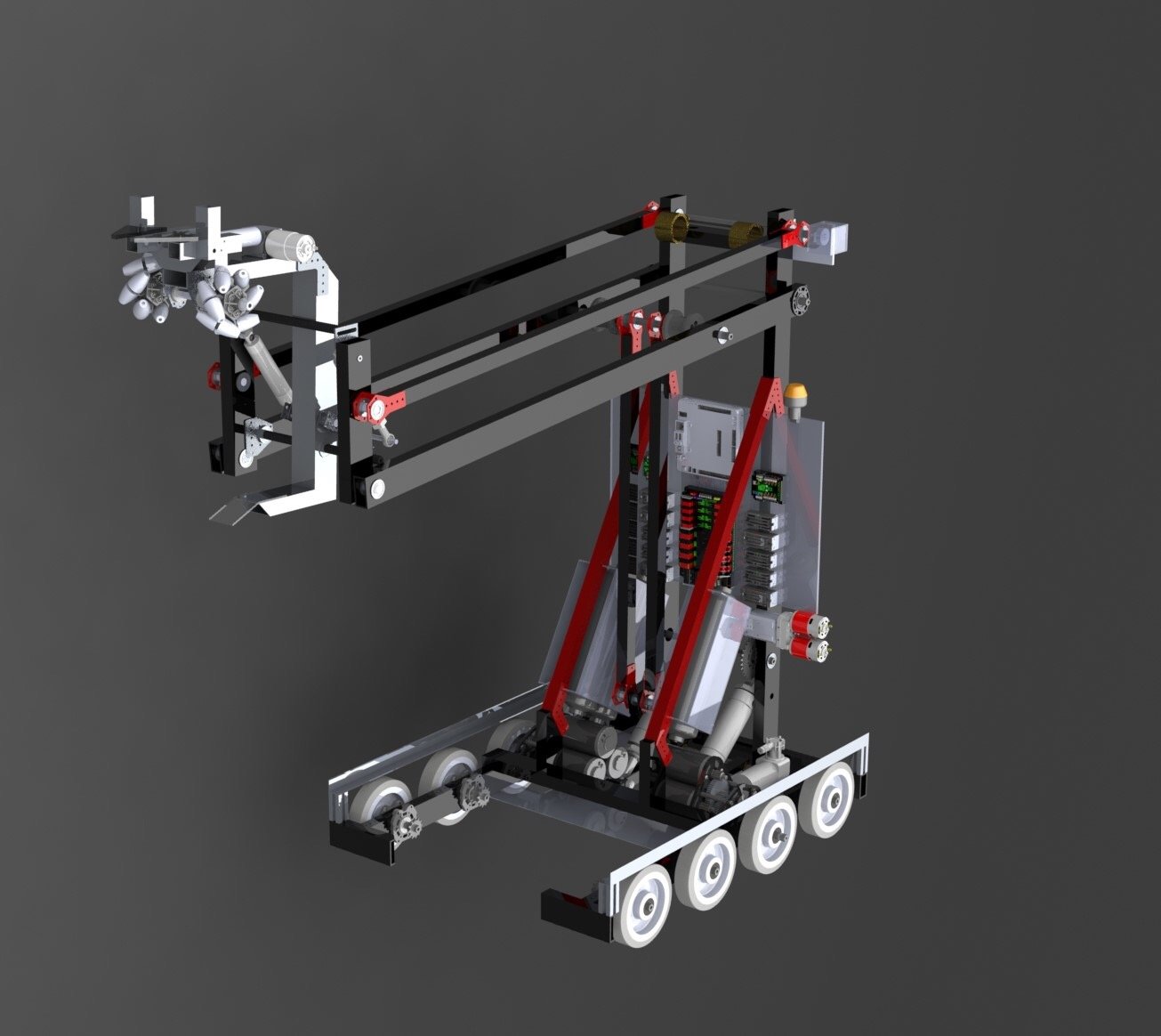

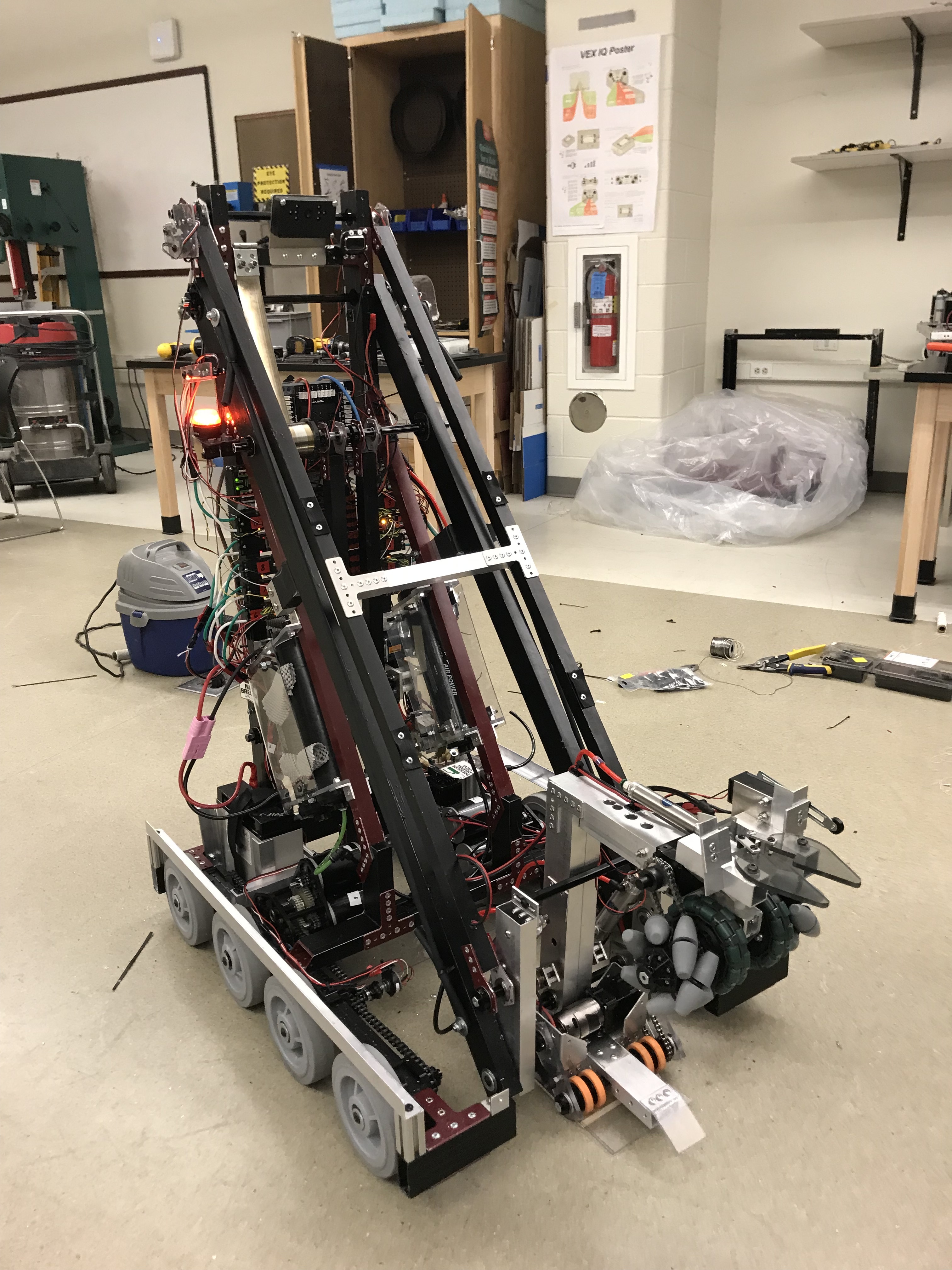

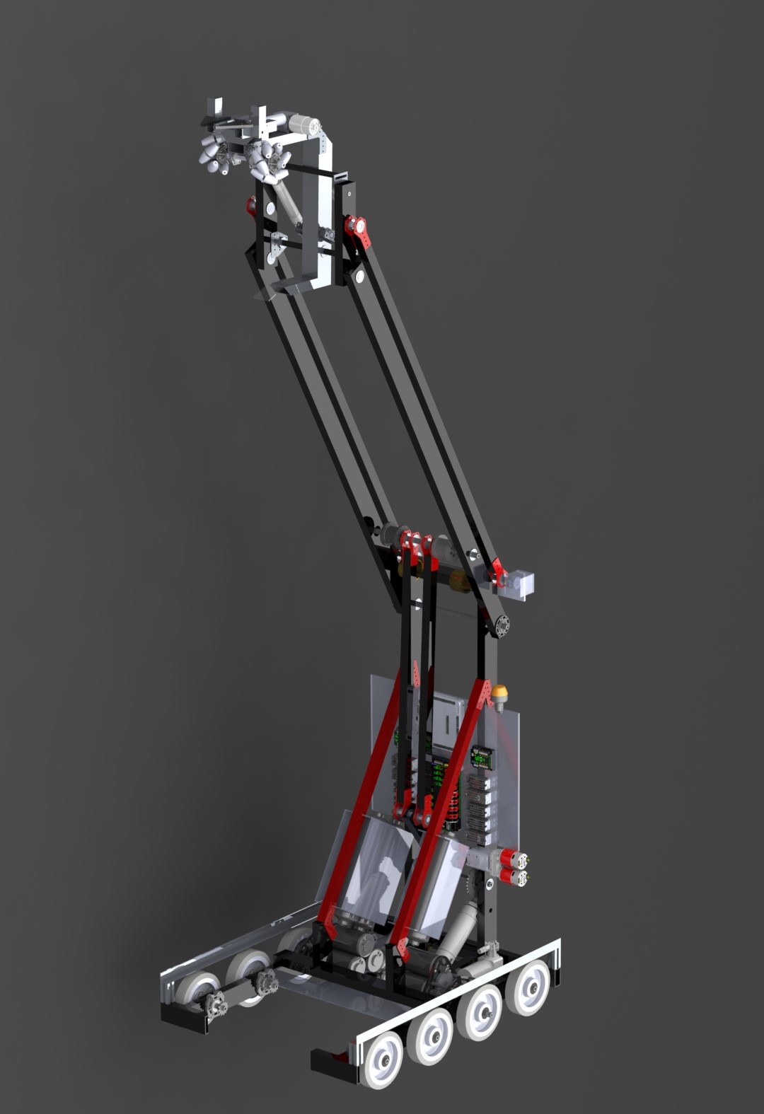

Hoping you dont tip
No tips at our first event. Tipped it once at home due to the arm encoder being read backwards causing the arm to flail upwards rapidly, but that was also without the bumpers mounted or the ballast we added to the front of the frame installed. There will definitely be some increased risk of tipping as we start playing with the top level of the rocket more, but I’m not terribly concerned. The arm is almost entirely 1/16" wall tubing and surprisingly light.
heh…tipping wasn’t an issue.
Colson Wheel size?
6" Diameter and 1.5" thick
Ok, that is what we would like to have. Where did you get the 6" ?
McMaster
