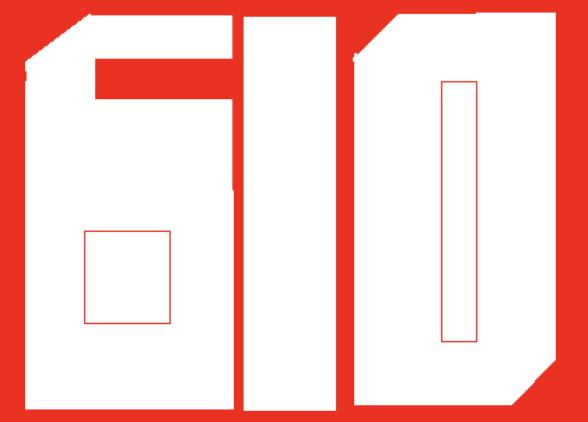

I proposed a solution of painting in our numbers with white paint and drawing outlines as per this image. This was a problem we were told because the “extra white” stuff is now not part of the number, and that it would violate additional condition C. We had to colour in the white boxes inside the ‘6’ and ‘0’ with red/blue colour.
C. may not substitute logos or icons for numerals.

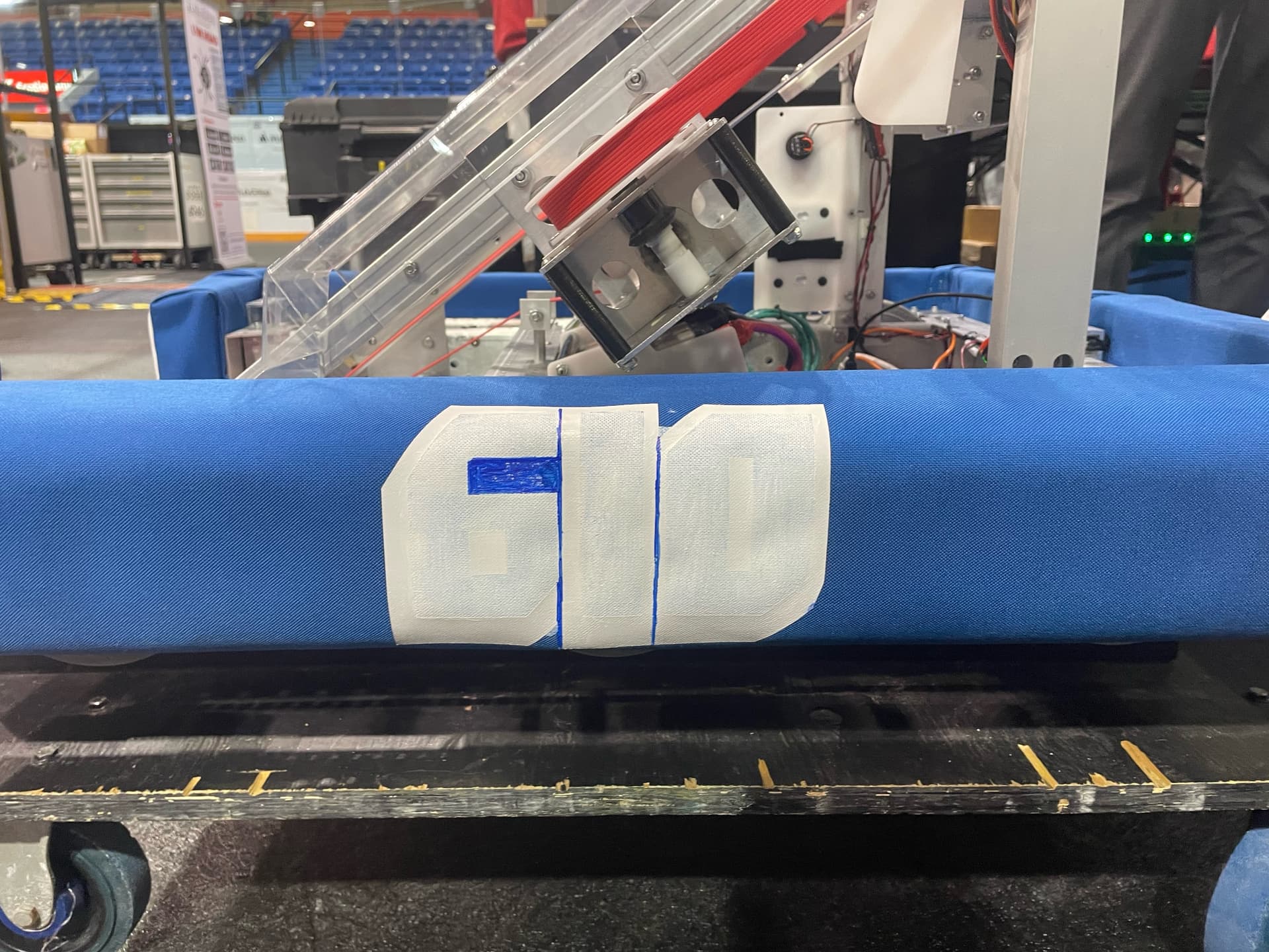

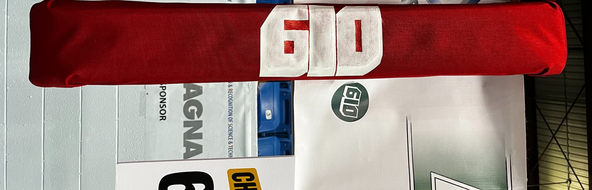

I will include images of my bumpers after 2 fixes. Neither of these photos are in violation of the rules. BOTH of these are less clearly visible and unambiguous.
Before anyone points out the obvious, I will admit I missed this in the rules and thats on me. So we comply with the rules now but less the intent of it.

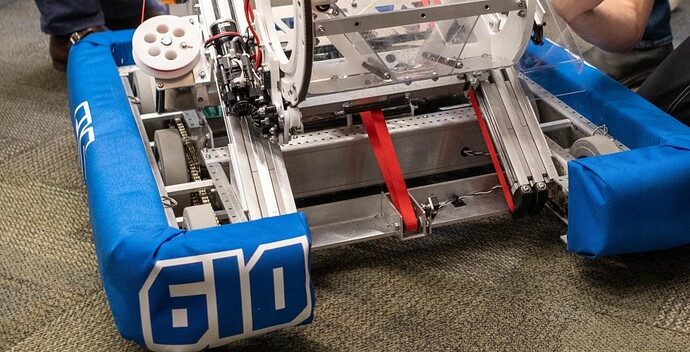

The bumpers we came into the event with I did not photograph, but please look up Team 610 and you will find several examples of our numbers. Contrary to common belief our “logo” is actually just our team number in a very specific font but with a maple leaf. This is why we are not in violation of condition B.
Original bumpers we walked into the event with
