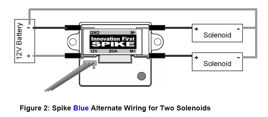

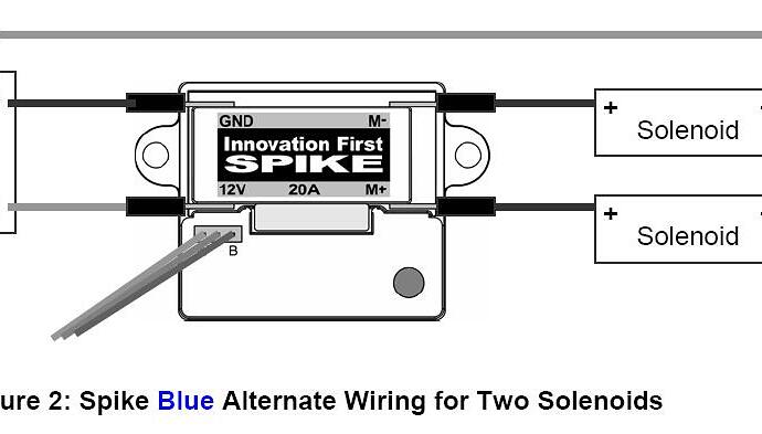

I see what your saying. So the intent of the rule was to make sure that each motor, solenoid, etc was connected to the appropriate control apparatus.
Specifically, I was thinking of using a single spike to drive two single action solenoids (such as the Festo) as shown in the attached picture. This is from the spike manual. However, a post on the Q&A forum disallows this type of usage, hence the confusion.
EDIT: It appears that the question I am referring to has been removed from the Q&A forum.
This configuration of a single pike controlling two solenoids was an allowed wiring configuration in [possibily distant] past seasons. Keep an eye out for the QandA item. Answers in the QandA are subject to change.
Eugene
By the way, when talking about solenoid VALVES, it is probably best to call it a solenoid valve rather than just a solenoid. This will help reduce confusion about just what you are refering to. There are other sorts of solenoid actuators that are specifically prohibited, or at least have been in the past.
We wouldn’t want the freshman and rookies to get confused about what is allowed and what is not.
ChrisH
This has been addressed: http://forums.usfirst.org/showthread.php?t=1292
