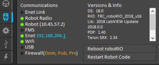

We’ve had the same issue. I’ve attached a screenshot of our DS. We can also ping the roborio and connect to the web dashboard. However, when we deploy code, it gives the error in the second screenshot below.
the firewall signal it’s not green, I think you have a firewall issue and I think you must enable mDNS on your computer.
Try to get The driverStation an access trough the firewall.
So I noticed my firewall light was also not green and I did disable the windows firewall and defender. I also allowed the driver station ports through in the windows firewall center.
I also noticed sometimes right before the driverstation disconnects the battery voltage graph will stop and then “catch up with itself” quickly before it disconnects. I have no clue on that one…
The text next the firewall light says “Firewall(Dom)” am I missing a setting?
Note that there are actually 3 levels of Firewall to disable on Windows 10 (and also Windows 8). “Dom” refers to the Domain profile which is hidden in the advanced settings. If you look at this post from last year, there are screen shots and some description of what the settings are: https://www.chiefdelphi.com/forums/s…9&postcount=13
Ok I got the firewall light to be green however, we are still having issues where the driver station seems to lag behind and then disconnect. Like in my previous post where the battery indicator will lag behind and then catch up after it disconnects
