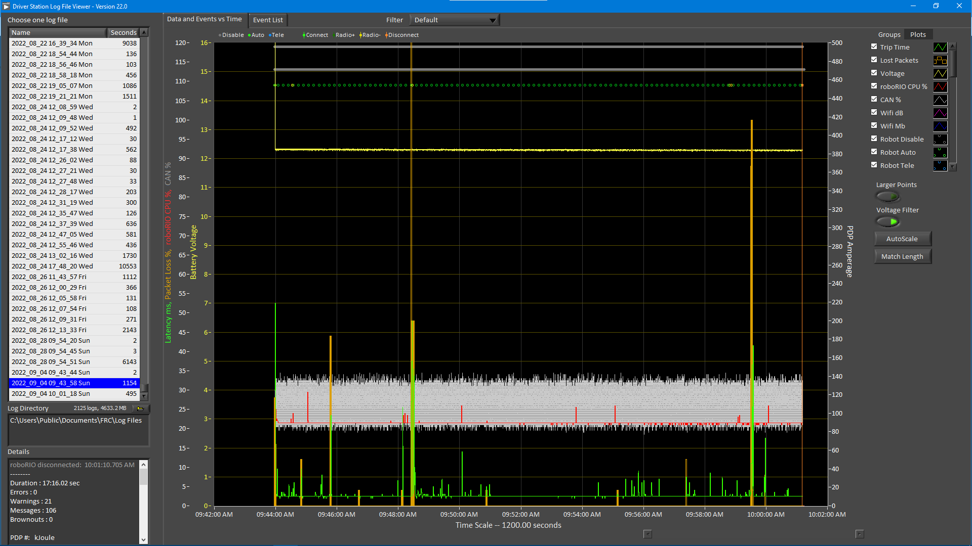

Here is the DS log. l don’t know whether it is the one you want.
Not sure why your legend at the top is distorted - it does make it harder for you to interpret. My screen looks like this
Your CAN utilization looks too high but I vaguely remember someone posting that there is a bug in those data collection and maybe it isn’t really that high. Maybe someone can advise you on that. Is it bad data collection or should you cut back on how fast you get CAN data updates (status frame info)?
Your roboRIO is working hard; I presume you have a roboRIO original version and not the 2.0 which has a much faster CPU. Are you getting the 0.02 second iteration overrun messages?
Your voltage looks good. You must have something running periodically (you cut off the scale at the bottom so I can’t tell how fast) but it all seems reasonable.
Your packet loss is better than mine and I’m not even using Wi-Fi and I’m running almost nothing to just make this screen print (of course I can’t tell if you are or not but I presume you are).
I pulled out my Ethernet cable to disconnect and got my vertical marker at the last time and it does match your disconnect at the last time so I believe you disconnected.
Now that I think about it it might have been this CAN utilization that is bogus sometimes and not the graph
This is very helpful – thanks! You choose the log using the list on the left. I assume the specific log you have selected is one that shows the problem you are trying to troubleshoot. If not, please post the right log. You can also upload the log file so that we can look at the logs interactively, this can be very helpful.
See the yellow bars at the bottom (packet loss %) and the thin yellow line that runs closer to the top (Battery voltage)? Also the grey/white line that’s jumping around quite a bit – that’s CAN. But there should be a white line as well, it’s hard to pick out in the sceenshot (PDP Amperage)? Also, there’s a time index at the bottom (below where you cut the image). The idea is to correlate this data, using the time code and other clues in the log, with occurrences of the problem. Then, you can zoom in to these time ranges and see what’s going on with the control system (if you have zoomed out and there’s a long range of time being shown, it can be hard to read the graphs).

How long is the period of radio disconnect? You’ve clipped the X axis on this screenshot.
What does the event log say in the region of the disconnection event?
