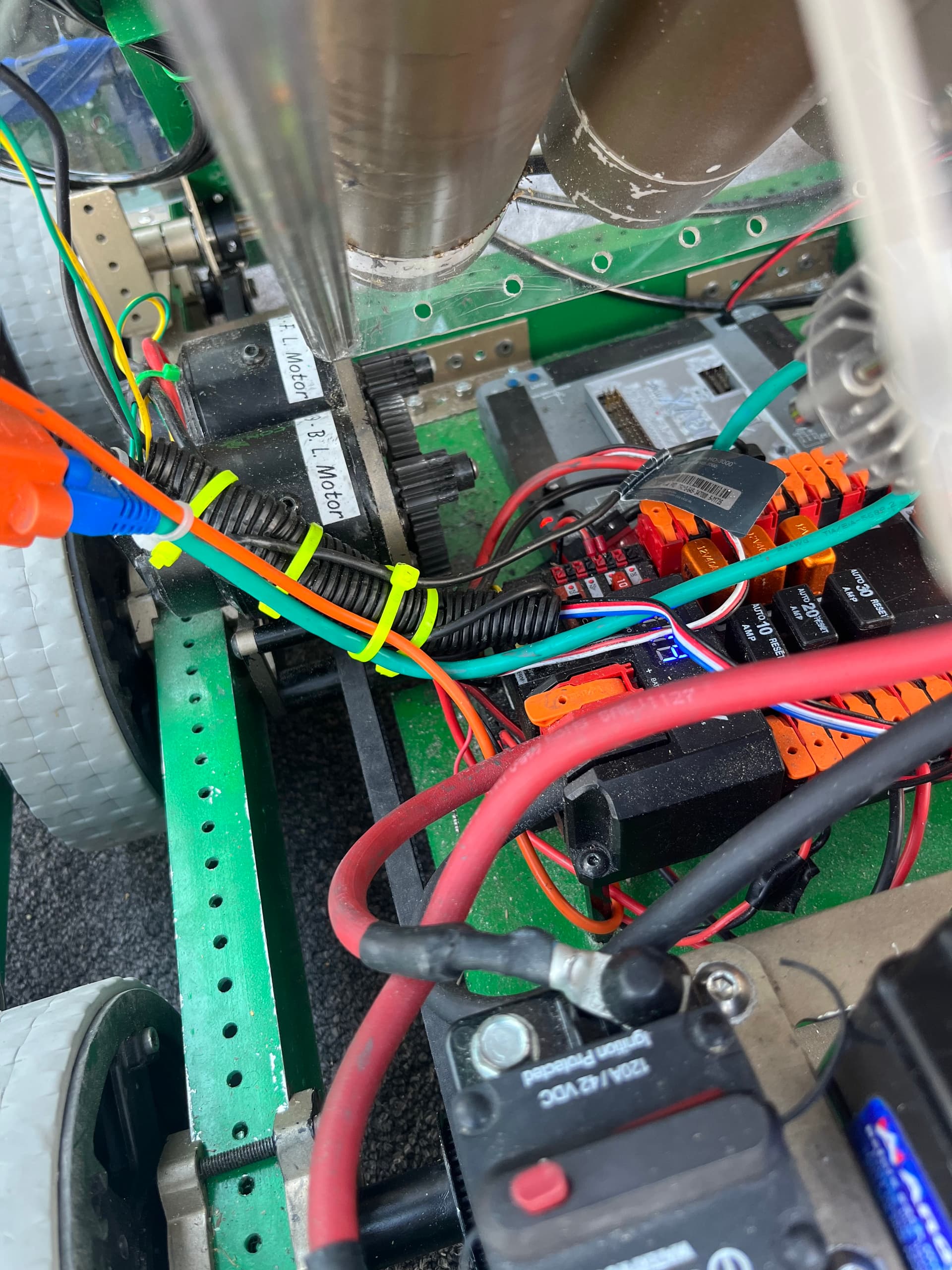

Gears are skipping in the WCP flipped gearbox attached to two Falcon 500s. We have motor ramping done by Phoenix slew rate (configOpenLoopRamp). We replaced the belts on the right side and nothing works. Before, the ramping was 0.6 along with brake mode. Now if we set the ramping below 1.5 it’s instant brake. We replaced the whole gearbox and it still skips the gears.

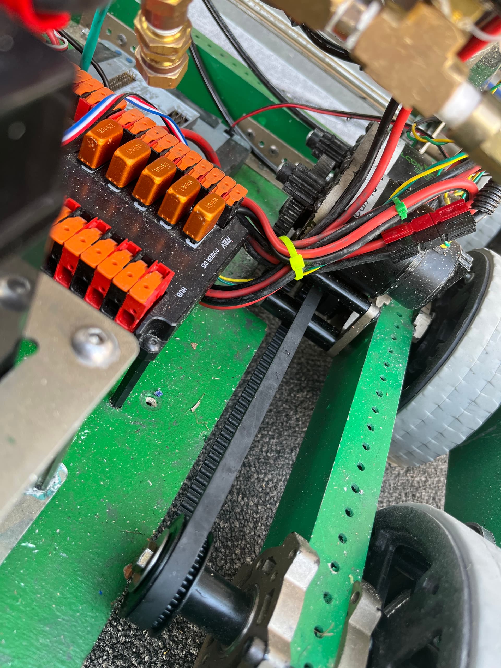

Picture of the right side:
Picture of the left side (this side works partly):

Everything worked before we replaced the belts on the right side. If we change the direction too quickly the gears skip (both sides). This problem also didn’t happen before. Thank you for taking your time reading this.

Is it the pulley skipping or the gears? If it is the pulley I would recommend switching to 35 chain
Well your gears look like they’re in decent shape, so if those are skipping I’d look at the gear spacing. If f those are COTS gearboxes double check you are using the right gears, if they’re custom double check your spacing are gears.
If there’s any chance it is something else that sounds or looks like gear skipping, check for belt skipping and consider a chain (we use #25 without issue), go through the whole drivetrain step by step looking for wear.
If those are 9 mm wide belts they may not be adequate for a west coast drive application. 15 mm wide will work, but I have heard people have issues with 9.

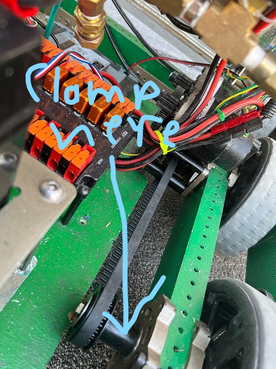

I still recommend switching to chain, but to get the belt working you could loosen the 10-32s in the bearing block, put a clamp on the axle, and on the frame perimeter, and tighten it. Put all 4 10-32s in the bearing block so it does not shift. Make sure the 10-32s are very tight. Also are there lock nuts on the bolt? I cannot tell from the picture.
Those pulleys are way too small for those wheels, especially with 9mm belts.
Update: swapped to chain and works really good, thank you!
