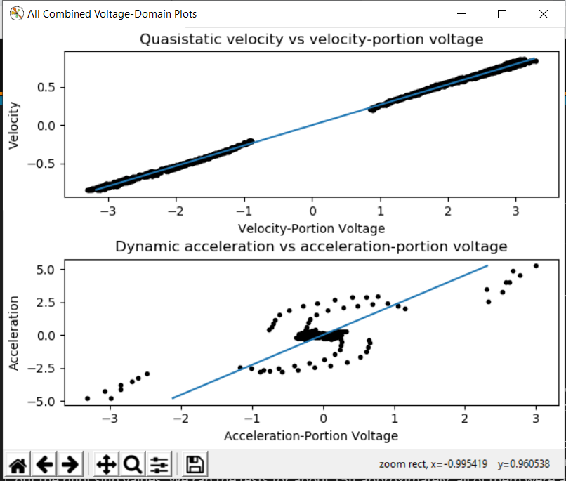

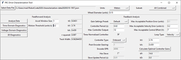

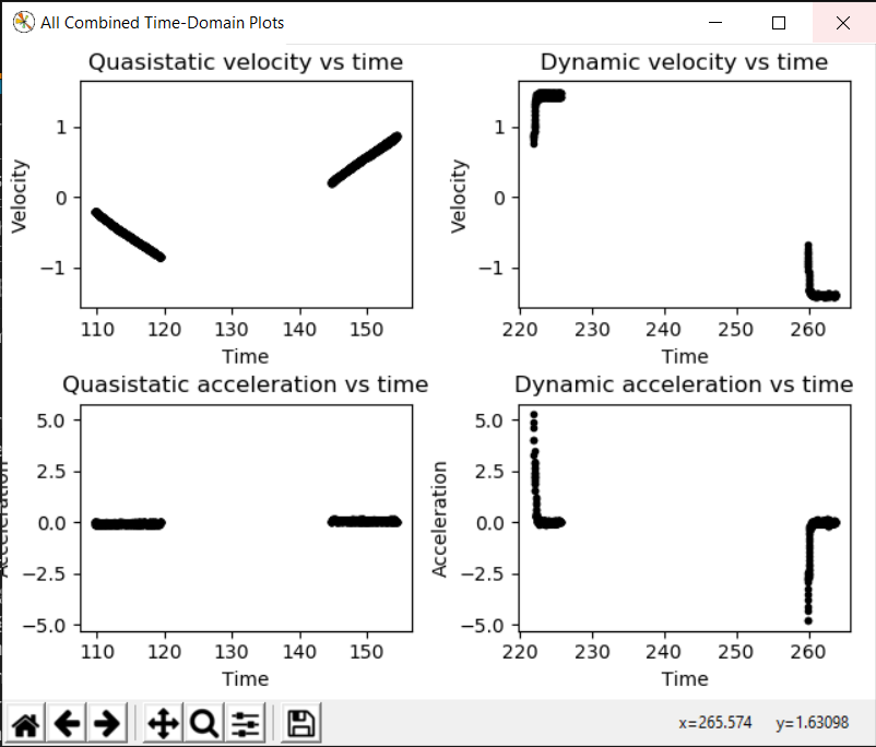

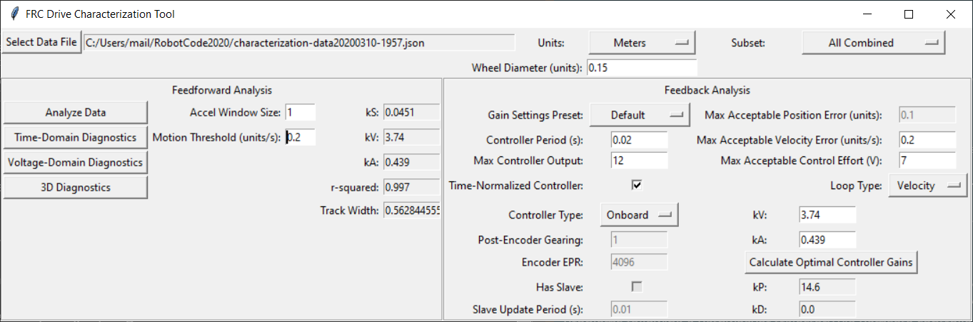

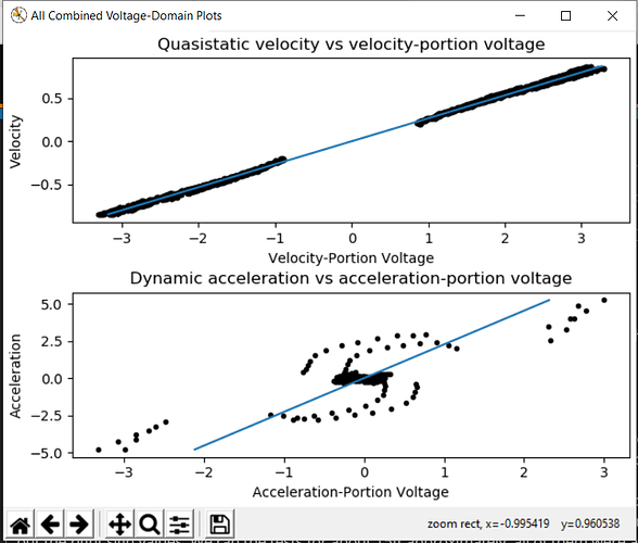

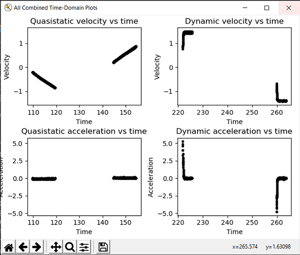

Our characterization graphs can be seen below, they seem off but we are not sure what we did wrong when characterizing our drivetrain. We have two Falcons per side and a NavX, and our config file can be seen here. We had to manually switch the negative in the generated code to get the flipped encoder to work with the Falcons, but when we ran the tests the encoders read out the right sign values. We ran the tests for about 15ft approximately, all of them were at least 10 and the readings for distance it gave us seemed about right. The NavX has been tested and gives us the correct heading with positive values when turning counterclockwise to 180 and negative to -180 when turning clockwise. The EPR was found by spinning the wheel one full rotation and measuring encoder ticks. We were not able to manage to convert the ticks through our gearbox for some reason, I guess we aren’t great at dimensional analysis, but it seemed to be a very close approximation.
