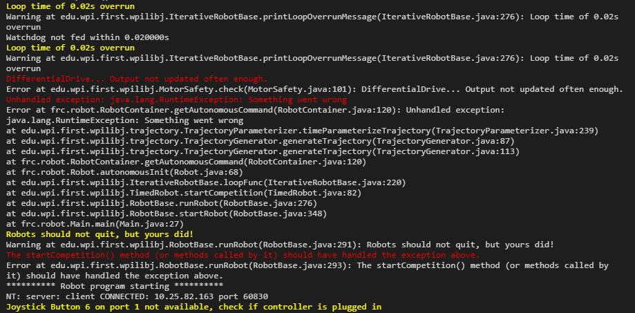

I am trying to learn how to use and modify the ramsete example code to create custom trajectories.
I seem to be able to run the code without issue if my start end end rotation is zero or very small 45 degrees or less. It seems that if I try to make larger turns when I try to run the code I get an error that kills my robot code.
The following is the error that appears in the log.
It acts like the error is with motor safety, but it doesn’t show up when I have paths that start and end with 0 rotation.
This works fine.

But if I change the trajectory to this it will crash.
        Rotation2d startRot = new Rotation2d(0);
        Rotation2d endRot = Rotation2d.fromDegrees(90);//positive turns left
Any help would be appreciated.

What version of wpilib are you running? There was a bug causing this that was fixed in the most recent update.
Is it possible that you are actually getting a Malformed Spline Exception that is later causing the motor watchdog to not be fed? I see that you only have 0.5 units between the start waypoint and end waypoint (though you say that is 3 meters?) and it is possible that the trajectory generator is very unhappy drawing such a short spline that also has to turn sharply.
This seems to have cured the major issues I was having. Now I am curious how people are determining the points for the splines? Is there an a good program? Do people just pull up the game field in cad and measure various points? Is it all just test and see what happens?
