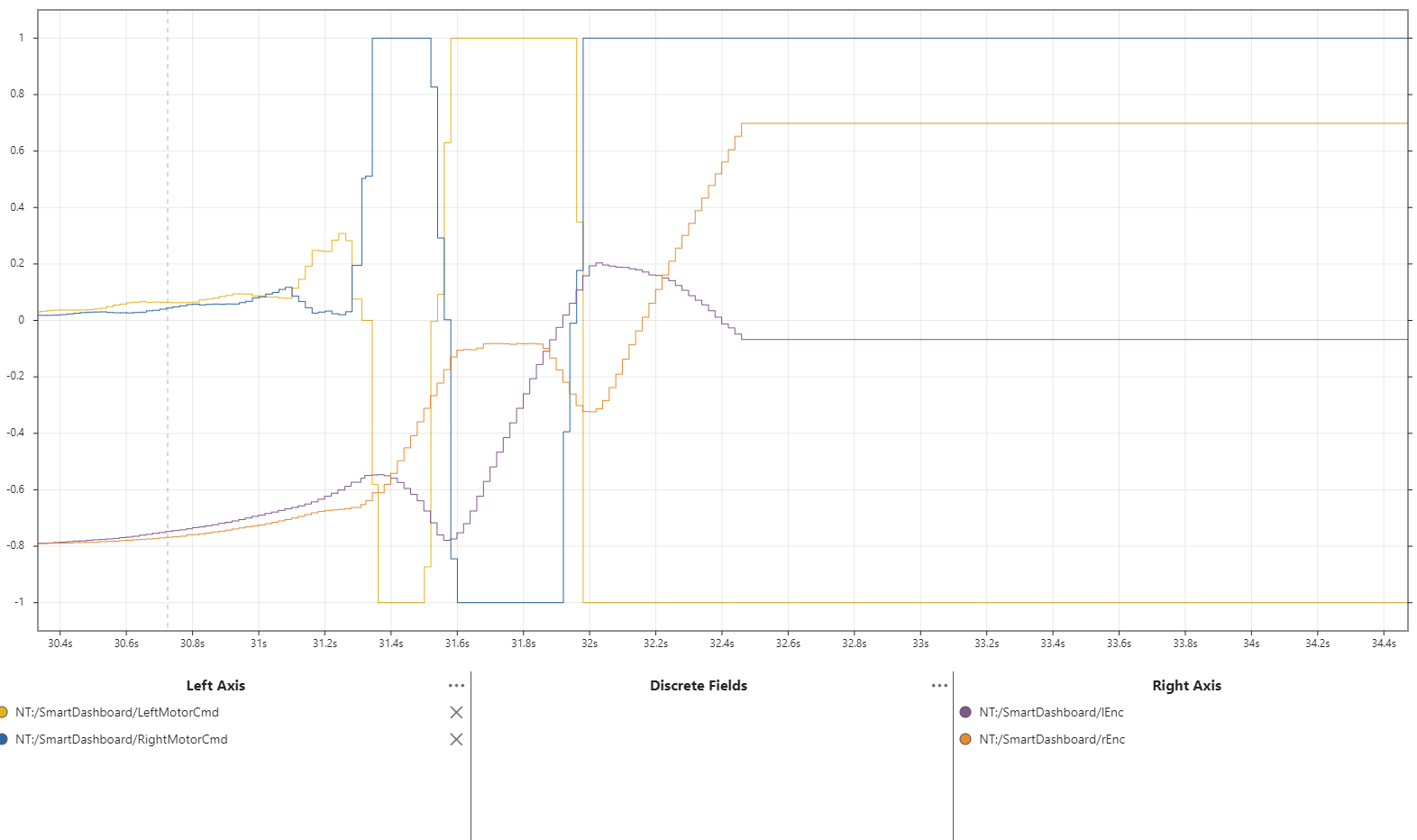

I have a simple trajectory that drives straight and stops. When I run the autonomous mode, the robot starts to drive forward and then freaks out and the motors oscillate between full speed forward and full speed in reverse. I put the log file here:
The image below shows the start of the autonomous mode. The left/right motor command starts to increase, the left/right encoders show forward movement and then the Ramstete controller decides to command full deflection of the motors in opposite direction. I thought it was something to do with signs, but I’ve inverted the left/right encoder values, pose, everything I could think of, but I still get the same results.

I would agree that it’s likely a problem with the signs. Can you verify (perhaps with the robot on blocks) that a positive voltage (sent to DriveSubsystem.move()) makes all the wheels turn forwards and the encoders increase? And positive on one side with negative on the other turns in the expected direction? Does this track with what the field widget is showing from the odometry?
For example, I notice your arcade drive negates both joystick axes. Negating the Y is expected, but negating the X is not. Unexpected negations in arcade drive are, in my experience, often associated with autos that go crazy.

So you know that orbiter NASA sent to Mars where one group was using Metric and the other group was using Imperial units… I should have learned an important lesson from that. My chassis wheel base was set to 26.5 METERS. The chassis is 26.5 inches. Once I converted that everything worked almost ok.
Our robot has a tendency to pull to one side. But at least I can get it to follow a path.
