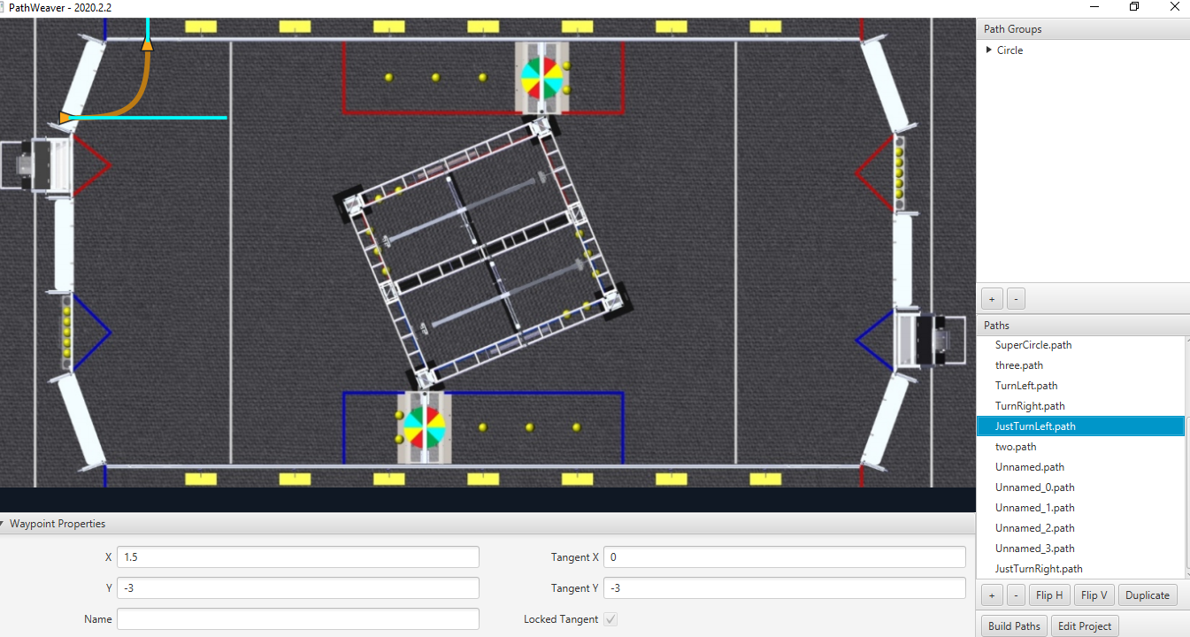

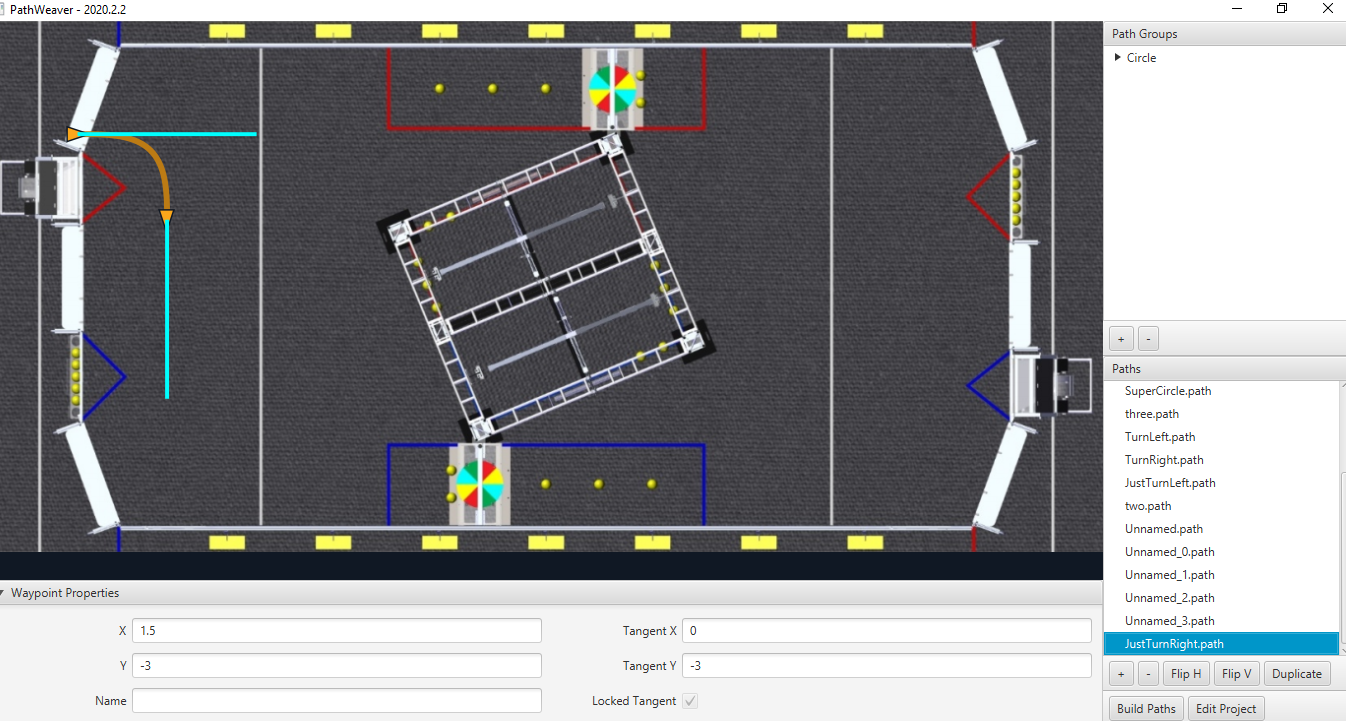

Hi, I have been trying to get RamseteCommand to work using WPI’s example code and their documentation. My robot I’m testing with is a KOP chassis with 4 NEOs and 4 CAN Spark maxes and an ADXRS450 gyro. I have pretty much just pasted in WPI’s code, just modified encoders and motors to use CANSparkMaxes and CANEncoders, which outputs position/velocity in meters like expected. I published the project to GitHub here. (The project is in Java)
I have two paths: one turning right (going 1.5m forward and 1.5m right) and one turning left( going 1.5m forward and 1.5m left). Turning right works fine, but when I run the turning left path, it first turns right then tries to turn left (which is not what I want). I’v attached an images of the generated paths and videos of them driving:

You might take a look at this troubleshooting tutorial that I recently added to frc-docs. The behavior you’re seeing and the fact that your code looks (after a quick read) pretty much fine indicates that this might be a tuning issue. If you don’t go through the entire troubleshooting guide then you should at least check that your wheel P controllers are tracking well (I’m on mobile right now so I can’t see if you already have that data in your Shuffleboard recordings).
Sorry I haven’t posted this earlier, but I found out the problem. I was not setting my initial odometry position to the intitial position of the command. On the TurnRight program, it started at (0,0) just like the robot and so it worked fine anyways, but the TurnLeft program didn’t, and so it tried to get back on course (that’s why it moved to the right). I fixed it by adding this in the command:
m_robotDrive.resetOdometry(jsonTrajectory.getInitialPose());
