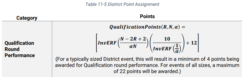

Ok yeah, if your district points aren’t changing, what @MikLast said, active teams’ points are adjusting as the R in this equation is changing:
If your points themselves are changing while you’re not competing, that pretty much has to be an administrative adjustment.
