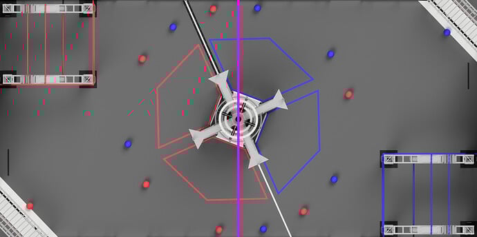

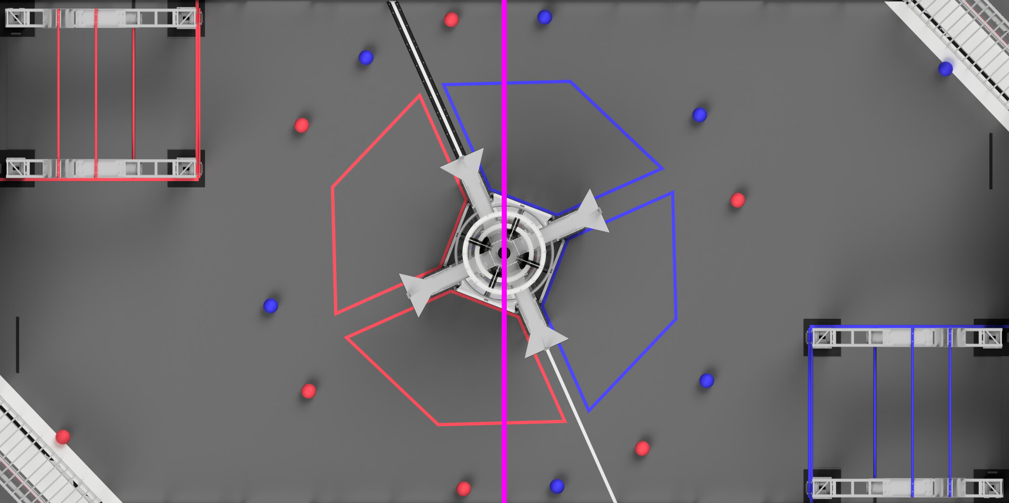

Rapid React is blue alliance favored, and here's why:
The position of cable protector on the field disadvantages the red alliance in two main ways.
First, it makes the ball return exit aligned with it (which is supposed to be a red-favored exit) not as favorable, because half of the balls coming out of that exit end up on the far side of the bump. This introduces extra effort (whether due to difficulty in maneuvering, needing to slow down, or just plain annoyance) in retrieving balls that should have been easy to get.
Second, many teams prefer not to score near the cable protector due to issues with turning or bumpiness that can affect shot consistency. The cable protector creates a dead zone for shooting that extends solely into red’s half of the field (indicated by the magenta line), giving the red alliance less area of accessible field space for scoring than the blue alliance.
These issues seem minor but may have a large impact at the highest levels of play when ball accessibility/starvation and defense matter a lot. Personally, my team has found playing the left side of the field on the red alliance to feel really cramped, and there’s not a lot of room to maneuver and get clean shots off.
What are your thoughts? Is this why 14/18 matches on Einstein were won by the blue alliance? Should FIRST have put a dummy cable protector on the opposite side of the field?

Yes. Fields should be as symmetrical as possible.

Wow that is a really interesting thing that I have never thought of that first should really take into consideration next year
I was like pretty sure they did until I saw the field for the first time. It seems like it goes without saying. iirc 2019 had a symmetrical cable bump?
If it has to favor one side, better to favor blue for elims purposes imo. Of course agreed better to not have a field that favors either side.

We played (3) Elimination Brackets on the Red Side of the Field and generally avoided the Left Alley whenever possible, especially earlier in the season.
Whether or not this artificially biases the entire game dynamic is hard to say, since the inverse point is also true when looking from a Blue Alliance Perspective.
When playing as the Blue Alliance, it is especially difficult to play in front of the Red Hangar, since the field is physically tighter there and it’s much, much easier to find yourself either beached, or at least moving in a non-intended fashion due to the cable protector. Knowing all that we know now about how easy it is to accidentally award a Traverse Climb to a non-traverse robot, this could be more detrimental in the long run.
If anything, the cable protector could be a net wash. Sure, it makes playing offense in that specific area problematic for red, but it should also make playing defense and/or retrieving balls from the Red Tarmac and Hangar equally problematic for blue?
This is an interesting point. My team’s programmers have been able to make a 3 ball auto for when we are on the blue alliance. It is a standard 2 ball with a path that picks up a ball on the red side of the field using flappers on our intake to suck the ball in. With this, we would not be touching it where it was initially placed. While we never got to use this because of connectivity issues (a wire coming loose), we got it approved by a head ref at worlds. This would have allowed for a 42-point auto when we were on the blue alliance, but the cable protector makes it, if not impossible, very hard to do when on the red alliance.
