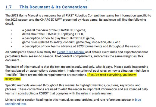

Great to see the question asked! Keep in mind if something comes into question at inspection time, it’ll just be you and the inspectors there, no one from CD.
While it’s good to double check things, if you’re looking to make a key design decision, I’d definitely recommend making sure you are confident a choice is legal through a thorough search of the game manual. If you can’t find anything, you can lean on this:
