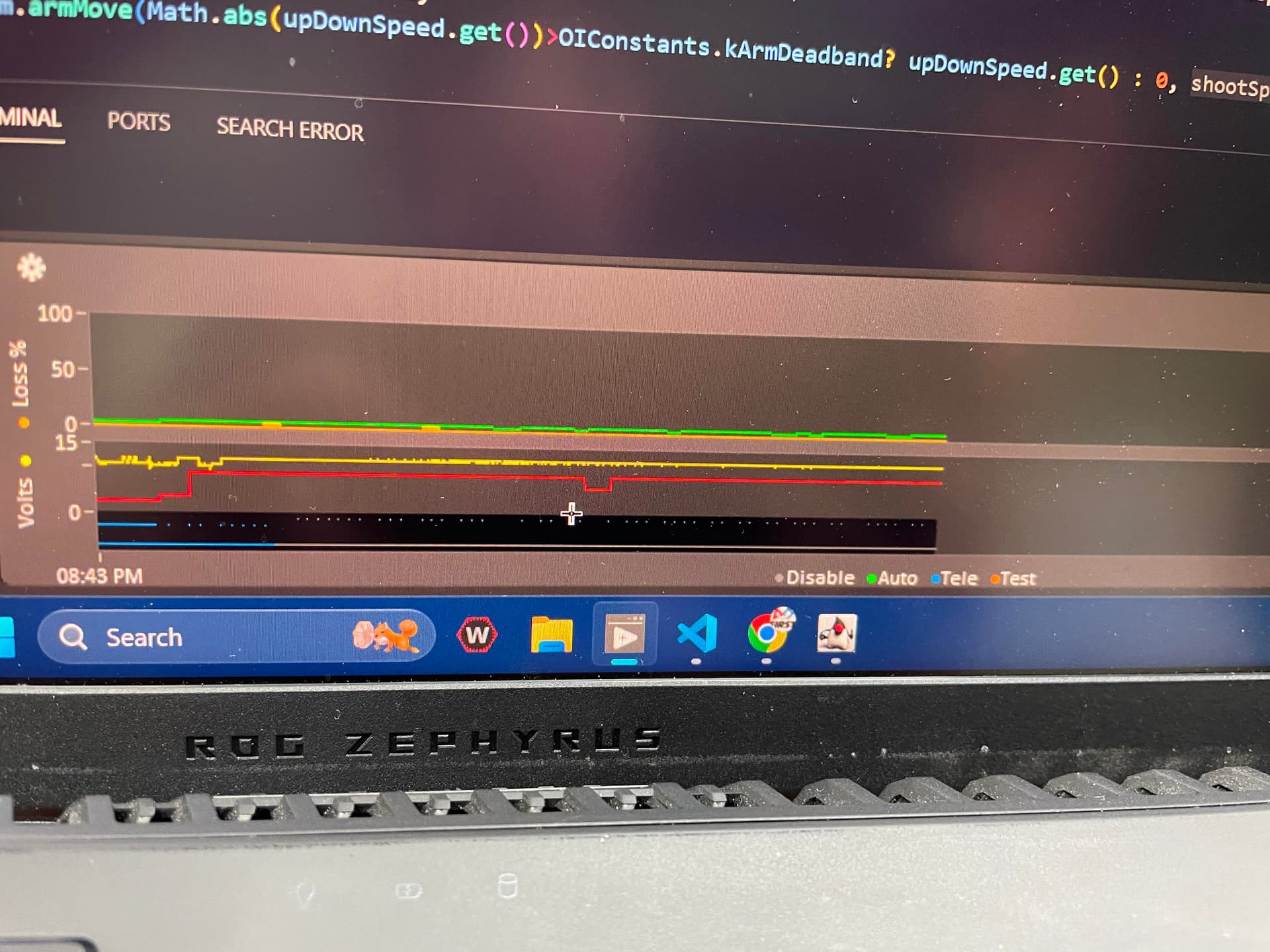

The limelight does the processing for the April tag. But our java code on the roborio does all of the math for the tracking to make our arm and robot move.
During the shoot portion of the tracking, our cpu gets stuck at the top and delays our controller input by about 5 seconds.
If you are just doing some math with the Pose returned from the LL, then there shouldn’t be much CPU usage. The computationally intensive part is the processing of the frames done on the LL. How did you determine the CPU usage was a result of processing the LL data?
